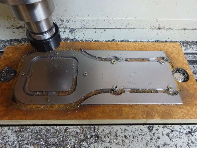

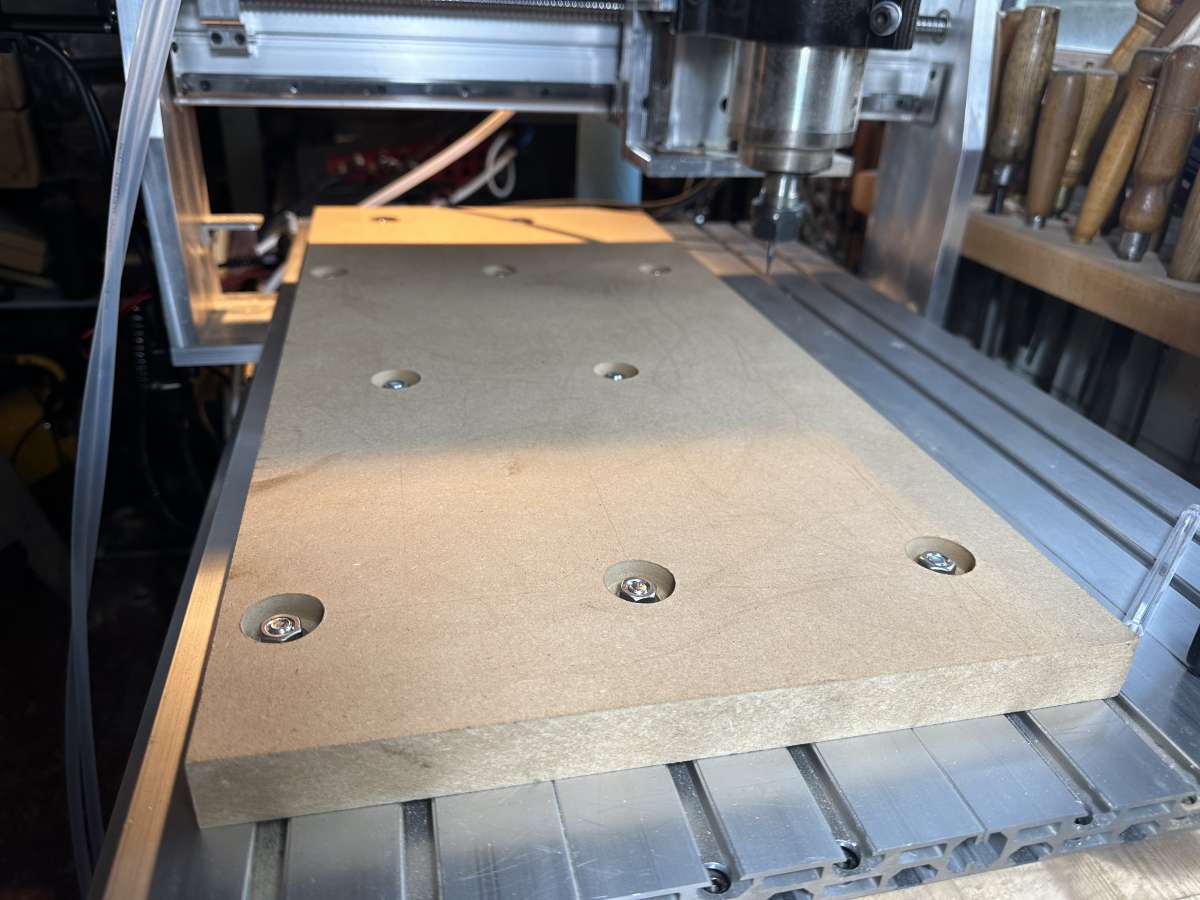

          Unless you ar eengraving a 600x 400 sheet of metal it is usual to flaatten the area that the piece of metal is going to be fixed to before attaching it. For small items you can just hold a piece of MDF in a vice and level that. This was engraved and then drilled just using the tape & glue method to hold it down. I then used the screw holes to add additional clamping while I cut the outer profile. You can see level is reasonably good as I have cut through the part but not the masking tape below.
          20230407_145651
          If a bit bigger then cut a piece of MDF just a bit larger than the item. This shows the heads of the fixings to the bed set below the top so you could again machine it flat first. Part was clamped to that MDF to drill the holes and then they were used for wood screws into the MDF to hold it for profiling.
          DSC03568

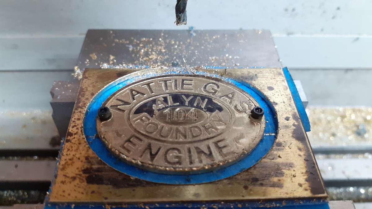

          If the part is reasonably thick compared to it’s thickness then it can be held directly in a vice, the top skimmed flat and then engraved
          20220213_165302
          Your biggest problem is likely to be the lack of head room to get a decent size of vice into place but you should not need much Z axis height above the work for engraving and the cutters are short.

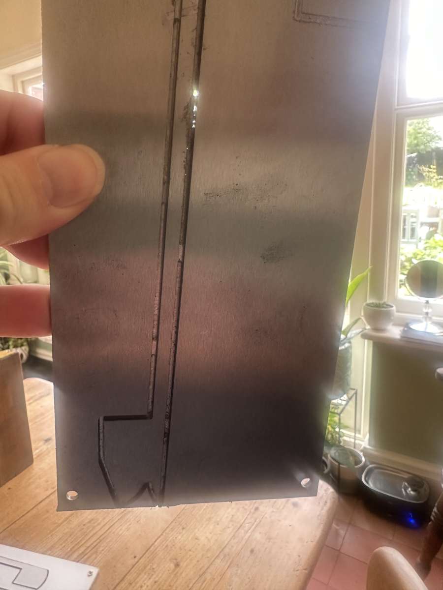

            Let me explain a little more about what I’m trying to achieve. My passion (no idea why) is those old woodworking moulding planes you find at car boot sales. I have made lots of them in my time.
            IMG_4876
            Making the blades from O1 is a really miserable business. I’ve generally cut them out of sheets of O1 with my horizontal mill, but the skinny ones are particularly hard, and profiling the shapes on the end is time consuming. If I could cut them out with CNC I’d be 90% of the way there. Here are a few test cuts from hardboard.
            IMG_4874
            I am aware that there’s potentially a speeds and feeds/lubrication/cooling issue here but that’ll have to be solved as and when I come to it. But that will likely mean that MDF is out as a base medium.

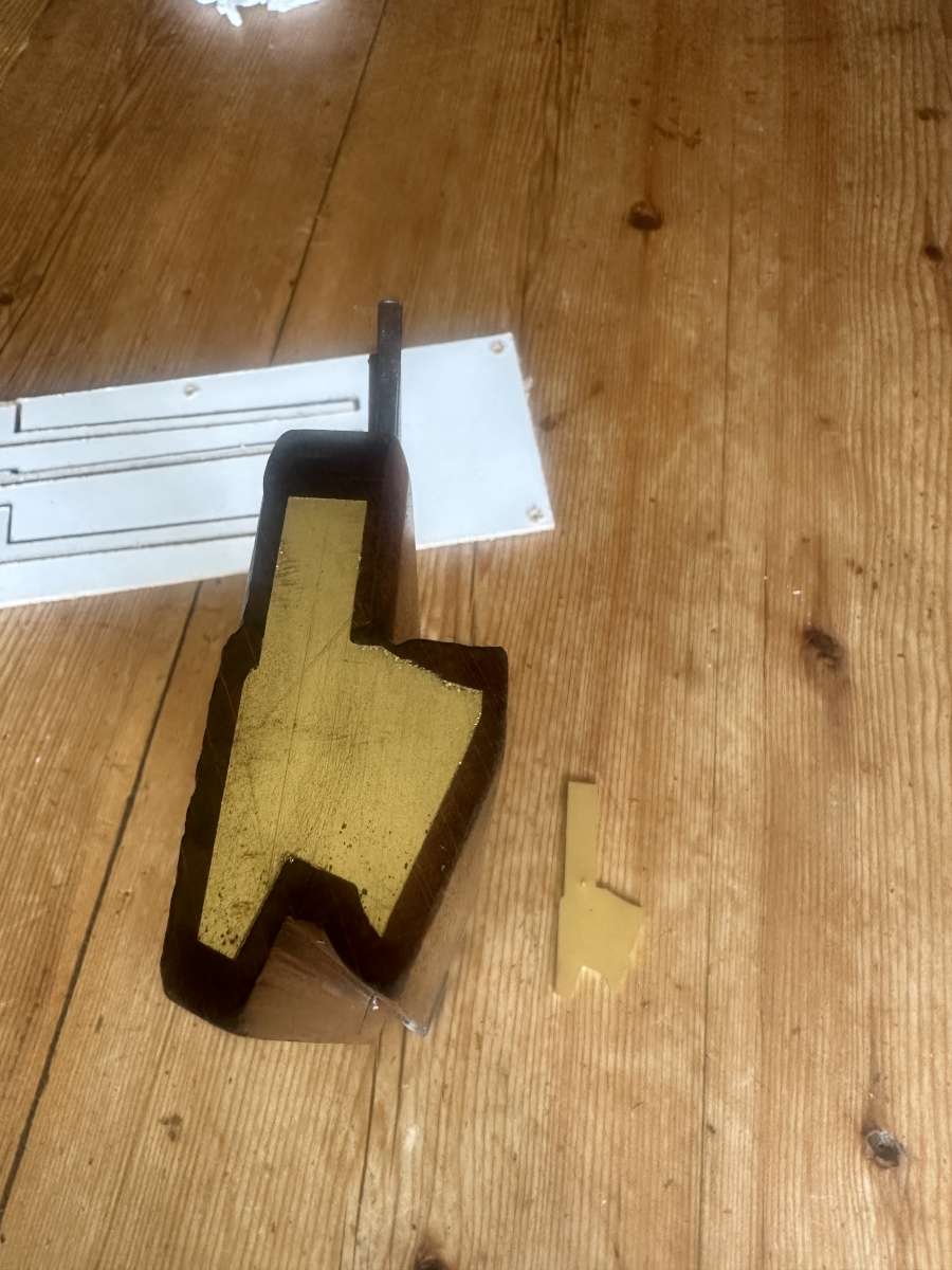

            For my planes to be the coolest I want to make engraved brass end plates for them. See below an example in hardboard. You can imagine a sheet of brass being put in the CNC machine and off it goes creating a whole sheet of these while I do something productive.
            So that’s the initial mission.  For the brass, that probably means a thick, skimmed piece of MDF. For the O1 it may mean a coolant tray and pump!

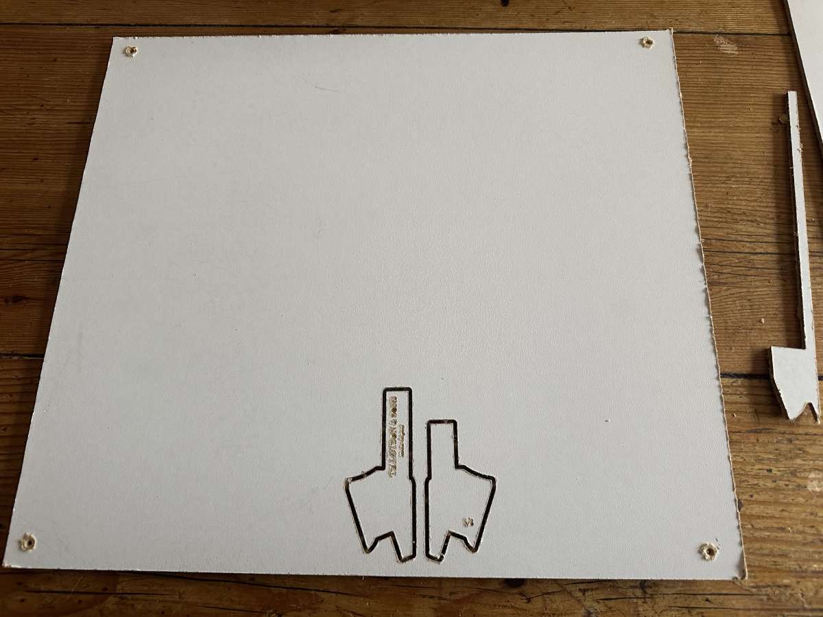

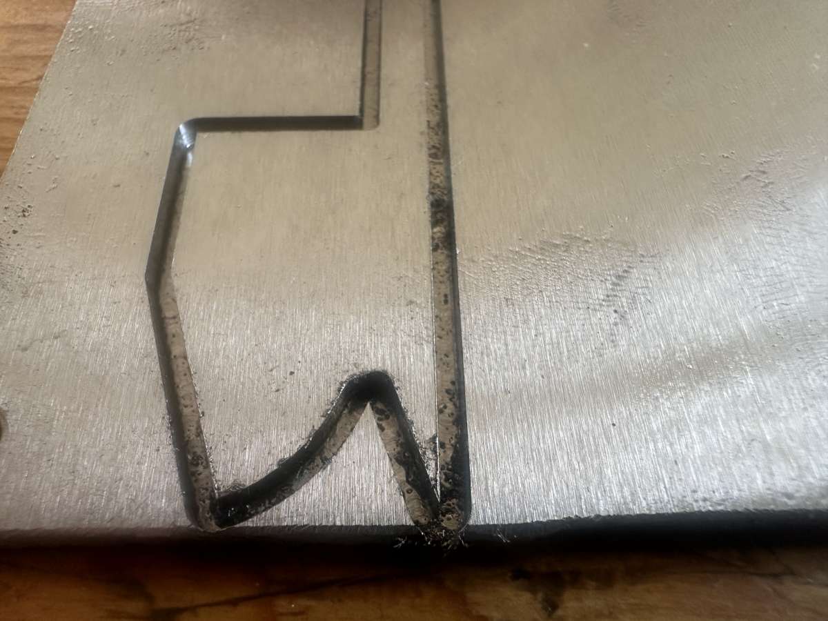

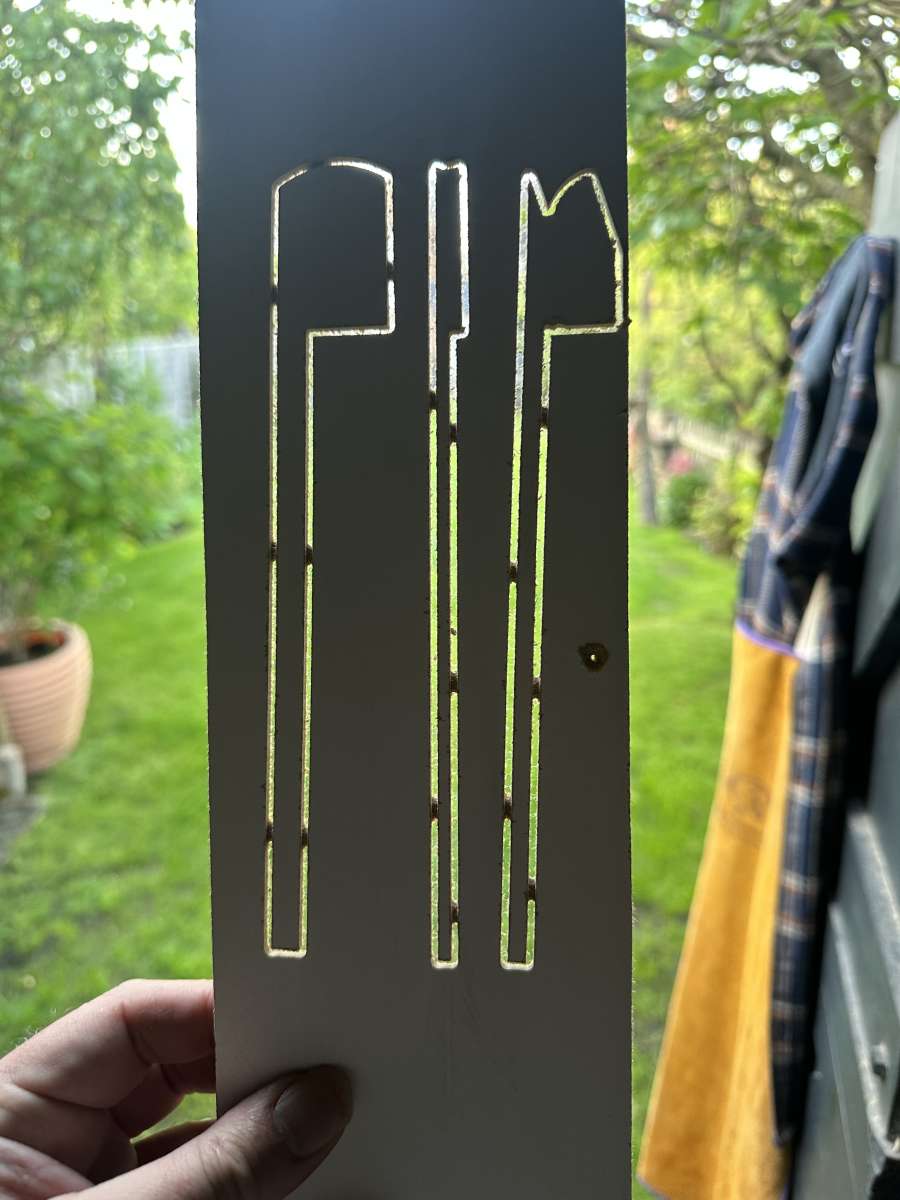

                Well, some success to report even with no mods to the bed.
                Cutting brass was a doddle. Engraving less so, all engraving bits I tried failed. I think I have the wrong type of engraving bit.
                IMG_4883
                I expected cutting O1 to fail pretty much as soon as the cutter hit the metal. But in fact, it was generally fine. It was a 2mm 2 flute, running at 8000 rpm, 9 IPS, 0.005” DOC. it really liked a lot of cutting fluid, and I had to clean out the chips regularly. it didn’t quite bottom out, it needed another 5 thou or so. But light can be seen, so I judge it to be a success. it took about 20 minutes, which is a tiny fraction of the time  it was taking me before. I would really like to get the process so I don’t have to babysit it quite so much. I don’t know if that means flood coolant, but of course that would mean ditching the MDF.
                There was some vibration, but nothing like as much as I expected.
                But overall it is challenging me to consider what really is the best solution for a bed for this machine for these purposes . It’s possible that a thick piece of MDF, or chipboard kitchen worktop, well attached to the existing aluminium bed, might be the best way to go in the short term.
                I do have other operations I want this machine to do though.

                #731466
                  The problem with cutting out contours with such a shallow depth is that you will quickly wear just the tip of the cutter. I would be tempted to try it a bit deeper at around 0.2 to 0.25mm
                  Is that the actual speed you used 9inch per second is extreamly fast or was it 9IPM? somewhere around 200mm/min (8ipm) is the right sort of ball park for such a small dia cutter.
                  If you have a compressor set that up with a fine nozzle to blow the swarf out of the way as recutting swarf soon blunts the cutter and can also make it deflect. Next up from that is to feed a small amount of cutting fluid into the air flow which lubricates the cutter, particularly good with aluminium but not so wet that your MDF will get soggy. Have a google for “fog buster”
                  You can see the small amount of liquid that is on the surface of the work, a lot less than flood cooling.
                  Brass can be done dry but the air will keep any pockets or slots clear of swarf
                  Post some details of what engraving cutters you were using as well as speeds, DOC and feed rate

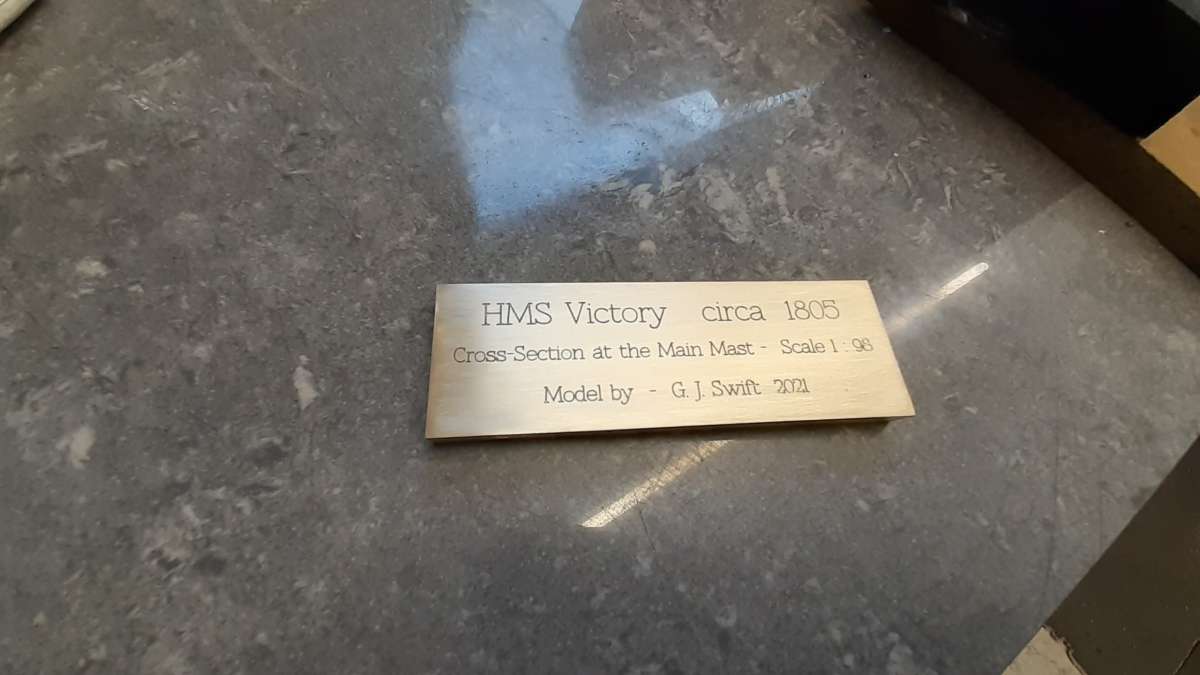

                    On the engraving I don’t really know what I’m doing I’m afraid. I haven’t managed to find much decent advice online. The bits I’ve been using have been 15 degree. I have some 30 degree bits coming tomorrow. I think I ran them at 6ipm , 1400 rpm or thereabouts. The 15 degree bits were much too delicate.
                    One thing I do know is the text is small – typically 3mm high.
                    I am using the FreeCAD v-carve facility. I’m sure people will say “use X” or “use Y” but that probably isn’t practical as I have a huge amount of CAD modelling invested in FreeCAD.
                    Any advice on engraving would be very helpful.

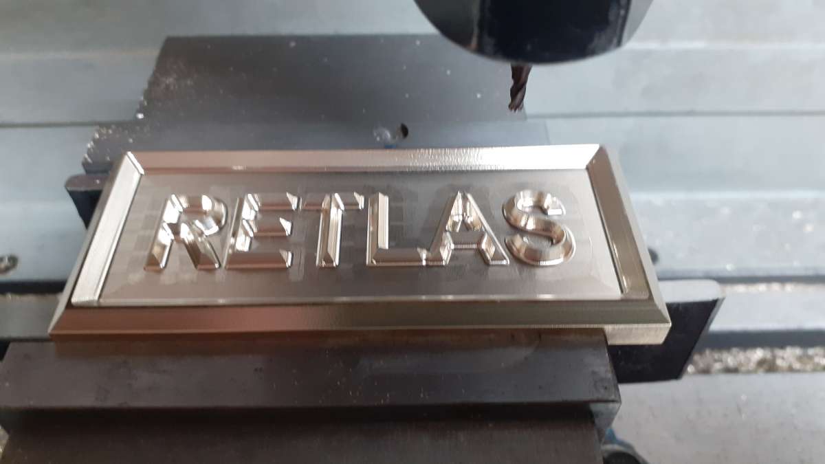

                    #731490
                      As the tip of any Vee shaped engraving tool is a very small diameter you want to be running at as high a speed possible, certainly in brass so your 1400rpm was far too slow. I’m limited to a 5000rpm spindle but would really like to run at closer to 20000rpm for engraving.
                      You also only have one cutting edge which means when working out the fee drate from the chip load and rpm your 6ipm was too fast for the slow spindle speed.
                      I’d be in the region of 0.01mm chip load so at 10,000rpm that would be 100/min or 4ipm. For 20,000rpm a feed of 200mm/min or 8ipm. Your 1400rpm would have worked out at 14mm/min or just over 1/2ipm.
                      This name plate is about 80mm long so same sort of font height as yours (2.5mm and 4mm) done with a 60deg 0.2mm tip cutter at 5000rpm and 50mm/min feed, depth 0.12mm. I design in Alibre and use the free Fusion360 CAM

                        One of your cut-outs in steel has a long straight edge. Why on earth would you not place that along one edge of the material to avoid having to cut it out slowly? Also just mark the other long straight line and hacksaw it.
                          Because this was a test of the capability of the machine and the set up. Indeed I would run it like you say. In fact, a “full set” of these blades has 32 similar cut-outs in it. They’d all be arranged to minimise waste.
                          I’ve cut many of these with a hacksaw and with a horizontal mill. It’s a miserable job. They also have to be very accurate. Doing it on CNC is going to be a blissful experience. Press the go button and have a cup of tea.
                          Actually that’s not the end of the story by any means. They also need tapering in thickness from 1/16” to 1/8” across the length. I usually do that on my old eagle surface grinder. That’s a boring job too.  I feel some CNC motors coming on for that, now I’ve basically worked out how to do CAD/CAM/CNC.
                          #731502
                            Yes the earlier photos show some basic nesting of the three test pieces, and as you say you want to cut from large 600 x 400 sheets I would imagine there will only be a few near the edge and the other side of them won’t allow a hacksaw in due to the proximity of other blades.
                            A lot of CNC work you tend to start with slightly oversize stock and cut all round rather than have to faff about getting one edge spot on and if sheet it is unlikely to have a good machined edge to start with so needs milling anyway.

                                Today I acquired a lump of 1” MDF from the local building suppliers scrap bin, and I’ve bolted it to the existing aluminium bed. This should create a much more rigid and damping surface than the flimsy bed on its own.
                                I have ordered a skimming bit, should arrive tomorrow, then I can flatten the MDF and I’m in a good position to have another go at the engraving, using suitable speeds etc.
