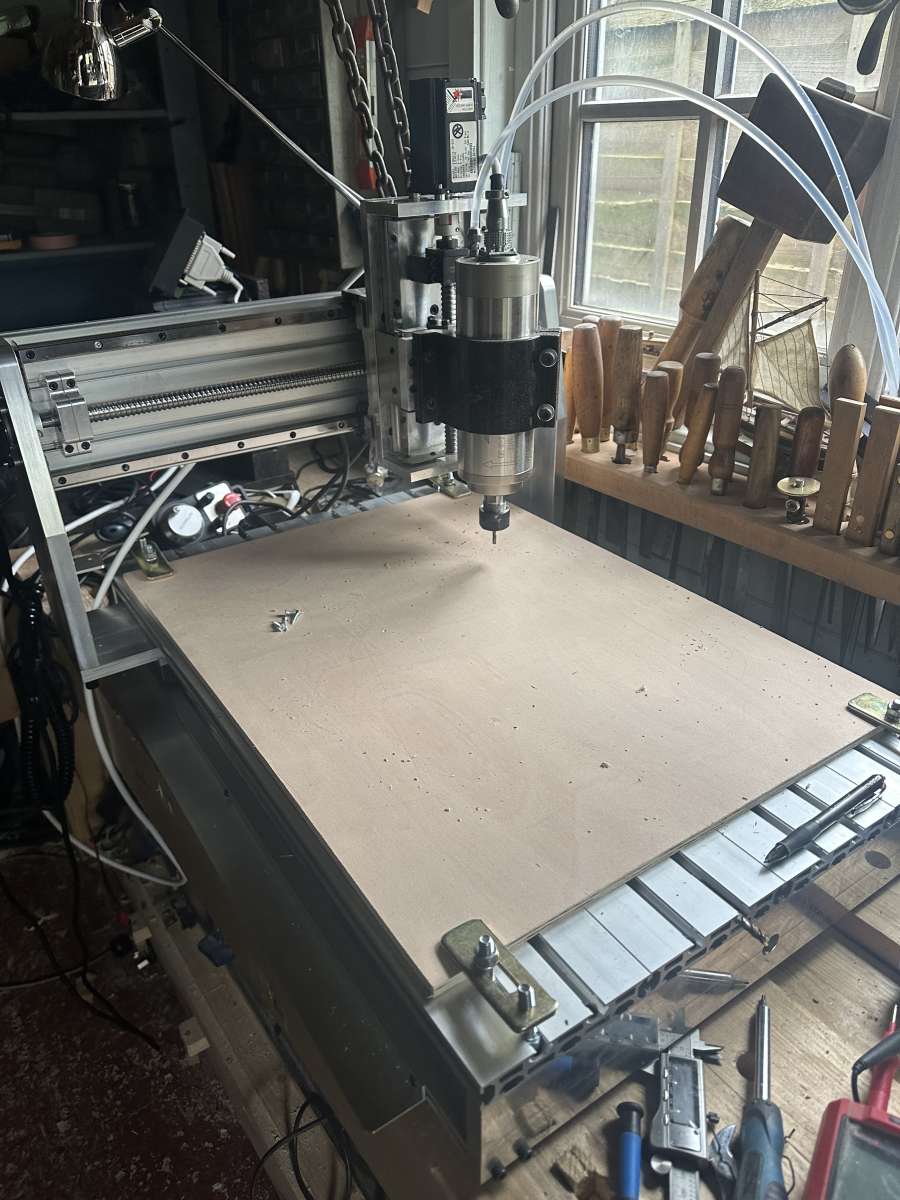

      Hi
      I have recently built myself a 6040 router with bits from Rattm motor. It’s fairly robust, as such things go, with linear rails, ball screws (amazing!) and closed loop motors.
      I want to use it for cutting out shapes from flat brass and O1 tool steel, typically max 3mm thick.
      One of the main mods that people do such machines is to replace the bed. It’s pretty flimsy extruded aluminium at present and will certainly not take any significant metal milling vibration.
      Online I’ve seen people using 15 to 20 mm steel plate, and drilled/laser cut to the correct size with holes for fixtures.
      But (here’s the question) what is the best steel for such an application? Or is there a better approach? does anybody have any experience of doing this?

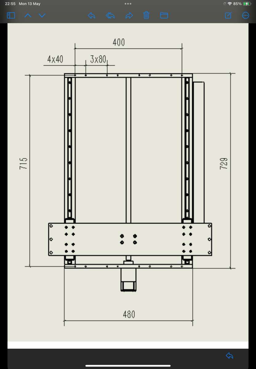

      See drawing below of the machine that the new bed would have to sit on.
      Cheers
      Steve

      #730677
      Dick H
        @dickh
        Daft suggestion, put a dial indicator where the spindle is and try and see where the flex is, it could be in the gantry. Alternatively attach longitudinal stiffeners under the extruded aluminium table to stiffen it a bit and possibly change resonances.
        I have a tiny 3020 toy and found adding an extra linear guide rail on the gantry stiffen things up a lot. It added a bit more rolling resistance but no more inertia. A lump of steel as a table will up the inertia greatly.
        Dick.

            The ideal bedplate is rigid, doesn’t vibrate, and has enough weight to not move as the router applies cutting forces.
            I don’t think the type of steel will make any difference, so buy the cheapest!   Cast-iron is good for bedplates because it deadens vibration:  some metals, like silver and bronze, make extremely good bells.  Steel not so good for bells, but it certainly rings!  Not ideal.
            A block of granite or marble should do a good job, or a thinnish steel plate on a steel frame filled with concrete.

              If you are cutting right through you will want a sacrificial mdf topper, and you will start by machining that flat in situ If the bed is fixed a lower level of kitchen worktop will add mass and is fairly flat as a starting point.
              For machining steel I would then add a temporary smaller sub-bed of Al perhaps 1/4″ and again machine flat in situ.

                  One of your problems is likely being able to find a piece of steel large enough yet with a good enough surface to use as the bed/table. Easy enough to get hold of hot rolled but really you would want a better surface than that.
                  I suppose it would be possible to mill it flat but that would only cover the 600mm x 400mm cutting area and leave a ridge around the edge.
                  One option would be to look out for a second hand cast iron surface plate 2ft x 3ft which would give the overall area needed, a flat surface and unlike stone would be easy to drill for a series of tapped holes to use for clamping work, vice etc. Also not affected by any coolant that could soak into say a kitchen worktop and cause it to swell.

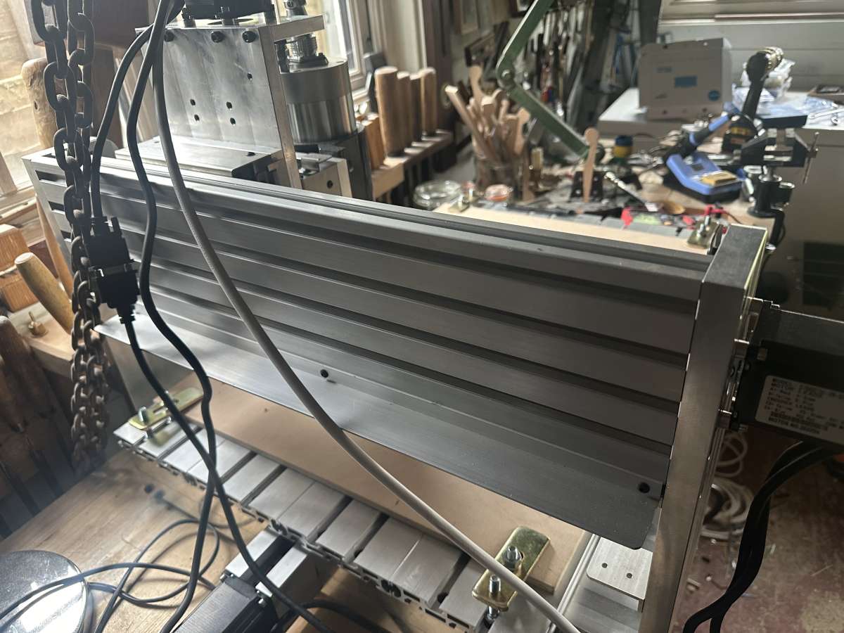

                    The machine is the moving gantry type – see pic 2. Stiffening the gantry is pretty easy as I can just bolt some stiffening materials on to it.
                    For the bed I was originally envisioning a steel plate, but to buy one of an appropriate size, and get it cut and drilled, including fixing holes, I think I’m looking at at least £500. Which isn’t ideal – spent too much on this already.
                    I really like the idea of a concrete countertop type thing. It might end up a bit thick and take up Z axis space, and I will somehow need fixture holes. But it might be cheap 😎

                                          If engraving you will want a flat surface, I have engraved on my CNC mill to a depth of 0.06mm so if you don’t have the work flat then the depth of your engraving won’t be consistant.
                                          It can be got over by adding a sacrificial board or plate and milling that flat first, then fix the work to that but starting off with soming flat to start with is an advantage.
                                          I did have a look at that brand of machine as don’t think my surface plate idea will be that good as you need the plate to allow the frame and rails to go below it. I also think a lot of the vibration etc is likely to be coming from the structure not just the bed.
                                          Flimsy clamps as in your photo don’t help and with them just being at the edge your board is likely to flex in the middle. Better to drill some holes in that MDF and use several counterbored holes so it can be held down with screws at regular intervals. Additional holes right through the board to allow clamps in the tee slots to be used nearer the work to hold that down will also help rather than a lot of what I see on routers which is a bendy bit of flat bar and a wood screw into the MDF. Engraving can use two layers of tape and superglue to hold the parts but you say you want to cut the sheet in which case a more solid hold is likely to be needed.
                                          While on the subject of MDF, the DIY shed bought stuff is not that dense, get hold of some MR MDF (Moisture resistant) as that is 50-70% denser

                                            The clamping etc in the pic is strictly just to get me up and running and learning to use the machine. And I really do want a decent bed, with good facilities for work holding.
                                            My current thought is as follows…
                                            The existing bed is 20mm thick. Remove it.
                                            Build a “tray” with a 5mm steel base and 10mm wide x 20mm high sides (new base height of 25mm)
                                            tap holes in the base and use thread reducers (say M10->M8) at 100 mm intervals across the base of the tray.
                                            potentially add some “bracing” to the tray for additional stiffness
                                            Fill the tray with a mixture of sand and gravel mixed with epoxy resin.
                                            Allow to self level and set.
                                            Extremely rigid base with excellent vibration damping capabilities?

                                              If you can “cast” the infill with the steel level and flat then best option would be to then flip it over and have the steel at the top. All threaded inserts will then be pulled against the steel rather than the epoxy. I suppose doing it while laid on the existing bed would be the flattest option
                                              Set some threaded inserts in where it bolts to the frame below so they make contact with the frame rather than the infill which is unlikely to self level to any accuracy.
