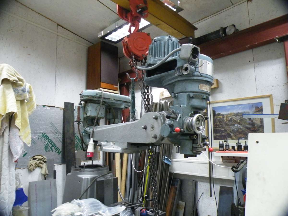

      Any advice and guidance please. I am retired so time rich, no need to rush.
      It’s a Beaverpal vertical Mill (like a Bridgeport but slightly shorter)
      Like many of us there comes a time when the really big and heavy items should carefully be recycled one way or another. The mill will have to be fully stripped to, motor, head, ram, bed, etc after removing the modern DRO. I think, well hope, the elephant foot base alone will pry bar onto bars as rollers- by then hopefully the challenges of other parts removal will be memories and no lasting scars on me.
      Starting out- Do I remove the motor ( I fitted single phase motor well over  twenty years ago – hope I made it easy to remove) and drive casings and then rotate the head, raise the bed .create support so head comes onto table then lower to transfer to sturdy trolley?  I have seen a youtube video of Bridgeport head coming of vertically BUT the they have fork lift to pick it up by- that’s cheating!
      Hope the Ram comes off forward as mill is tight in a corner, use table plus a frame -as above to support?
      The raise and lower platform beneath the bed looks heavy and likely to be tricky to lay down safely-any ideas.
      No room for engine crane and no roof beams to winch off.
      Yes when the dross that’s parked all over the mill is removed and mill is coming apart I will update, try to do photos.
      Now any  ideas/suggestions how to proceed are very welcome.
      Anyone near Aylesbury Bucks is welcome to come and drink coffee/HELP. I think a good sense of humour is going to be needed.
      YES I WILL WEAR SAGFETY SHOES AND TAKE GREAT CARE – old bones if they heal they do it slowly I’m told

        When I re-erected my machine tools in my present (and probably last!) home I constructed sheer-legs, ramps and the like using some scaffolding tubes and clamps, and heavy timber.
        Rope block-and-tackle, a small trailer-winch, a puller (for horizontal moves only), crowbars, rollers and jacks were the moving parts. This was all a few years before I built my overhead crane.
        I also took the precaution of buying a few, proper lifting-slings and shackles. They are not very expensive, are stocked by builders’ and mechanics’ tool-shops; but you do need know their “Dos and Don’ts” , such as never tie knots in slings. It is just not worth risking using any old rope or chain for heavy machine parts unless you literally “know the ropes” and are competent with knots and splices.
        Oh – and indeed I wore my safety-boots.
        If at all possible, ask for help from someone you can trust in a hazardous operation, especially trustworthy enough to do exactly as you instruct if he or she is not very mechanically-minded. I rebuilt my workshop alone, but that is not ideal. (Yes, I had asked if anyone in my model-engineering club would be so kind…)
        The one other thing to use, you cannot buy: brains!
        Plan all the moves, think carefully where things need move, how they will move, and how they might want to defy you.  Think how removing one unit (such as a motor) will affect the balance of the adjoining parts. Test each lift, too: raise the load just enough to ensure balance and security before completing the lift. Plan whatever temporary installations you need make, so they are as efficient and safe as possible.
        Never put yourself below or in the path of the load or a potential topple, where either can trap you. If something costly starts to fall our instinct is to try to save it… no – get out of its way! So always ensure your escape route.
        Never grasp rollers to move them under the load: roll them by the palm or better, a stick. Similarly when pushing something into place, to ensure it does not eat your fingers.
        (A toppling load does not need be ever so heavy to be fatal, if it pins you across the chest. When my employer moved to a new site, a young lad working for the removals company died when he tried to move something in the van, and it fell over onto him…)

            Borrow an engine hoist? Probably not to lift the whole but can lift one end to get the rollers underneath. Or a trolley jack but remember not to fully trust hydraulics.
            Using itself ie the knee as part of the lift/lower is a useful technique.
            A ladder can support a grown man with safety margin. A beam can be rigged between two stepladders or ladder leaning against wall can be used to remove sections to lower to ground.

                    I’m not at all familiar with those Beverpals, but if it’s the same general arrangement as an actual BP mill, they all come apart pretty easy. I don’t know that rotating the head to a horizontal position is the official way to do it though. Pull the motor, then I just run the knee up as high as it will go, slightly extend the spindle until it just starts taking the weight. With a second helper, have them hold the head balanced on the table as the bolts fastening it to the knuckle are removed. The heads are heavy so are best moved by two people. When you set it down and transport it, be EXTREMELY careful that head can’t roll at all. Some of the controls are fairly delicate and they will get damaged. If it’s got the usual turret, just rotate it 90 degrees and the ram should come out the front.
                    If you pull that top turret cap, the spider inside the column will drop off as the last bolt is removed. That’s not an issue. just something to be aware of. Pull the tables X axis hand wheels or cranks, and dial assemblies. Remove the X axis gib, fully unscrew the X axis feed screw from the nut and remove it. At that point the table can be slid off either end. IT’S HEAVY. Remove the Y axis crank, dial feed screw and gib in the same manner as that X axis. Slide the Y axis off the knee. Run the knee as high as it will go, remove it’s gib. With the ram off the column, the knee slides out the top. Again IT’S HEAVY.
                    That now bare column and it’s base and depending on the size of that mill, should now weigh somewhere between 300 & 600 pounds. If that mill has a one shot lubrication system on it, then obviously it and the lines should be disconnected as each table part comes off. When I bought my own BP clone, I’d never operated or seen one disassembled before. It took me about 4 hrs. Today I could probably pull mine down to it’s basic components in about 2 hrs. But if you’ve never done it before, then plan on it taking as much time as it’s going to.

                      Steady progress, decided remove everything I can in situ initially- every bolt/screw making parts lighter;
                      DRO carefully removed and stored safely.
                      Motor from head removed – ready for the scrap man, condensation over many years had rendered it a liability.
                      Belt casing (ally) and pulleys removed – ready for the scrap man. will keep the ally step pulley.
                      Head removed in component form – casings for the scrap man, now have a box (heavy) of the gears/shafts- for those one day projects.
                      X axis feed motor and feed unit removed – a real fight has a control lever through the bed into the feed unit , the x axis feed screw has to come out the end with the feed box, guess which end I had against the wall
                      Table removed, very heavy – ready for the scrap man.
                      Ram is challenging I still have working Knee with y carriage so possible to slide off  Ram and lower but the rack and pinion drive restricts forward and back. The rack has blank sections at both ends that the pinion will not ride over? Interesting the gib on the ram can only be removed after the ram comes off- strange to me – as it stops lifting the ram off the rack.
                      Or leave and lock down the ram and ram turntable, fully lower the knee, remove the y carriage. Then juggle  out the rest on some bar/rollers.  Leaving knee on helping to reduce any toppling and only use 1 inch bar as rollers. (The base will have to come out that way anyway but had hoped it would be lighter)
                      Found a really old coolant pump tucked inside- removed – ready for the scrap man.

                        Try removing the pinion that drives the rack on the bottom of that ram. With blank ends on it, then the pinion has to come out first. Back off any locks or gib adjusters completely, and the ram should slide right out.
                        #769162
                        Mark Rand
                          @markrand96270
                          Easiest way to get the ram off the column is to lift it with the turret. The turret doesn’t add a lot of weight, but it’s only four nuts to remove. The crane helps, but even without, it should be possible.
