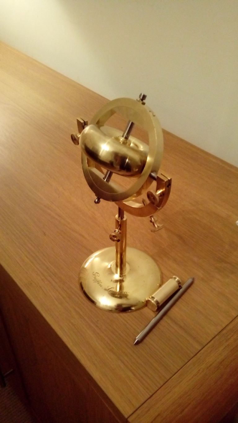

                                MW
                                  @mw27036
                                  My display picture is actually of me, turning a new gimbal ring for somebody, I also made a few other bits anew. Such as the screws and the clasps. Heres a pic of what the final result was.
                                  Was a very interesting exercise, if not a little hair raising boring the 8mm brass ring.
                                  Michael W
