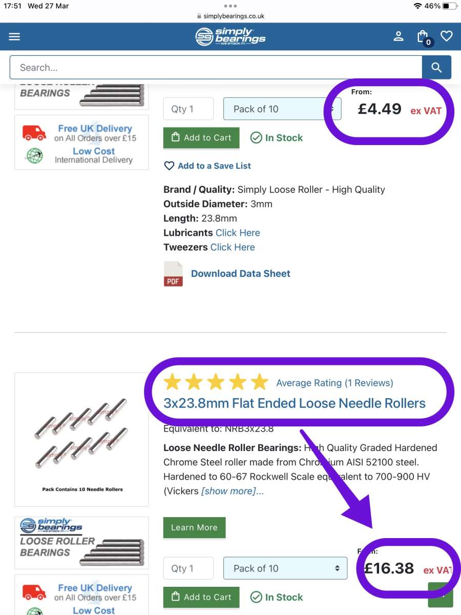

                                          On duncan webster 1 Said:
                                          Simply bearings price is for a pack of 10, so 45p each. Doesn’t seem expensive to me, and I’m a Yorkshireman
                                          Not for the size in question … have a look
                                          Over £16 + VAT + Postage
                                          Seems a significant expenditure when I only want one.
                                          Thanks anyway.

                                            Michael, they must have a different price for people living in Wales. On my interweb it says 3mm *23.8mm rounded end £4.49 for a pack of 10. Plus vat +post of course, which will bump the price up. I can give you a piece of 3mm silver steel, but you’d have to harden and temper it.
                                            #722463
                                              < Oh dear >
                                              I thought you liked “doing sums” , Duncan
                                              Hopefully this annotated screenshot will clarify:
                                              IMG_9483
                                              #722464
                                              duncan webster 1
                                                @duncanwebster1
                                                That’s showing flat end, my price was round end. Do you need flat end? If you do then next length up round end is £7.79 for 10, carefully grind the ends off
                                                #722468
