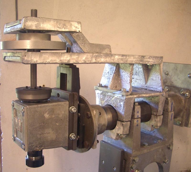

      Hello
      I do have an some sort of Idea how I could do this, but not sure it's the right way, or someone come up with or knows of a better way
      I have got a lathe head stock casting, but will be fitting my own h/t steel shaft, 1'' Dia , the Bearings I am fitting are Taper roller bearings, the shaft does not have threads to fit locking rings/nuts ,
      Without me having to cut threads, How can I go about Preloading the taper roller bearings
      lee

            If you don't need a hole thru' the middle of shaft you could just tap the end and use washer and screw or stud and nut, with locking device. For a thru' hole type (highly recommended) a short sleeve on the outside of shaft, with grub screw clamping, and maybe 3 or 4 tapped holes to load the bearings.

              Depending on size a spring or Belleville washer. You would need a well fitting collar to press against and several grub screws.

                  From very informative discussions I have had recently (thank you Ketan!) regarding a similar set up, very little pre-load is necessary. Just enough to prevent end float.

                    I had exactly the same situation with the milling machine that I built. What I did was to buy a taperlock pulley and drill and tap four holes through the bush, I then used grub screws to bear onto the rim of the bearing. It works perfectly. The attached photo shows how it appears, I machined the groove oncimg3460.jpg the pulley away.

                        Like I did say, I had a good idea how to do it, my thoughts were going the same way as Gordon w' mentions , it's good to run it past other people with the same interest and experience, makes me feel better
                        Rod, thanks for posting,
                        Ketan' mention how little preload is needed, I can understand that, but you still got to get preload on those bearings
                        Norman, I like the milling machine, good bit of ally in there
