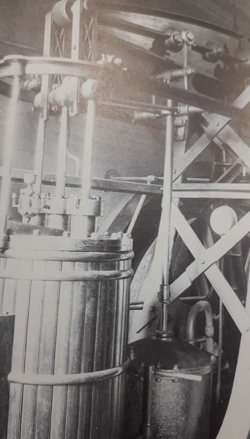

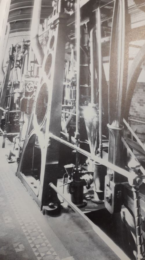

                            Page 93 of the london & SE book has a similar style engine in a London gin distillery, I'll scan it later.
                            #381750
                              Examples from some of the books I have here…
                              Two early house built engine with water and condensor pumps from chains on sectors on the beam.
                              Robinsons beam engine air pump from Watt parallel motion
                              'Watt engine for Robison' of 'gloroius complexity'; four drives one off parallel motion, three off the beam.
                              Early Boulton & Watt engine, three drives from underside of piston, parallel motion and beam on far side of pivot.
                              Evan's Grasshopper – two air and water pumps driven from separate points on the beam between the mid-point and the pivot end.
                              Hornblower's compound, from the beam, one either side of the pivot with one split to operate two cylinders.
                              Unknown column and house-built beam engine – four(!) rods dropped from the beam along its length for various purposes.
                              McNaught compound. One dropped from the LP parallel motion and one from the beam.
                              Horizontal engines appear to show a greater variety than beam engines.
                              Conclusion… for a beam engine the beam provide many places where you can place a pivot and to get the motion you require. Distance along the beam seams arbitary so is probably determined by the pumps needs and function.
                              Drive from the beam is usually arranged to one side of the beam, except for wooden beams where it can easily be attached to the underside.
                              Drive from the parallel motion is either from the lower pivot rod or the lower end of a rod fixed alongside (but spaced behind) one of the motion's vertical rods. The examples I found were engines with the parallel motion under the beam.
                              Clearly some of these arrangements are likely to have the cylinder off the centre line.
                              Bear in mind a condenser air pump will always be close to the cylinders.
                              Well that was fun… I'll control myself and not try and figure out all the options for horizontal engines!

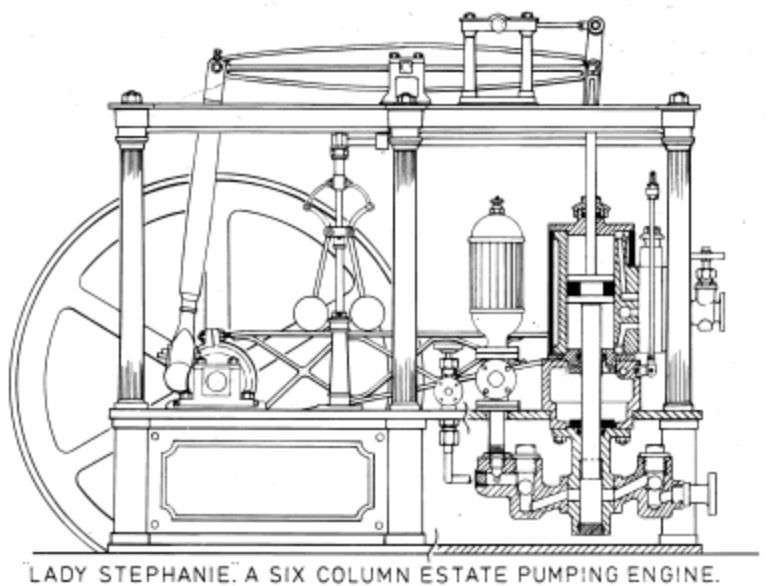

                                    Thank you for all the contributions. They have certainly given me plenty of leads for searches and I have a couple of books ordered.
                                    To pick-up on Maurice's point that there are unusual features of the bracing and framing:
                                    Westbury himself acknowledges that: "The engine is a little unusual in the design of the "entablature" or framing around the top of the beam supports and above the cylinder; in fact, it may be said to lack this feature, in its true sense altogether". Later he continues on the same theme, "In this case, a horizontal frame of U-shape attached at its ends to the tops of the A-frames, and at its centre to a vertical bar mounted on the cylinder, serves the purpose of the entablature."
                                    The origin of the Vulcan (Westbury) design is attributed by him as follows: "The design…..is one based on an engraving found in a very dilapidated and dog-eared text-book on the steam engine dated 1847,……..the design could not have been later than about 1830. It is in my opinion a fairly typical example of one of the earliest engines of all metal self-contained construction…". He subsequently continues "I may say at once that I have not attempted to adhere exactly to the details of the prototype."
                                    Of course the existence of an artists(?) drawing doesn't mean that such an engine was ever constructed, however I'm assuming that the most glaring errors and artistic interpretations would have been picked-up by the original editors and subsequently Westbury himself.
                                    Thanks for the excellent pics Neil. These would suggest to me that manufacturers had 'basic' castings that they used for a style/size of engine. If a boss was not required by a particular customer usage then it was simply not used. But it was always there for those that specified a use that would require it, or as you pointed out, for subsequent additions and alterations. I would guess that this casting 'kit of fundamental parts' would allow costs to be minimised; whilst there are some splendid decorated 'architectural style' engines, in general I can't see Victorian industrialists wanting to pay anything but the absolute minimum for a machine that would be 'hidden' in the smallest possible space and never seen by any but the 'driver' and repairers.
