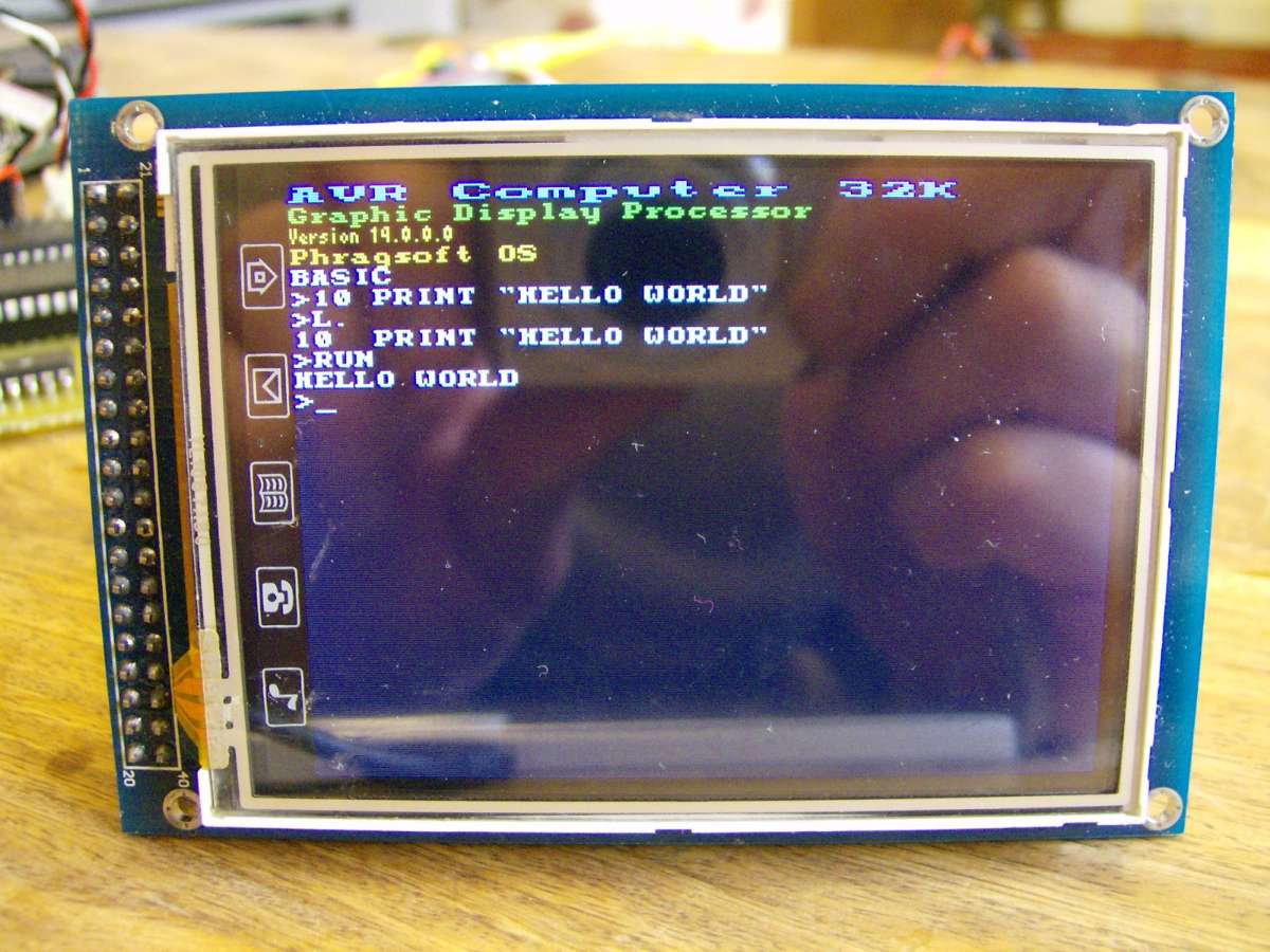

I once made a small computer based around AVRs (the microcontroller in Arduinos).
One operates a display and responds to BBC VDU commands (I made versions for several types of display, and used them in a few other projects).
The other interprets (nearly all of) BBC Basic. I set it up to use the tiny keyboard from an Amstrad Emailer. Doing it again, I would use an ordinary PC keyboard for ease of use.
Early version
Trial run…

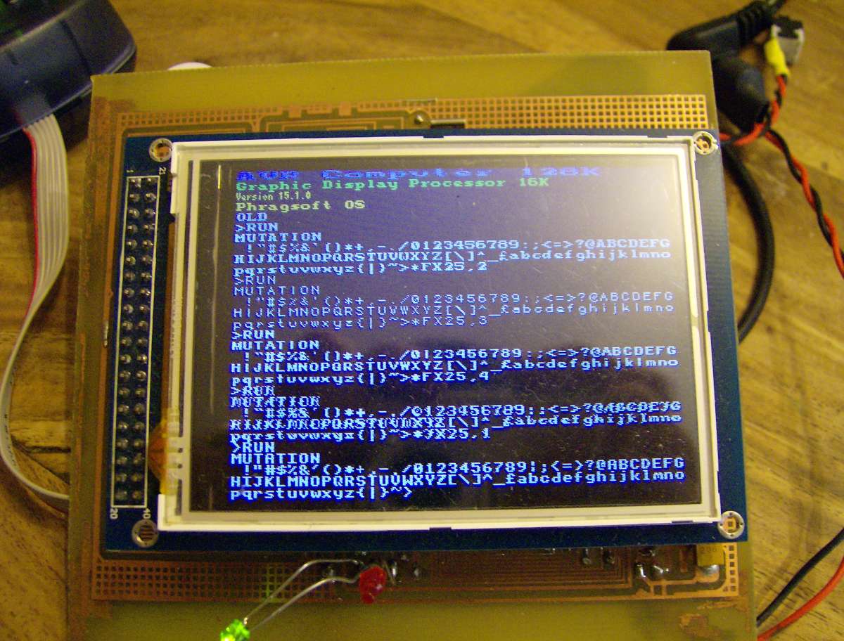

Later version
Font test

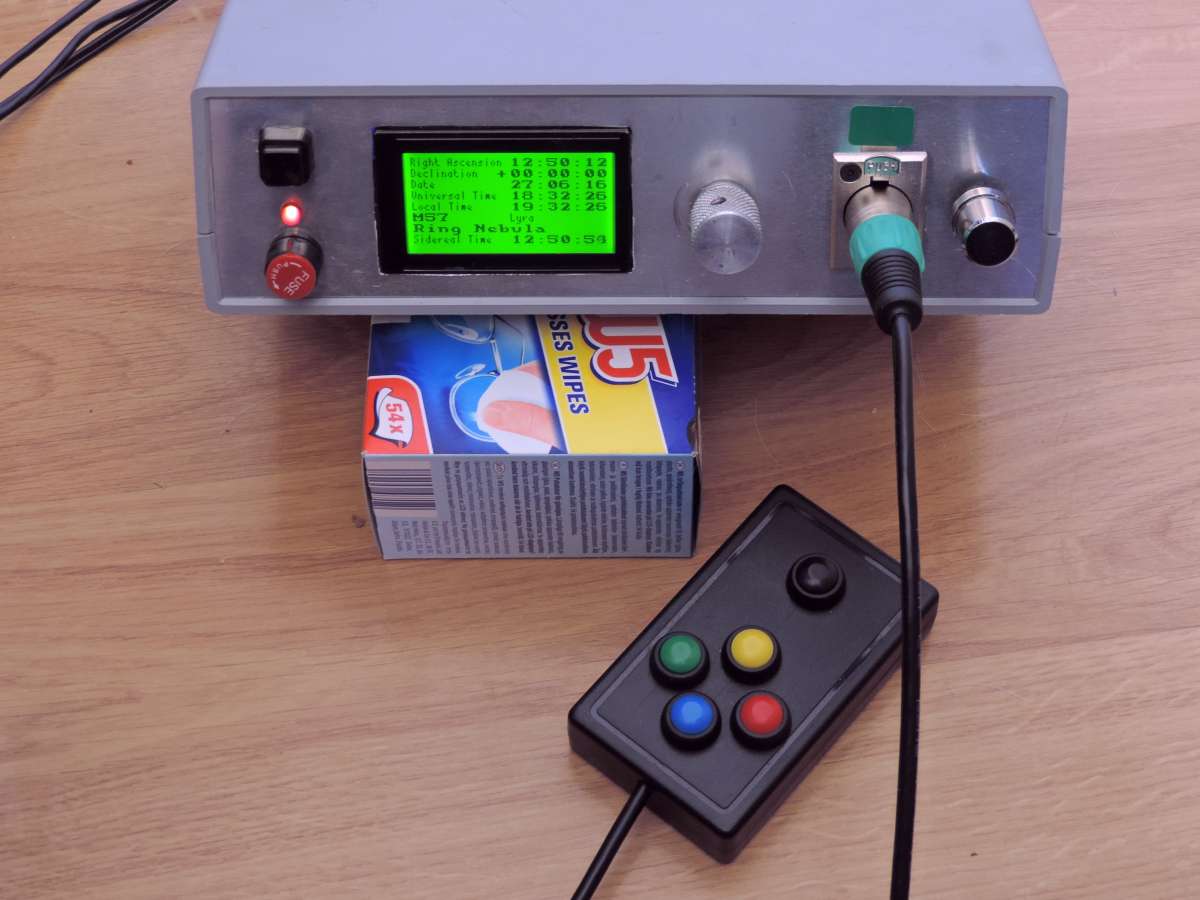

Telescope guider with display using an early version of the VDU driver:

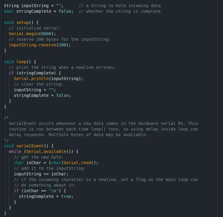

On the Arduino platform, access to the serial interface is provided by the Serial object. It connects to the USB port and to Pin 0 (RX — Receive) and Pin 1 (TX – Transmit). Cross connecting two Arduino so that TX goes to the others RX and vice versa allows them the exchange messages. This example from the Arduino IDE shows non-blocking Serial read:
The Baud rate is set to 9600. Then the receiving program loops continually until a flag is set showing that a full line of data has been received. The program doesn’t wait, which allows loop() to process other functions in the meantime. However, Arduino provide a special built-in function called serialEvent() that’s automatically called by loop() on every cycle. Normally serialEvent() is empty and does nothing, but in this example it checks the Serial buffer to see if any characters have arrived, and appends any newcomers to a string, before carrying on. When a newline character is received, the flag ‘stringComplete’ is set true. Code in loop() checks the flag, and processes the input. The input can be anything, perhaps a line of data to be displayed on a screen and logged to a memory card, or a g-code command like “G00 X0Y0Z100” that has to be parsed into whatever motor-control pulses are needed to move the cutter as quickly as possible to table coordinates X=0, Y=0, Z=100
I recommend starting with simple examples, such as having one Arduino sending an incrementing count to another that displays it. Or if you prefer two PICs, two Nucleos, two Micro:bits, or any other pairing. Conceptually an Arduino can be programmed in C to talk to a Micro:bit running MicroPython or to a PIC running BASIC. The main problem with mix and match is the learning curve because the implementation details are all a bit different, and the programmer has to get all them all in alignment. In practice, that feels like herding cats, so many programmers stick with whatever platform they know best, just to reduce the amount of swotting needed.

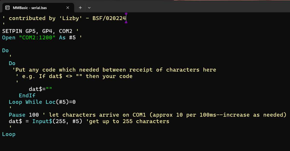

Dave, an interesting comment on serial comms and ‘blocking’. I can see that it could be a problem but it’s not something I’ve encountered in practice (probably because I don’t transmit very large amounts of data – just a few characters or use very high baud rates, mostly (the default 9600baud 8N1) in my apps. By co-incidence the Backshed Forum had a post about serial comms this morning and I remembered this code snippet from the thread.
MM Basic (as used in the PicoMite) has a (default) RX buffer of 256 bytes but this can be increased as an (optional) “OPEN” parameter if required. My programmes are generally pretty small and memory size (or lack of it) isn’t a problem. The PicoMite has a maximum programme size of 160Kb and this doesn’t include the ‘Flash’ storage slots also available for programme storage.
I must admit, being a ‘numptie’ I haven’t bothered to use ‘LOC()’ – I generally just open and read/write to the “file” as MMB handles this very well. Having read your post above, I will now try to mend my lazy ways and (as Lizby suggests) check the buffer too.
For anyone interested in what is happening here – I’ll attach a bit of the manual below to explain further
Regards,
IanT
Once a serial port has been opened you can use any command or function that uses a file number to read from
and write to the port. Data received by the serial port will be automatically buffered in memory by MMBasic
until it is read by the program and the INPUT$() function is the most convenient way of doing that.
When using the INPUT$() function the number of characters specified will be the maximum number of characters
returned but it could be less if there are less characters in the receive buffer. In fact the INPUT$() function will
immediately return an empty string if there are no characters available in the receive buffer.
The LOC() function is also handy; it will return the number of characters waiting in the receive buffer (i.e. the
maximum number characters that can be retrieved by the INPUT$() function). Note that if the receive buffer
overflows with incoming data the serial port will automatically discard the oldest data to make room for the
new data. [Hence my comment above about being able to increase the RX buffer size if required]
—————–Dave, an interesting comment on serial comms and ‘blocking’. I can see that it could be a problem but it’s not something I’ve encountered in practice (probably because I don’t transmit very large amounts of data – just a few characters or use very high baud rates, mostly (the default 9600baud 8N1) in my apps. By co-incidence the Backshed Forum had a post about serial comms this morning and I remembered this code snippet from the thread.
Yeah, not many application programs don’t need to respond instantly to external events, provide a non-stop service, finish within a tight time slots, or transfer data flat-out. Much needed in real-time, embedded and operating systems though.
The MMBASIC example is the sort of approach that’s needed, but although Lizby is on the right track, I suspect it’s not quite right. The code loops correctly allowing other work to be done until file #5, actually a serial port buffer, contains at least one character, detected with loc(). Then control drops out of the loop and blocks at “pause 100”, presumably in expectation that more characters on on the way. That pause wastes a lot of time, doesn’t guarantee all the input will be read, so it has to go!
I liked loc() until reading in the manual that ‘input’ returns immediately from a serial port read, which I think makes loc() unnecessary for this. MM BASIC is unusual in that input attached to a serial port doesn’t block, which is handy. It also allows an interrupt function to be attached to a serial open, another good way of responding to a ‘react immediately’ event. A potential objection to loc() is that it’s a file seek operation, which is very slow on many systems, depending on how it’s implemented. Be interesting to measure how long MM BASIC takes.
Time critical event handling is great fun to program, because there are so many ways of getting it subtly wrong!
