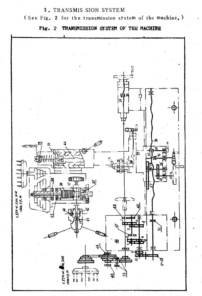

                          If it is the same lathe as in SOD's link, then it looks like a good heavy kit. I would like to suggest that the headstock bearings are bigger than the specifications you state: 15 x 32 x 9 (6002-zz or 2RS). These bearings are more likely to be some countershaft bearings perhaps or some mistake?
                          If your spindle has an MT3 taper, then the spindle bearings are likely to have a bore of 30mm or greater.
                          Does your manual have some kind of exploded parts diagram? Could you take a picture and post it on here?
                          Have a closer look at where the chuck is mounted. Is it mounted onto a separable backplate or is the chuck mounted directly onto the spindle flange?
                          Is the chuck an 80mm chuck?
                          Can you open the side gear box, take a picture of that area and post it here?
                          If it is a mini-lathe on steroids, then the principles of dismantling should be similar. However, the 6 step speed suggests some kind of belt drive, in place of the hi-low gear arrangement to be found on the original brushed motor mini-lathe.
                          If it is similar to a mini-lathe, this guide may help you, although the bearings may be a little different, and there may not be a countershaft for high low speed gear change. Also here is the Link to full dismantling of a C3 (not SC3).
                          Ketan at ARC

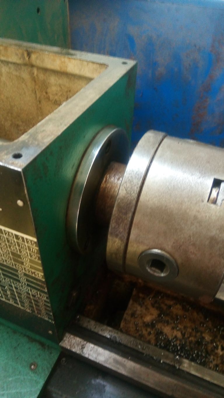

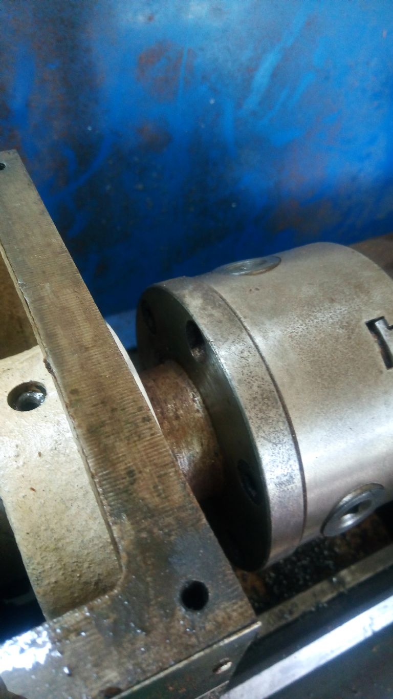

                            Ketan,
                            Sorry for the tardy response, I can't really offer any excuse except to say I'm retired and refining my procrastination.
                            Based on your argument it does look as though the headstock bearing I need to replace could be item 46, a 36 x 62 x 14 mm bearing.
                            The chuck is secured by a series of allen bolts to a round plate that looks to be integral with the shaft drive from the headstock. A second plate is secured by allen bolts to the casing of the headstock.
                            I'm worried about damaging things when I remove and replace the bearing. To a lessor extent I'm worried about opening it all up and then finding I have the wrong replacement part and having to wait a month while mail order does its stuff in Thailand.
                            Pictures follow below.
                            Cheers, Colin

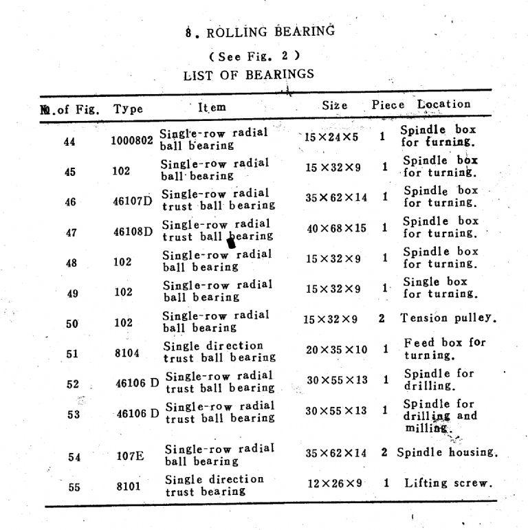

                                The key bearings appear to be Fig. 46 and 47, which translate as follows:
                                Russian/Chinese No.46107D = International No.7007A P6 (ABEC 5) – Angular Contact Ball Bearing
                                Russian/Chinese No.46108D = International No.7008A P6 (ABEC 5) – Angular Contact Ball Bearing
                                Most bearing dealers outside Russia and China will easily recognise the international numbers. However, what may be tricky will be to find contact angle 'A', with P6 (ABEC 5) precision, where contact angle A = 30 deg., B = 40 deg., and C = 15 deg. (ref.NACHI Bearings).
                                Generally, 'B' is easily available is general grade, and 'C' is easily available in high precision. For your particular lathe, your max speed is considered to be 'low' when it comes to bearing selection. You will not necessarily need high precision P6 (ABEC 5), if you look for a good Japanese brand from a well known local supplier. So, your choices are for example:
                                NACHI/NSK or similar Japanese brand : 7007B and 7008B – general purpose Angular Contact Ball Bearings, or
                                if you want high precision, commonly available are:
                                NACHI/NSK-RHP : 7007C P4 (ABEC 7), and 7008C P4 (ABEC 7). (Note: P4 is higher precision than P6, but as it is more in production, it can be cheaper than P6)
                                The high precision bearings are designed for running at high speeds…. much higher than the max speed of your lathe.
                                I have avoided mentioning SKF, as, unless you buy from an authorised guaranteed SKF dealer, it is very easy to end up paying for fakes. Also, I know that the brands I have suggested above along with other well known Japanese brands are more popular in Asian markets, available at reasonable price.
                                Also, depending on when your machine was manufactured, and on what machinery the bearings were manufactured, it is often the case that in earlier times, the Chinese 'D' (P6 precision) was similar to current Japanese general purpose precision – P0.
                                Translations for other bearings in the list are as follows:
                                1000802 = 61802 also known as 6802 – Deep Groove Ball Bearing
                                102 = 6002 – Deep Groove Ball Bearing
                                8104 = 51104 – Thrust Ball Bearing
                                107E = 6007 P5 (ABEC 3) – Deep Groove Ball Bearing
                                8101 = 51101 – Thrust Ball Bearing
                                A word of caution: Only buy the bearings you need after dismantling, because what it says on paper can sometimes be different to what is fitted.
                                Also, with reference to the Angular Contact Ball Bearings, note the way in which they were fitted – i.e. which way around, before you take then off.
                                Good Luck,
                                Ketan at ARC.

                                  Guru Ketan,
                                  Thank you for that carefully worded reply. The technical level you used suits me just fine. MiSUMi Thailand looks to be a convenient local supplier, **LINK** but I will first pull things to pieces as per your advice.
                                  Is there anything I can do to repay your kindness? Anything you need from Thailand? I'll be visisting the UK in a month or so.

                                    The link you sent looks good to me. At the end of the day, even if you get a good Chinese brand (e.g. LYC or HRB), or a reputable local Chinese bearing supplier, that will be just as good, as making bearings above 30mm bore requires a factory which has expensive large machinery investment. If you are unsure of the Chinese brand/supplier, or if you don't want to take the risk, stick to the known Japanese brands suggested, which include NACHI, NSK, KOYO
                                    There is no repayment of any kindness necessarysmiley. This is a forum where everyone tries to help wherever they can. If you are coming our way, drop in and say hello.

                                      Posted by Colin Whittaker on 03/01/2018 06:27:16:
                                      I guess I'm going to have to bite the bullet, savage a perfectly good allen key to fit in the gap between chuck and headstock, remove the three jaw chuck, and then cautiously go boldly.
                                      Cheers.
                                      Colin, are you sure that the chuck isn't screwed onto the spindle, just looking at the photos I immediately thought the lathe was similar to the many 920 types which have screw on chucks. The access for an allen key is fairly limited and would be an unusual fixing from my limited experience. Unfortunately the drawing doesn't help.

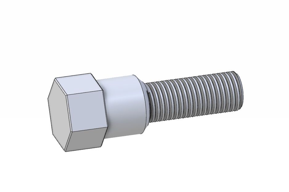

                                              It would seem that your lathe is similar, if not identical to mine, another Asian clone. I have a pdf copy of the lathe. I also have made a clarified chart of the change gear table as shown below: (the one in the manual is, shall we say, unclear)
                                              Where Z1 is spindle output, Z2 and Z3 share the intermediate shaft on the banjo and Z4 is the gear on the leadscrew.
                                              PM me your email address if you would like a copy of the manual.
                                              For Colin,
                                              In order to facilitate the removal and replacement of the chuck, I made three mounting screws from new Hex head bolts with threaded collars Loctitied on to them, so that the hex protrudes beyond the rear face of the spindle flange. Thus an ordinary ring spanner can be used instead of the angled, truncated and often lost Allen key can be used. Like this:
                                              chuck bolt

                                                  Also IMO, your chart for the Gear Change for the BB22 is excellent as is your drawing of the actual chain.
                                                  Thirdly, I made up a special "Allen Key" tool to get the chucks off – but I'll be plagiarising your Chuck Bolt design too.wink
                                                  IMO another fantastic idea!
