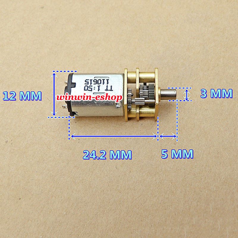

                          Thank you for all of your replies, which I need to digest properly yet. A couple of quick replies, though.
                          Posted by Bazyle on 02/04/2018 15:53:58:
                          Solenoids are extremely inefficient. extremely. If you like the design to use a pull/push linear action use a tiny motor, gearbox and eccentric.
                          Bazyle.
                          Someone else made this observation as well. I have considered a low-RPM motor like the one below. It claims to draw 30ma at 1.5v giving 25rpm. With a cam and microswitch, it would only need 1 revolution per operation.

                            Bazyle
                              @bazyle
                              Interesting link, he's made something work, and using wood with its friction too. Just shows I can overthink the complications. Even now I'm thinking his ratchet is wood-on-wood which has got to be high friction and he could have put some polished brass on the pawl working face to reduce friction.
                              You still have the problem of an arduino to power rather than a single IC clock counter.
