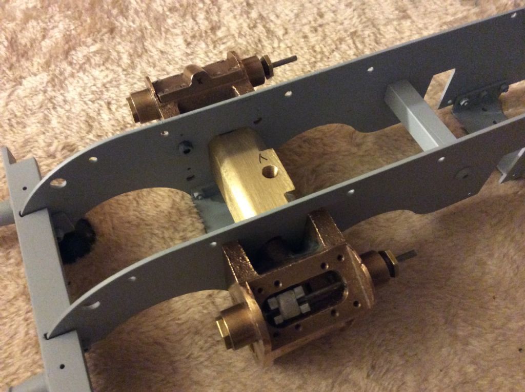

                                            Good evening All
                                            So health wise it's still crap, but to take my mind of that I've done some more work on the monster that I call the flying Scotsman, the train I'm dragging into reality.
                                            Constant battles and pulling hair out but I'm still plodding on, and today I feel a step forward. anyone who has read some of my previous posts will be aware of the mis-aligned cylinder exhaust holes, well in the below picture you will see my solution which I hope to work, I will put some steam sealant between all joints, the hole on the top will have a pipe up into the smoke box, now all this extra work was all because of these two holes and its taken me a long time to sort this, so if you see a major reason it won't work, please be gentle or I may cry 😥

                                              Hi Derek,
                                              The block is a sensible way to deal with the misaligned cyl holes. What holds it in place? is there at least a screw or two to the crossmember below? or could the exhaust nozzle be made to hold it in place? Some good high temp sealant will seal the joints, but you probably need a fastening system of some sort.
                                              Sorry about the health issues, take care of yourself. Other items in the pic look great! You are making progress. Just one step at a time… that's how all steam models are built, anyway! JD

                                                Hi JD
                                                To answer your question, behind the cylinders I've done countersunk screws holding the block tight to the inside of the frames, on the cylinders are short pipes which slip inside the brass block.
                                                All of this hassle has been because of the previous owners drilling skills, but seeing as this may of been done 50 years ago, I'm not going to disrespect them. It's been a challenge but actually I think this looks better than a copper pipe anyway.

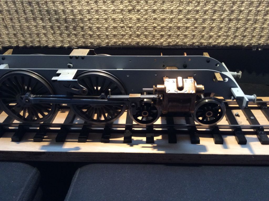

                                                    derek blake
                                                      @derekblake72550
                                                      A small amount of work done, started the motion works now installing what I can until I receive some more parts in due course.the day of steaming will be a long time away but Im looking forward to air test day to breath life into her after 60 years or so.image.jpg
