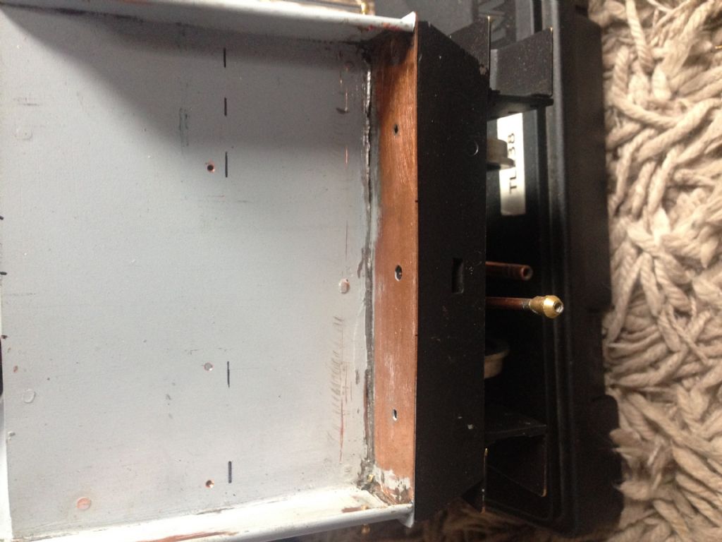

          Sorry about the sideways pictures, not sure how to change that but gives you an idea what it was like to now.
          Still more I'm going todo but it's a start, I hand made everything with strips and sheet brass.

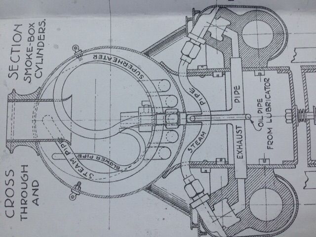

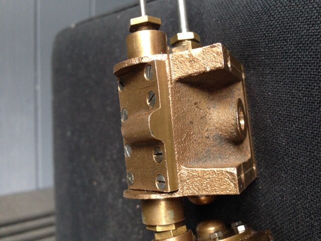

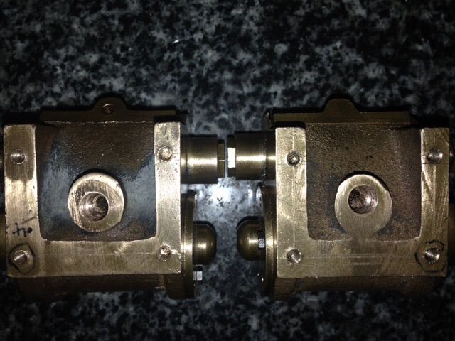

            Had a quick look at the cylinders to and the valve covers, there's really isn't much meat on them to take a union of today's sizes so I do wish I had the originals.
            The only option I can see is to screws in the pipe work which I really didn't want to do, I wanted to be able to take it all apart as much as needed.
            I wonder if anyone has these fittings in there work shop, the pipe is 3/16 but I can't find a union that's smaller than 5/32 to be threaded into the casting, there's only around 6mm to play with.
            So to leave any meet would mean I can't drill to big a hole., difficult for anyone to help by just an email I'm sure sad
            #256618
            derek blake
              @derekblake72550
              Sorry I meant 5/16 union, which obviously is to big for the valve covers, theres not that much meat to be able to drill that size hole, I think my best bet is to send the covers off and see if someone could make me a special fitting, if anyone knows someone please let me know.

                    Misaligned exhaust holes to add to the problems, I'm not giving up…image.jpg

                                            derek blake
                                              @derekblake72550
                                              Hi Nick
                                              The problem is which you can see from the valve cover pictures, I have only about 6mm of meat to drill/tap into.
                                              I can bet there's plenty of easy options with the correct tools and skills, I wonder if a better designed valve cover would work, I will have to keep think on that one.
                                              Many thanks for your help so far.
