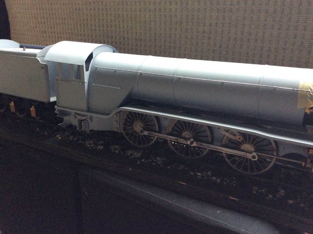

                #255172
                derek blake
                  @derekblake72550
                  Latest progress.. At least she's better than the original rolling chassis purchased from a flea market.
                  I hope to breath life back into her in the future..

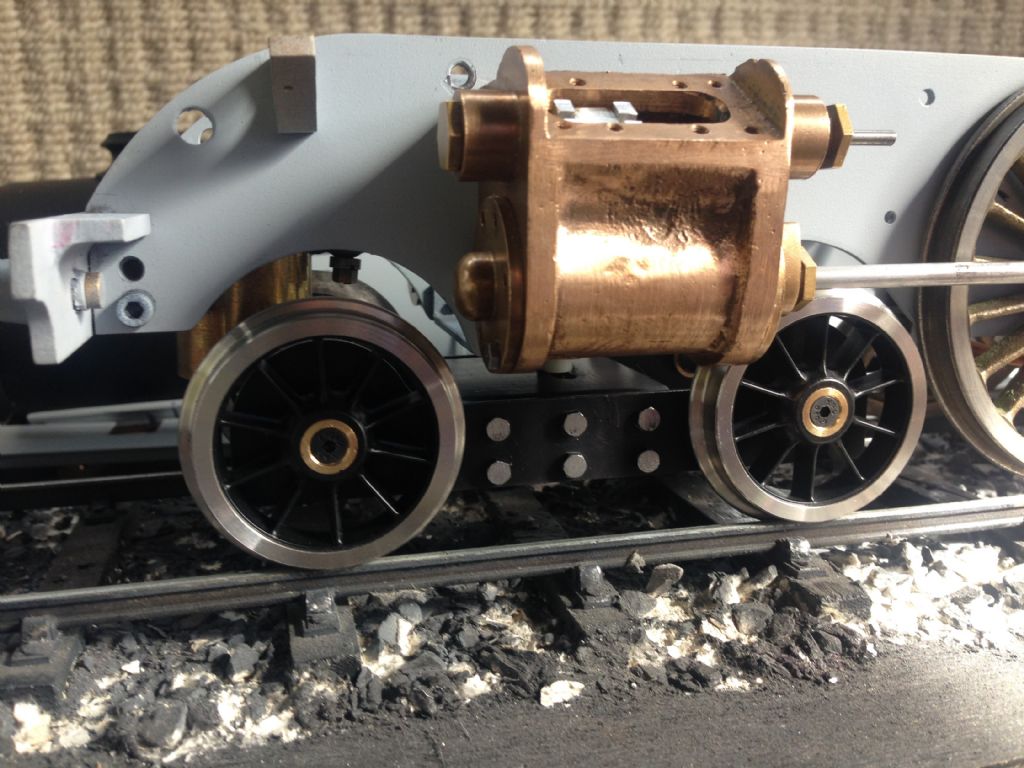

                  #255500
                  derek blake
                    @derekblake72550
                    Bogie started today, I'm going get some new main frames cut. I'm just not happy with what was done in the past.image.jpg

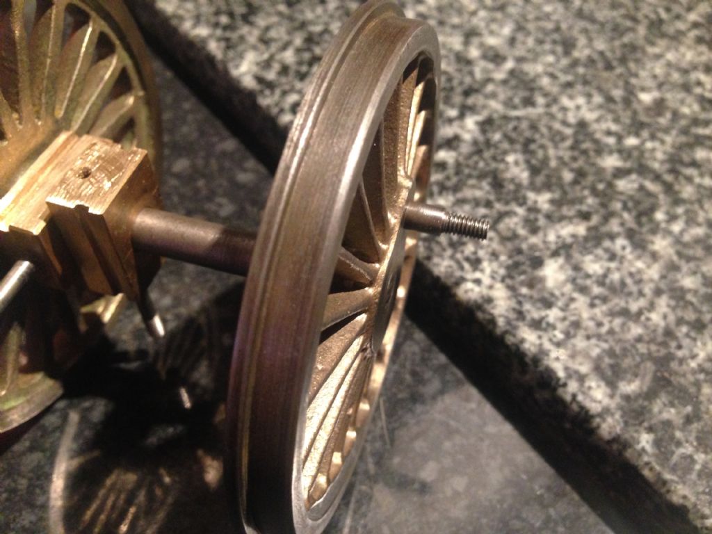

                                Just a quick question, so before Julian answers he told me so he is correct the more I dig into the train the more I see wrong, I've actually pretty much started again which is fine. So the frame spacing is under by 1mm, nothing to serious I feel except the main wheels are ending up 1mm to close together not helped by the way the wheels have been machined, do you feel there's going be any serious issue? I've added a picture to help, the cuts in the wheels are straight with no angle added.
                                #255709
                                derek blake
                                  @derekblake72550

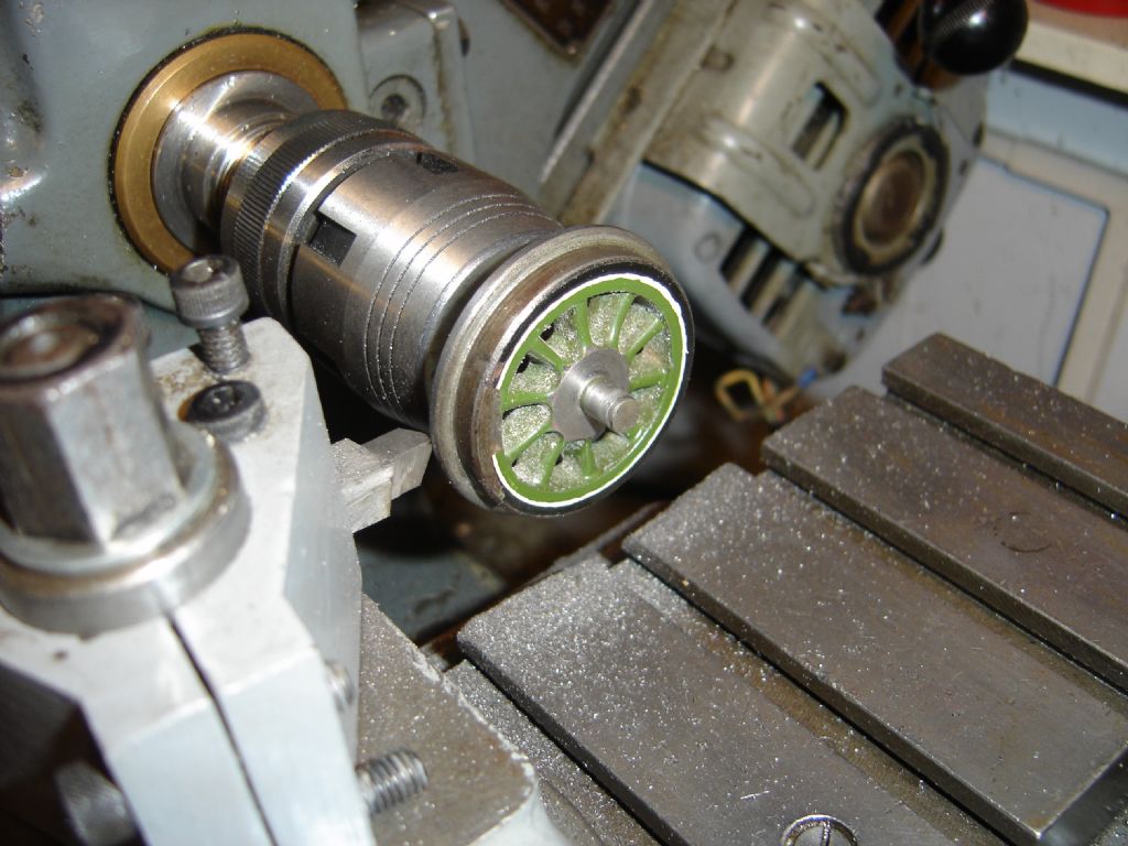

                                  #255721
                                  IanT
                                    @iant
                                    Hi Derek,
                                    I do normally 'cone' my wheels (and it is included in our G3 track standard) but not everybody does this and frankly I doubt it will make too much difference to your engine in practice. So this is not the end of the world.
                                    Of more importance (if you want to run at G3 GTGs one day) – are the various other wheel dimensions associated with the gauge which include things like the back-to-back dimension of the wheels, flange depth and width etc. You can find these details on the Gauge '3' Society website at Gauge3.org.uk/technical-standards.
                                    You might well find a few problems here – as one of my engines was constructed by a very well respected Model Engineer and the flange thickness not only varied widely but some were up to 1/8" thick. Not a problem on a MES track normally but not so great on a (G3) track with turnouts.
                                    Regards,
                                    IanT
                                    #255722
                                    derek blake
                                      @derekblake72550
                                      Thanks for your response Ian.
                                      I think I understand what you mean and will measure against what G3 require, the back to back I think should be 2 1/4 inch but I'm under that by 1mm, not sure what that is in inch.
                                      I suppose it's better to be under than over I guess.theres not much I can do than to do my best with what I have.
                                      Del

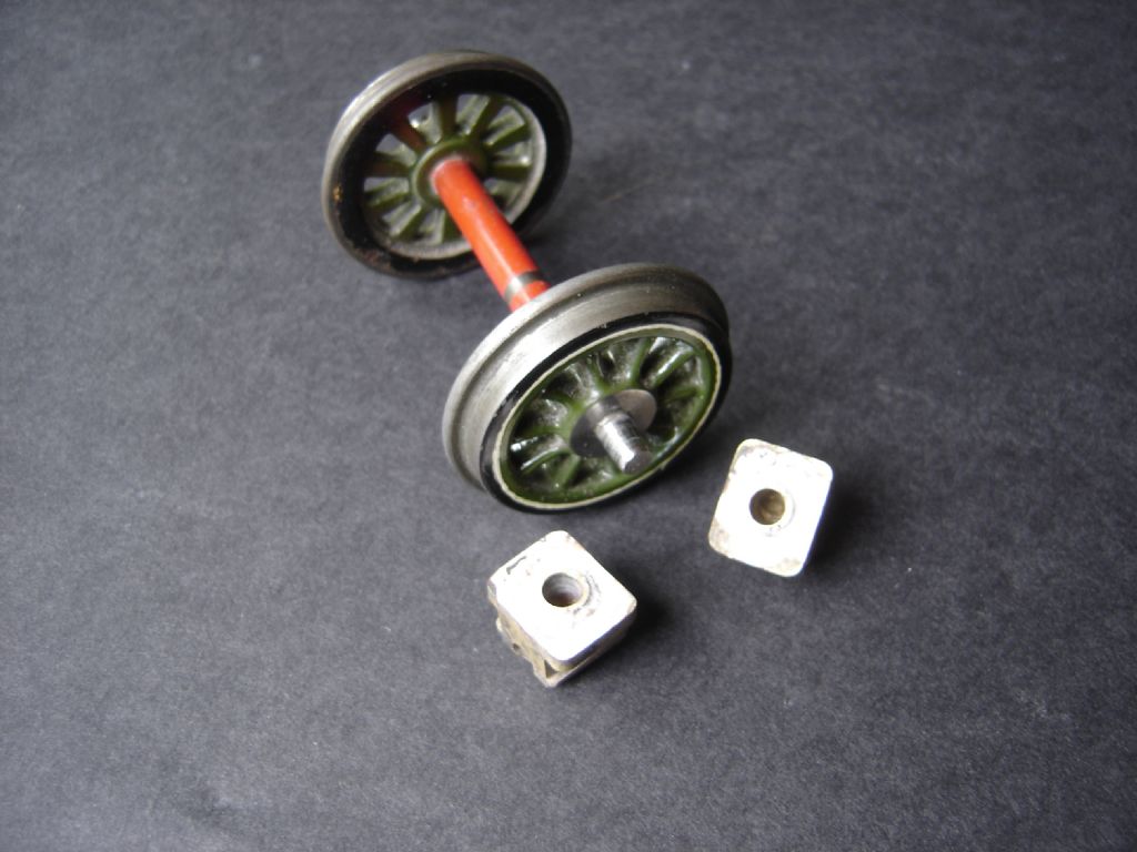

                                        #255731
                                        IanT
                                          @iant
                                          It's roughly 40 thou Derek… but if the rest of the engine parts 'fit' – for instance there is wheel clearance – then this may not be a problem – and most things can be corrected with a bit of thought…
                                          Dug these old photos out of the trailing wheels on the Atlantic – the flanges were way over size and the axle boxes worn oval. Bored the axle holes out and silver soldered thick wall tube into the boxes, then trimmed the flanges and 'touched up' the axle ends – then drilled the tube to a running fit. One of the flanges on the main drivers was badly chipped but I decided to live with it and it hasn't cause any problems. Otherwise it would have been a new steel tyre…possible but as it happened unnecessary.
                                          Try not to worry so much! smiley
                                          Regards,
                                          IanT
                                          Edited By IanT on 13/09/2016 20:23:50
                                          #255733
                                          derek blake
                                            @derekblake72550
                                            Thanks Ian that's interesting, I will look at the G3 spec and measure mine, the trailing wheels and bogie wheels I've had to buy from slaters ready made as mine where missing, so I'm pretty sure its on the driving wheels to concern me.
                                            Like you say most things can be solved.
                                            Thanks again

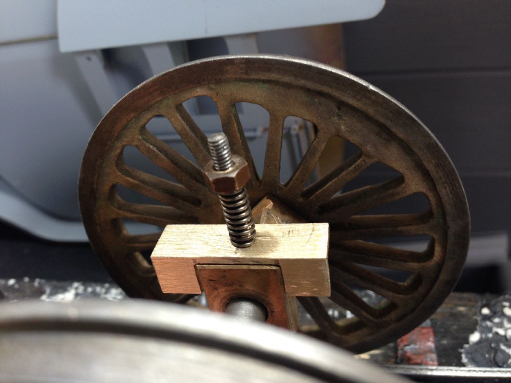

                                                  derek blake
                                                    @derekblake72550
                                                    Hi all
                                                    So abit more work on the flying Scotsman today, waiting on some more parts so thought I'd try and add abit of detail to the tender, nothing amazing or to your standards but it's something.
                                                    I also remade the keeps as the drawings asks for this to be made from angle brass, I would if expected steel but that's what it says and was good for me as I only have hand tools.
                                                    Thanks for looking
