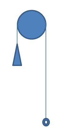

        @ajohnw51620
        It might be worth mentioning that in Russel's arrangement the winding barrels are usually screw cut to guide the wire carrying the weight. LH thread in a design I have seen.
        It's also possible to add a sort of "dummy" barrel to keep the weight well away from the pendulum if the gearings doesn't do that automatically. It might be put high up and to the left for instance.
        I'm trying to get my head around the escapement and weight on the end of the pendulum. It's too cold in my alternative work area currently to start chopping up al for a 3d printer frame.

                      It is usual to "screw cut" the barrel but not with the usual thread form. It should be half round to comfortably accommodate the line. I used the screw cutting facilities on my lathe with a half round form tool but the traditional method used by my ancestors would have been to cut it by hand on the lathe using a single point hand graver. That takes some skill to do neatly though!
                      As has been pointed out you can get away with a plain barrel but should be careful to angle the approach of the line correctly. If it gets wound with big gaps it will eventually bunch up at the end of the barrel and cause a variation in the driving force as a result of the variation in diameter.
                      Russell
                      #236106
                      Ajohnw
                        @ajohnw51620
                        I would have thought any thread form would be better than none Russel.
                        I have wound many close wound coils by using a sort of guide so that the wire runs neatly right up against the previous turn. Similar problem. To do it reliably the guide needs to be a significant distance from the coil that depends on the width of the coil. I would have thought this would be difficult to achieve reliably in a clock. For a coil say 2" long I would reckon on needing to put the guide at least a foot away. A jig I once made was more like 2ft long. Having found the problem I didn't want it to be too short.
                        On the design I mentioned the dummy barrel is also screw cut so that guides as well. It may be a handy arrangement to remember because as the re wind time is increased the diameter of the gear on the main barrel tends to go up which puts the wire closer and closer to the pendulum or the barrel size needs to go up as well. I would have thought that was a better option but designs I have seen tend to just increase the number of teeth on the gear. Odd really as a bigger barrel should give more driving torque for the same weight and even more drop of course.
