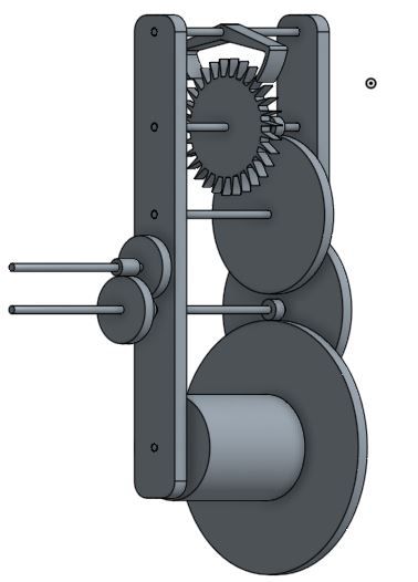

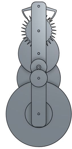

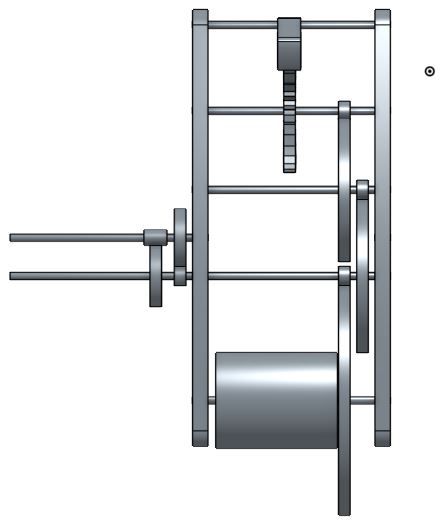

                        James A
                          @jamesalford67616
                          Thank you for all of the comments and suggestions to date. As yet, I am still undecided about a remontoire, but shall study them in more depth before deciding. Although it seems the simplest, I am not keen on an electric device, simply because I do not wish for the clock to be reliant upon batteries or to need plugging into the mains.
                          I have revised the design, using 0.8 mod as a compromise size between 1 and 0.6 mods. With 0.8 mod, the pinions are large enough for me to have a fair chance of constructing them as lantern pinions. Anything smaller and I doubt that I would have much luck.
                          I have decided to use weights in the end, not spring.
                          The attached drawings show the general layout, but the frames are simply representative, but finalised, as are the long arbours at the front.
                          I plan to use a one metre pendulum with a thirty tooth escape wheel. The tooth count and ratios that I have settled on, starting with the escape pinion are:
                          10: 75
                          10:80
                          10:30
                          8:32 (the hour wheel)
                          The wheel on the winding barrel is 120 tooth
                          Do these ratios and general layout look reasonable?
                          Next step – pendulum and suspension. Can anyone direct me to any links or sites which cover this area? I can work it out by studying other designs, but some advice is always a help.
                          Regards,
                          James.
                          Edited By James Alford on 20/04/2016 07:31:02
                          Edited By James Alford on 20/04/2016 07:31:54
                          Edited By James Alford on 20/04/2016 07:32:49
                          Edited By James Alford on 20/04/2016 07:57:45

                          Russell Eberhardt
                            @russelleberhardt48058
                            Better to move the winding barrel to one side to keep it away from the pendulum. Your pallets embrace 6½ teeth which is rather short. 10½ would probably be better.
                            Lots of different designs for the pendulum/crutch assembly. The usual suspension is a short strip of thin spring steel. Ready made suspensions are available.
                            I think the easiest escapement to make and adjust is the Brocot type.
                            Russell.
                            Edited By Russell Eberhardt on 20/04/2016 09:22:50

                                      John Haine
                                        @johnhaine32865
                                        Surely the pendulum, which is in line with the crutch and therefore the pallet arbor, is going to have to be behind the rear clock plate? So no need to move the barrel to one side.  This actually points up a problem with this design: the rear plate will need to be stood off the back board, and as shown with the long thin plates the pillars are going to be nearly on the vertical axis.  Usually you have a wide back plate so they can be set apart horizontally to clear the pendulum rod.
                                        Huygens endless loop is a good system but really needs a fine chain to implement it which is hard to find.
                                        On pendulums, there is a book by Robert Matthys called Precision Clock Pendulums which is very complete, if you can find or borrow a copy. Or copy the design from an existing clock!
                                        In ME a few years back there was a construction series for the "Repton Clock", written by Stan Bray I believe, and you could buy a material kit including gears and pinions. I wasn't impressed by the series as it included at least one egregious error which would have stumped anyobe following it which I pointed out at the time but was never corrected. I still have the kit which I didn't complete as I got bored with it (though I didn't get caught out by the error!). I was intending to fit a Brocot escapement instead of the anchor and made the new scape wheel needed but didn't complete the pallets.

                                              Ajohnw
                                                @ajohnw51620
                                                I don't see why winding should mean that the pendulum gets in the way as I assume it's mounted on a back plate and the movement mounted on that driving the pendulum in the usual way.
                                                One aspect I have picked up on various places relates to the train. 11 teeth manages to get 2 teeth active with a cycloid / lantern pinion arrangement. As that is not a nice number 12 is generally used. Or more of course if needed. Going on that 10 is a bad choice and doesn't gain anything over say the usual 8.
                                                I think that old book I linked to gives sufficient information to work out the escapement arrangement to get a given pendulum swing. It suggests 7 1/2 teeth on a dead beat and the drawings it shows look about right. It also covers others.
                                                I wont mention what the book that gives 2 designs uses as that would be unfair on the person that wrote the book.
                                                Harrison used a remotoire on his weight driven regulators using springs. It adds to the complications done that way as the power to the pendulum changes over a 15 sec interval – hence his cheeks each side of the suspension spring which were adjustable. A set of feeler gauges might be the best way of obtaining the steel for the spring as changing the thickness has an effect but more limited than the cheeks.

                                                John Haine
                                                  @johnhaine32865
                                                  Apologies of I didn't make myself clear. My point was that James' sketch shows all the wheels having their pivots in line on the vertical centreline of the clock, with long thin vertical plates. The pallet arbor is on the same line and so the pendulum neutral axis has to be also. It will be therefore hard to mount stand-off pillars on the top and bottom of the plates that can space the movement off the back board to clear the pendulum, which don't themselves get in the pendulum's way.
                                                  To clarify on Harrison's remontoire, the suspension cheeks are not used to compensate for the variation in driving torque from the remontoire, but in conjunction with the grasshopper characteristics in a complicated balance between (near) circular deviation compensation and compensation for barometric effects. The final adjustment of Clock B at the RGO required quite a lot of experimentation with cheek radius and spring thickness/material to get it right.
                                                  His remontoire has two functions: one to keep the driving force as constant as possible; the other to allow the scape wheel to recoil without the pendulum having to drive the whole of the train.
                                                  If "maintaining power" is desired to keep the clock going while winding, with modern components it should be possible to arrange a small spiral spring in the train, which gets wound by the weight torque and transfers it to the rest of the clock, with roller clutches to lock the "input" of the spring during winding.
