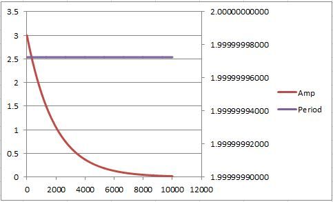

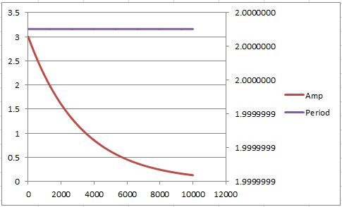

                                        John Haine
                                          @johnhaine32865
                                          Martin, again sorry to return to this. I'm spending quite a lot of time at the moment simulating Harrison clocks and it was easy for me to do some simulations. Here is the period and amplitude of a seconds pendulum with a Q of 5000, zero circular deviation, coasting down from an initial deflection of 3 degrees.
                                          The period remains within a gnat's of 2 seconds until the end of the 10,000 second run. It would be 2s except that the value of pi used in the simulation is only correct to 9 decimal places. Adding circular deviation gives this.
                                          Here you can see the period some microseconds short at the beginning but as the amplitude decays it rises asymptotically to 2s again. Here's a different Q of 3000 again with no circular deviation.
                                          Again the period is almost exactly 2s within nanoseconds and unchanging with amplitude. To the extent that the period does change actually it decreases with lower Q (i.e. increasing air resistance)
                                          You are correct that there is a very very small change of resonant frequency with Q but for most practical values of interest in a clock it is unmeasurable. It is much much smaller than circular deviation.
                                          #237579
                                          Martin Kyte
                                            @martinkyte99762
                                            No need for the apology John it's a discussion not a fight.
                                            Very interesting plots. From plots 1 and 3 (Q = 5000, 3000) you show a variation of about 2.6mS/day which would over 100 days be a little over 1/4 of a second and that is with a small swing so a lot less velocity and therefore friction. For Harrisons error budget of a second in 100 days even this is a quarter of his allowance.
                                            I totally agree that for all practical clock-making it's irrelevant but not to the boys who are chasing the ultimate mechanical clock (I don't include myself by the way). However for the synchronome the rate reportedly changes noticeably with the case door open from shut as the air is more constrained and less free to move out of the path of the pendulum when it's shut. (don't lets get started on bob shapes yet ;0) )
