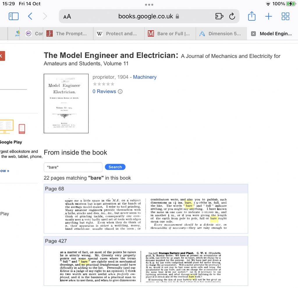

                                      I have just been a-googling for a couple of minutes, and found this
                                      The reference on Page 427 is particularly interesting [Mr Greenly, no less]
                                      … does anyone have that 1904 issue to hand ?
                                      Edit: __ the image quality is Google’ problem, not mine !744f1b62-9beb-4d72-be0f-e237918fc5f5.jpeg
                                      Edited By Michael Gilligan on 14/10/2022 15:50:31
