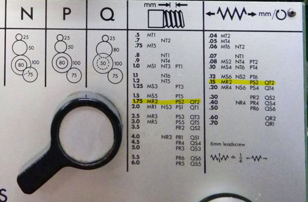

      Thanks Jason i use wd-40 as a lubricant i know it doesn't cool but helps cut.So you are saying 800rpm is to slow,why does it move so quick then is that normal for it to take about 4 sec to do 100mm

            Sounds like you have a very coarse screwcutting feed selected and are engaging the leadscrew half nuts rather than the feedshaft. The middle of your 3 shafts should be turning when cutting not the leadscrew at the top
            May also be you have a screwcutting gear train rather than a feed one which will mean the input speed to the gearbox is far too fast. You need to take off the end cover and see what gear train you have. You want one of the gear trains bottom left of the headstock charts

                  Howard, the input speed to the gearbox needs to be set with change gears for feed rates, there are three change gear options N, P & Q. You can then use the gearbox to get six speeds for each of those change gear combinations.
                  If the change gears are one of the combinations for screwcutting then the input to the gearbox will be far too fast and no matter what position the "joystick" is in the carriage will move far to fast.
                  I hope the lathe came with it's change gearsfrown

                      It's a Mk2 so different charts.
                      Here is why it is important to engage the feed screw for turning and not the lead screw.
                      On the left are metric screw pitches, on the right metric feeds. I've highlighted gear train "P" , 3 position knob in "S" and joystick in "2"
                      If you engage the feed shaft the carriage will move at 0.15mm per rev, if you mistakenly engage the leadscrew when you actually want to cut it will move at 1.75mm per rev. Now if you apply that to the 800rpm being used in 4 secons your tool will move 93mm in 4 seconds which is close to what Andrew says he got when it should have been a sedate 0.15mm/per rev which would have covered 8mm in the same time.
                      For feeds you should be using the lever middle bottom of the apron and for screw cutting the lever on the left of the apron

                        Thank you well at least i can use a 13 amp socket thats one thing sorted.As for cutting i always use the bottom middle and the same for the cross feed.I will check the change gears to see what gears he has been using.
