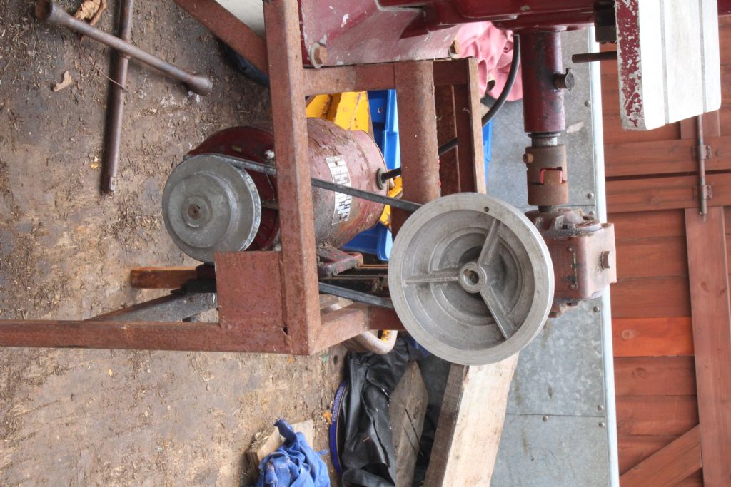

                            oldvelo
                              @oldvelo
                              Hi Plasma
                              You will need to slow down the band speed with a counter shaft or gear box. May I suggest you use Poly Vee Belts 6 ribs will be more than adequate for the existing motor. Pulleys are easily fabricated and capable of quite large ratios.
                              Use an idler pulley on the back of the belt to give the small drive pulleys to give a better contact area.
                              More can be seen in my album Bandsaw 2.
                              Eric

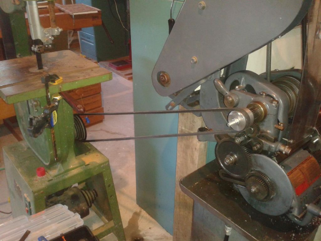

                                            Here are a couple of pictures of a vertical bandsaw I recently moved on to a new home, the previous owner had modified it to slow it down. Sorry about the pictures, they are upright on my laptop.
                                            Martin P
