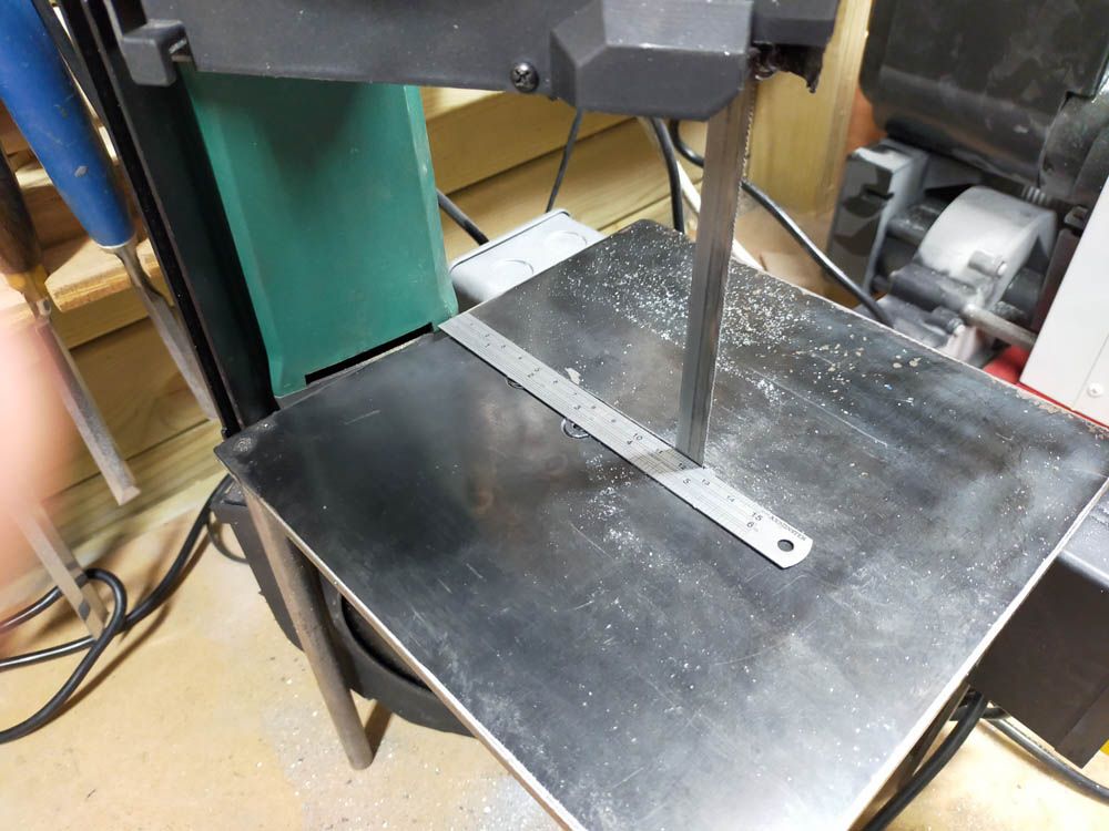

                                        I have a machine capable of 6” cuts which can be stood with the band vertical. I welded up a rough bracket to affix in the machine’s vise (often a weak spot on portable machines) and bolted a piece of 15mm aluminium sheet to the bracket as a table. It needs a corner support for the table but works quite well. I (nearly) always clean/square up edge cuts on the mill, anyway.
                                        Cost was about a fiver for the square steel tube and a few welding rods.
                                        15mm is plenty thick enough (likely excessive, really, but it’s what I already had in the workshop) to add slots for a fence guide. That likely cost me a fiver when I bought it.

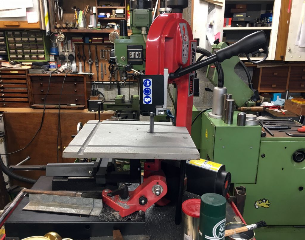

                                                    I have one of the smaller Burgess BK1 saws, and it works fine for sheet materials, but too fast really for sheet steel, even with the speed reduction kit.
                                                    My larger Emco 3 wheel saw is better built, but also too fast for steel, and well outside your preferred size.
