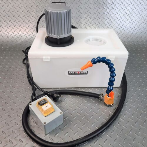

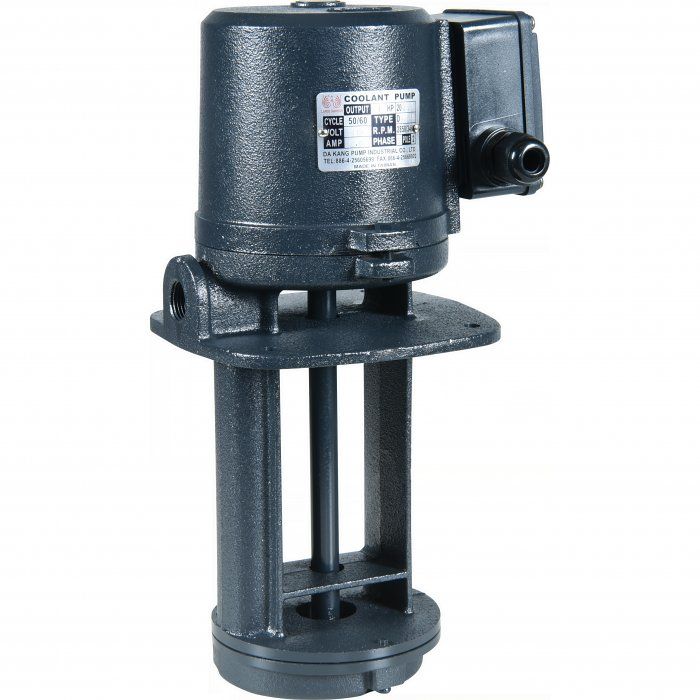

          Coolant pump that is used on mills and lathes.
          The tank has 2 compartments and the return coolant enters the first compartment. Solids settle to the bottom of the first tank with a magnet to attract ferrous metals. Liquid has to flow over a barrier wall to enter the second tank and pump. The motor is above the tank and away from any liquid and the pump below in the second tank. Motors are available single and 3 phase.

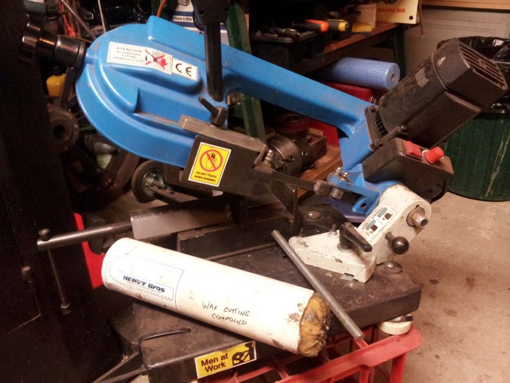

          I only have a small bandsaw for cutting metals and use a bees wax stick to lubricate the blade

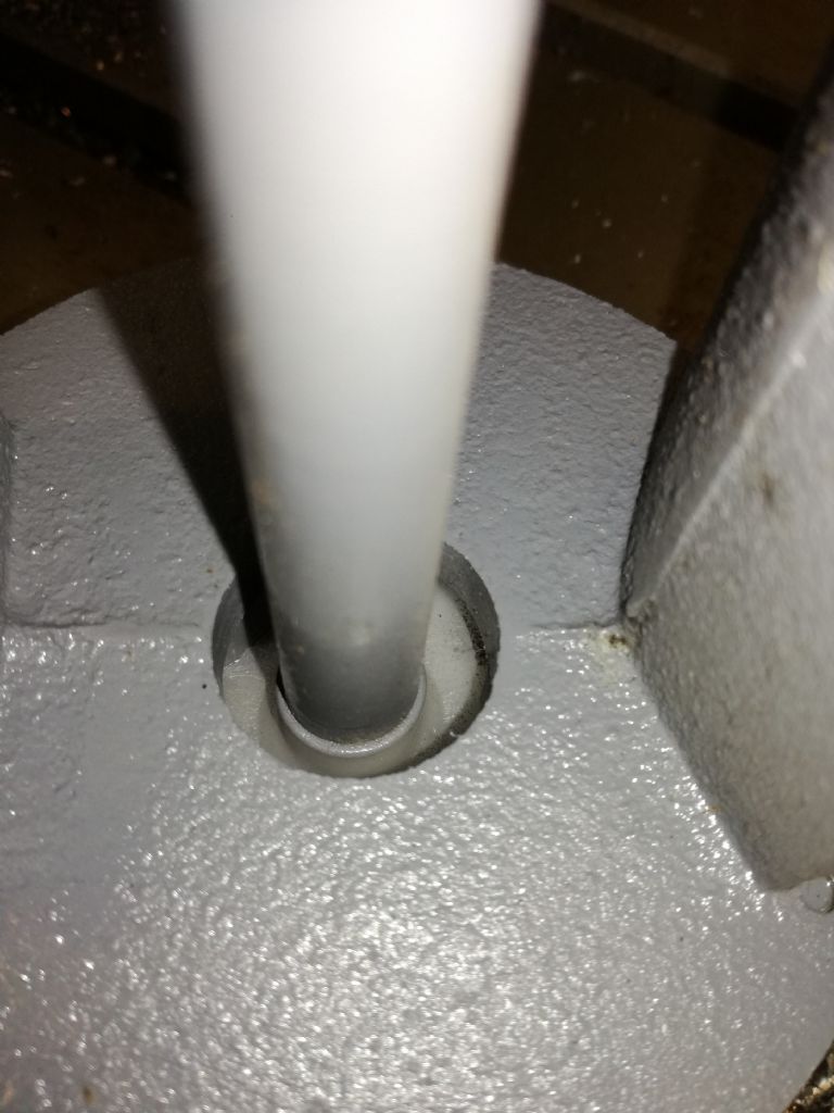

                          Hi, my Boxford lathe has a built-in suds compartment in the stand, which has a divider, the photo below shows that with a suds pump that Paul Lousick has shown, although I've never fitted or wired it in, I can't remember how much it cost though.
                          The best thing about these pumps, is there is no shaft seal to wear out or leek, and the impellor has enough clearance to tolerate small particles without damaging it.
                          They will also let you know if your suds is getting to low, as they will stop pumping without damaging the pump.
