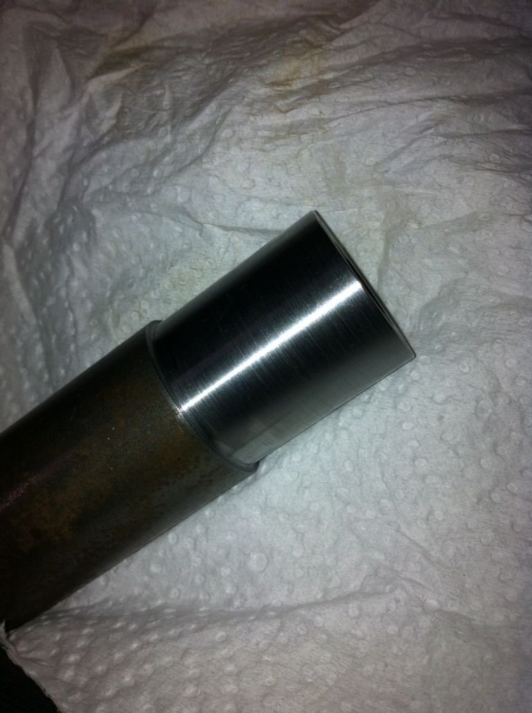

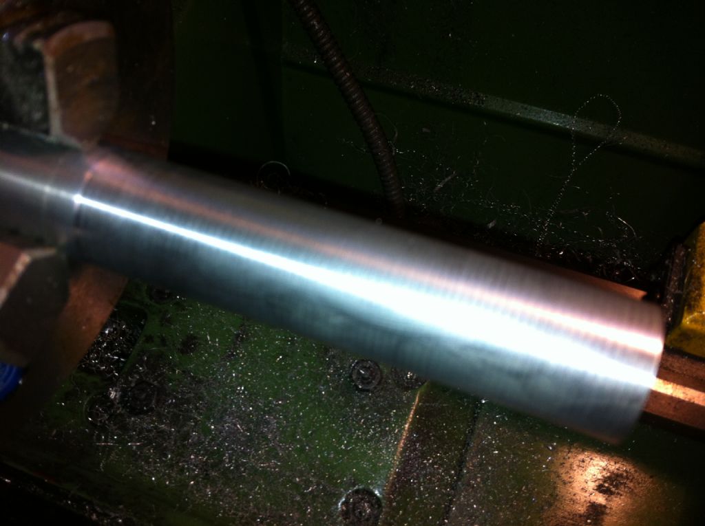

      Here you can see what I am getting….
      It is not good…
      The history of the lathe that I have is this. It was a 'bargain basement' purchase at a Warco open day around two years ago. This was sold to me with a story of another supplier selling lathes and offered to Warco – they declined as they have good relations with their current supplier and didn't carry on with the new supplier, this was the lathe that was left with Warco.
      I didn't use the lathe for some time (about 1 ~ 1.5 years) as not long after I took delivery of the lathe and mill I suffered with back problems. This meant I couldn't stoop down to use them. Now I am trying them all out and sorting out any issues which may or may not always come with this type of purchase.
      I have checked and tightened all gibs with little or no readings from my DTI on checking. The only reading I get is when I place a clock on the lathe chuck and lever underneath this and I get around 0.01 to 0.025mm deflection. I don't have a manual as such for the lathe so I am unsure of the allowable limits in the headstock bearings.
      The lathe is a FC3200 from RiPu manufacturing, I have tried to contact these and other suppliers of the same lathe about a manual, but don't get any replies. The lathe seems to be exactly the same as this one here – **LINK**
      Any advice or help would be greatfully received.

          Hi Andy,
          We see a lot of pictures like that on this forum.
          First check, is the spacing of the bands the same as the pitch of the leadscrew?

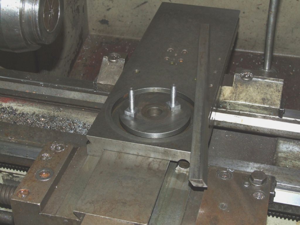

                  To follow up on your question in another thread; by worn bolt I mean that the threads were pretty much stripped, so the bolt wasn't doing much. Here's a picture of the banding I was getting on silver steel:
                  Silver Steel Banding
                  The banding was actually a multi-start 'thread', difficult to tell how many, but certainly around 6 to 8 start. There didn't seem to be any obvious correlation between spindle or motor speed. I run from a true three phase supply, so no issues with single phase motor vibration. My lathe has a dedicated power feed shaft, so no issues with the leadscrew either. Here's a picture of the new bolts:
                  T_Nuts
                  Getting the compound slide clamped down properly cured the banding problem.

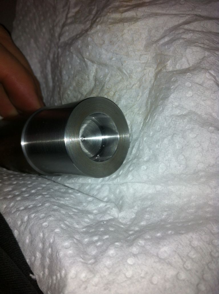

                              Correct Andrew, exactly that.
                              This is what I now have…. a piece of EN1A lying around.
                              Outside diameter…
                              and bore…
