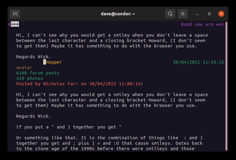

                  Of course all us Internet veterans disapprove strongly of dreadful modernisms like graphical screens and mice. Back in the day, real computer men didn't have any of that namby-pamby wet-worm technology that today's snowflake wimps can't do without. It was character forming! The internet worked on text terminals paging 24 lines of 80 characters each, in any colour you liked as long as it was green. Or a teletypewriter, about 50 characters per second flat-out, plus ear defenders.
                  Here's what the forum looks like in a proper browser (lynx), albeit in shocking Technicolor, which we knew at the time would never catch on:

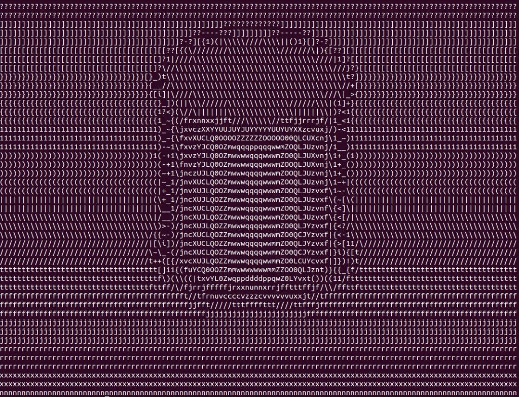

                  As for images – here's the FreeCAD cotton-reel, done properly the old-fashioned way!
                  Maybe the internet is better today, but I shall never admit it!
