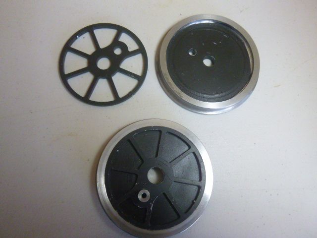

                  tom hardy
                    @tomhardy75463
                    hi luker
                    news from the builders in west australia photo of wheels constructed by clive chapman. discs where cut from 1045 steel and recessed .spokes were cut from 4mm steel sheet by a laser cutter. the spokes are a neat fit and held in place with small grub screws . loctite would probably be ok
                    #585432
                    Luker
                      @luker
                      Hi Tom,
                      Those wheels look very good! Small grub screws will work perfectly; just don’t push the spider out when pressing the axels home. Some of the guys here build their wheels from laser like you have; then silver solder the lot up. Clive has forgotten the counter balance, it doesn’t add that much weight but is very period specific for these ‘ribbed-disk’ wheels. If you drill one or two blind holes and pour a little lead in there you’ll end up with better balanced wheels than mine.

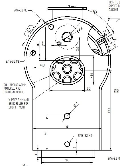

                        hi luker we need some more measurements for the boiler drawings so our boiler inspector can draw up plans for a copper boiler shell overall and firebox widths
                        regards tom hardy west australia
                        #594451
                        Luker
                          @luker
                          Hi Tom, this should do it. You shouldn’t have any issues converting the boiler design for copper. Just check the stress in the crown area if you remove the crown stay for rod stays (Aus boiler code). I’ve found the code is a little light in this area… (see: Modern boiler construction methods for the model engineer)

                          tom hardy
                            @tomhardy75463
                            hi luker
                            thanks for the drawing i still need the sizes of the main barrel and firebox barrel so it will fit into the loco
                            tom

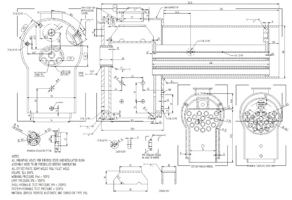

                                    Hi Tom, here is an exported JPEG of the boiler GA, I’ve added two views that should give you all the dimensions you were looking for. If I’ve missed anything please let me know and I’ll update the drawings and post them on the forum. I did have a look at the design and I do need to point out that this design was specific for stainless, and although not difficult, would require some re-work to make it suitable for copper. Items like the lower gauge glass position and steam volume are specific to the top of the crown and for copper this is where changes will be needed. If not done correctly it will affect the performance of the loco.
                                    The water space between the wrappers also needs to be checked for copper to make sure you won’t get steam jacketing especially with nominal calcification. Counter intuitively the stainless boilers outperform copper boilers due to this and other factors.
