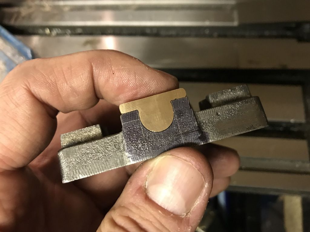

      Posted by Mick B1 on 14/05/2020 19:21:19:
      Posted by Dr_GMJN on 14/05/2020 19:01:03:
      I spoke to Ketan this afternoon about the cutter, and he assured me it was the correct geometry.
      I might do a quick test on a differnent material later on, but since I should have ordered something smaller it doesn't really matter that much.
      I really don't think so.
      In your photo I can see a clear sharp breakaway between the radius end and the cylindrical portion of the slotdrill, and this is visibly matched in the profile of the slot you cut in your piece of alli. It looks to me as if the end rad is 1/4" or more when it should be 7/32" and run smoothly – tangentially as you said – into the cylinder part. I think it's clearly wrong – as I said, it looks like no other ball nose slot drill I've seen in 45 years.
      Look up ball nose slot drill in Google Images and tell us if you see one with the clear edge between cylinder and sphere that you have on yours – I didn't..
      Edited By Mick B1 on 14/05/2020 19:28:13
      Mick – I know what you mean; you're making the same observations I did, although it's very difficult to tell the actual geometry of the cutter becasue the profile is projected on a helix. The geometry of the resulting cut is what it is, and plain to see.
      Ketan told me the cut geometry may be different in other materials, but that the cutter geometry (or profile or whatever) was no different from any other manufaturer. At least that's what I understood. Seems like a very decent & helpful chap, so I'm happy to take his word on it.
      If I was so inclined I could get the cutter geometry fully analysed and evaluated at work, but at the end of the day I've ordered the wrong thing anyway, so it would be a bit pointless!

        Well, I'm even more surprised now to hear this from Ketan. Unless the material behaves weirdly, like perspex or something, closing up after the cutter's passed, the profile of the cut is within practical limits defined by the profile of the cutter. You'd think to get much the same result in Delrin, brass, steel or titanium. Even if there were significant spindle runout with a properly-profiled cutter, what you'd expect that to generate is an oversize slot with a flat at the bottom, not what you got.
        Getting back to the fit of your bearing extrusion in the casting; if it's a sloppy fit, only the studs and nuts will be defining the location, and that's not normally regarded as adequate because of indeterminate clearances. Ideally you'd look for an accurate fit and line-drill the bearings square to the piston rod centreline to make sure there are no tight spots. I think I had a few on my 10V when I made it , but a minute or so's run-in with an electric drill chuck on the crankshaft end got rid of it completely. Now I can run the engine just by blowing into the inlet tube. I don't know, but I've a feeling the bearings just fitted the cast slots with minimal filing in my case.

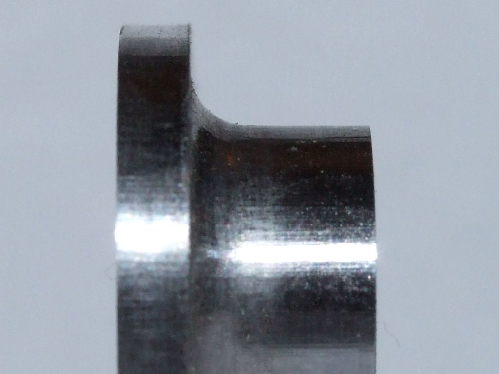

              Posted by Ketan Swali on 14/05/2020 21:02:23:
              How the shape compares to the 'premium endmills – HSS or carbide' which we sell, I also don't know,…….

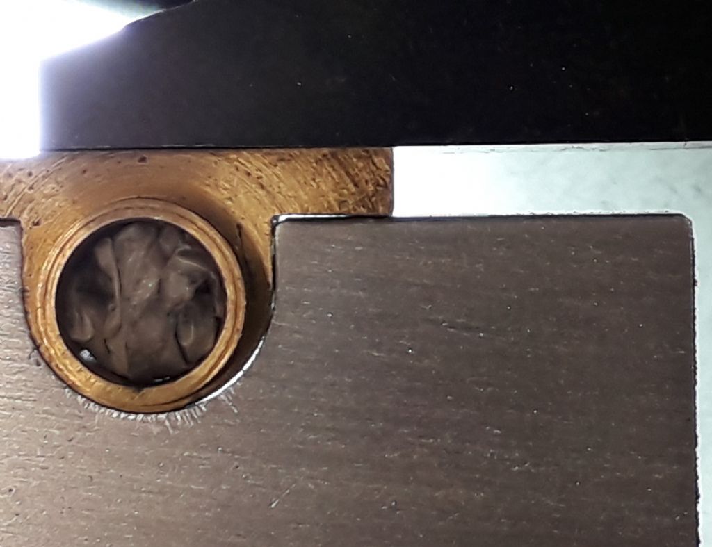

              I can tell you that. This is a picture of the part I showed previously, but taken as near along the straight top edge as I could:
              The cut was done on a CNC mill using an Arc carbide premium cutter. The curve looks to me to be pretty darn close to a perfect quarter circle, as it should be. So the premium cutters are correctly ground, the budget ones are not. I definitely won't be ordering any budget cutters. smile
              Andrew

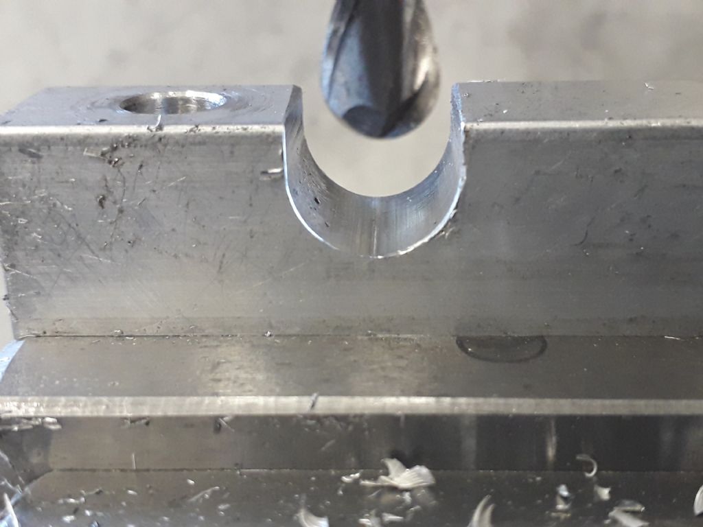

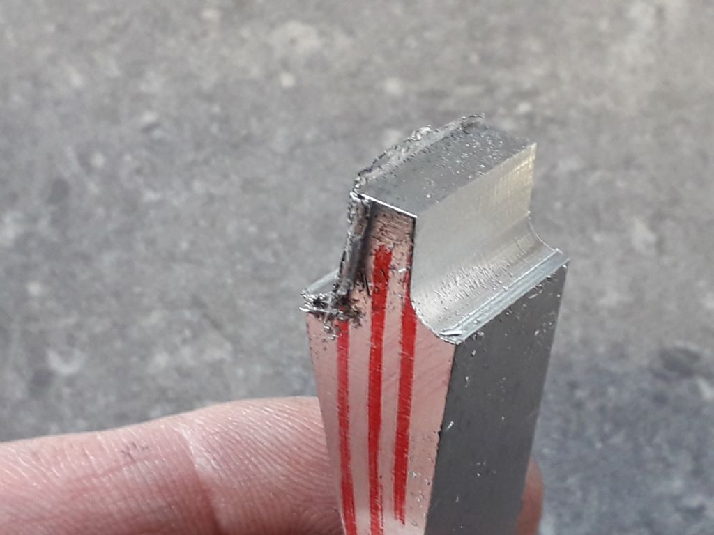

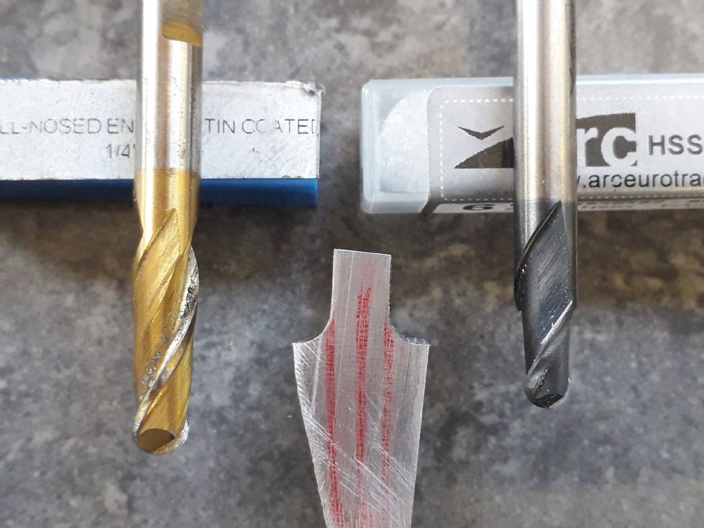

                          While waiting for one of the 7/17" cutters to come from ARC I thought I would try out the 1/4" one that I have had for some time, it's showing it's age but good enough for a back to back comparison with a 6mm HSS one from ARC's premium range.
                          As you can see the vertical face flows nicely into the curved so it may well be just the 7/16" cutter that may have the odd shape and I can't imagine that being a fast seller so could explain the lack of others having an issue as I expect 1/4, 3/8, and 1/2" are far more popular.
                          regarding the Doc's other post where it has been suggested that his cutter may be blunt it is worth comparing teh cut straight out of the mill and how they cut. The ARC one is as I said past it's sell by date and with the 8mm approach (height) it tripped the X3's cutout trying to take 0.5mm DOC so had to use just 0.25mm and it did not sound happy. On the other hand the nearly new ARC Premium was happy taking 1mm DOC and would have done more. The tell tale burr thrown up by the cutter is another indication of it's blintless compared to the clean edge left by the sharp cutter.

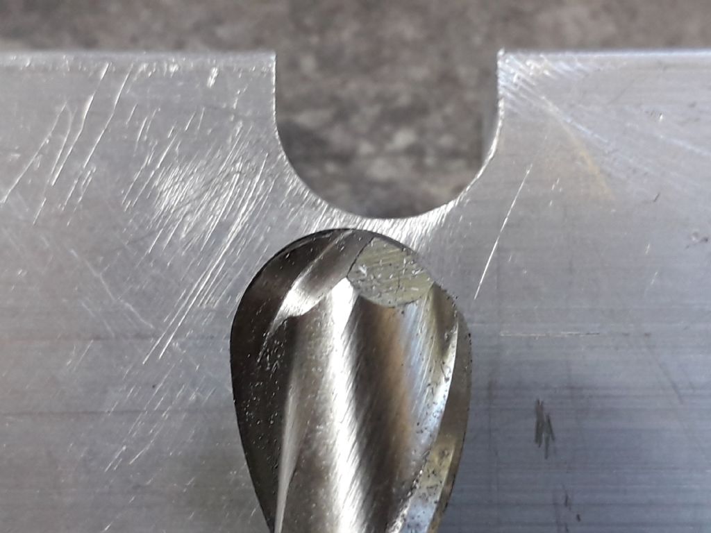

                            Trying to replicate your test with my 7/16" cutter (in aluminium).
                            For me, personal non-expert opinion, the cut shouldn't look like that.
                            But…I don't want to get into some arguement about it. That's just my opinion. I will be interested to see your results.

                              I don't believe any legitimate argument is possible. Ball nose means what it says – it should sweep out half a sphere plus any tolerance of cutter diameter and runout, and that implies that the radius should blend to the cylinder without sudden corner. There are plenty of conditions where ball nosed cutters are required to generate such a radius-bottomed slot, of which the 10V's bearing mounts are just one clear example.
                              Looking at your first cut, that isn't what yours is doing. Vertical deviation or movement would only put the corner at a different height, and horizontal would only make the slot wider and create a flat or shallow inverted vee at the bottom without effect on the corner. Your most recent pics don't show that condition so clearly – are you using the same cutter?

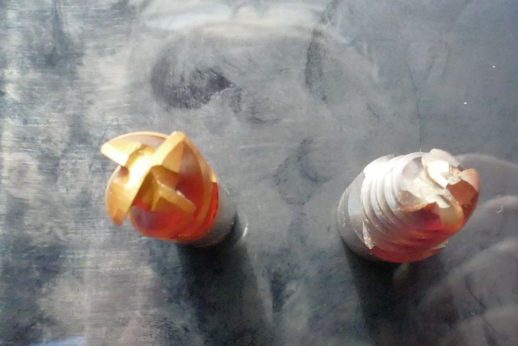

                                    Ball nosed cutters are a bit of an oddity. The cutting edge on the axis of rotation has an effective speed of zero and so to some extent scrapes its way through the material like a plough. Any lack of stiffness in the set up will result in unwanted movement from the forces involved. I think you are trying to do some cutting operations that will test your experience. If you get a cutter with the equivalent of a four facet grind on it the forces are lower but I think the cost will be higher.
                                    This photo shows the difference between a simply ground ball nose and a more expensive type.
                                    Ball nosed cutters

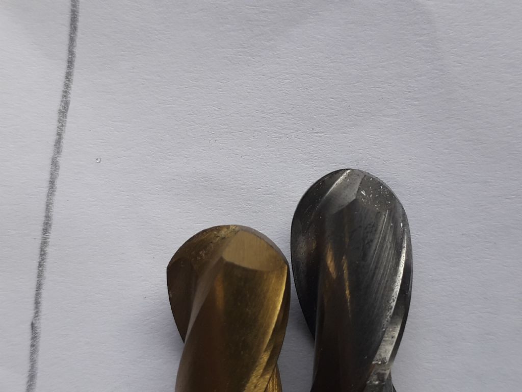

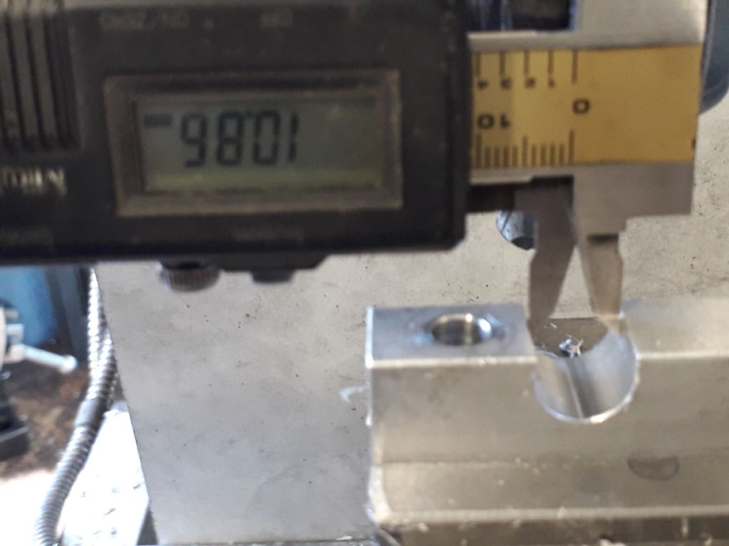

                                              The Results are in!

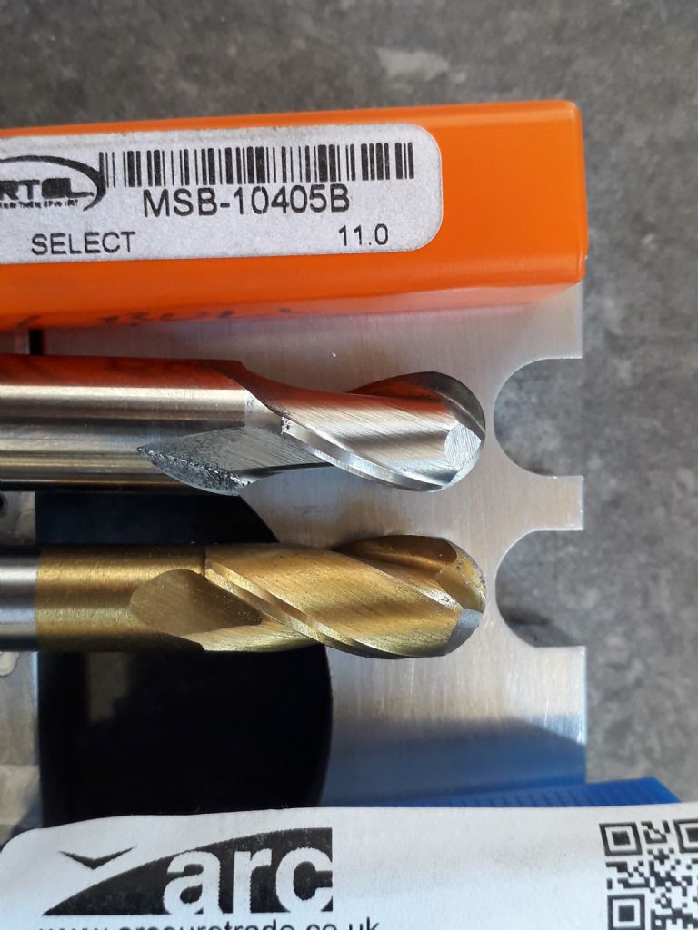

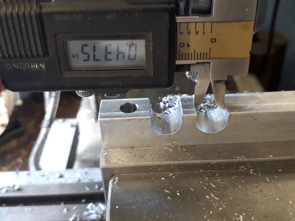

                                              While waiting for the sample cutter to come from ARC I did a test cut using what turned out to be an 11mm Hertel one though marked as “Select” which is an MSC brand.
                                              Cut taken to depth required for the Stuart extruded bearing, possibly a very slight “step” where the curve meets the sides.
                                              This measured 10.86mm wide
                                              I cut a little more off each side so that the bearing would fit and this is the resulting slot and cutter which looks to smooth transition from the curved end to the sides though the slot still shows that slight “step”

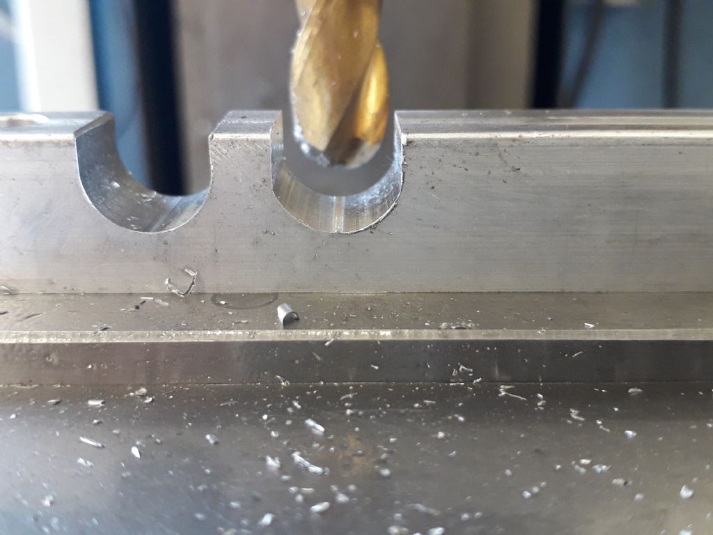

                                              On opening the package from ARC it was easy to see that the cutter looked to have a more prominent “step” just like the one the Doc posted so I had not been sent a special one.
                                              A test cut confirmed that the cutter produced a slot with a marked “step” in comparison to the one cut previously
                                              Though it did cut bang on width
                                              A closer shot of the two slots and the cutters
                                              So in conclusion the 7/16 Tin coated one from ARC does not give the shape one would hope for and even the other make has a slight Step. Ketan said to me that it looks like others in the range are likely to show a “step” to some degree.
                                              It is interesting to think that ARC have sold a good number of these and the US market considerably more yet this is the first time the issue has been raised, I certainly did not have any issues with the smaller ¼” one that I have had for quite a while, maybe it is just a bit more noticeable on the larger sizes.
                                              J
                                              Edited By JasonB on 20/05/2020 20:14:24

                                                Thanks for doing that test Jason. Is there any chance you could check runout on the ARC tool, above the flutes?
                                                I got another mill from Cutwel (11mm), and that is also ground differently, with a tangential radius-flat. There is no change in profile as you turn it and look in the region of the transition. The ARC version always has the step no matter how it’s viewed; I thought at first it might be an effect that might not translate to the workpiece when rotated, but apparently not.
                                                At least I now know it wasn’t some effect caused by my technique (or lack of it!).
