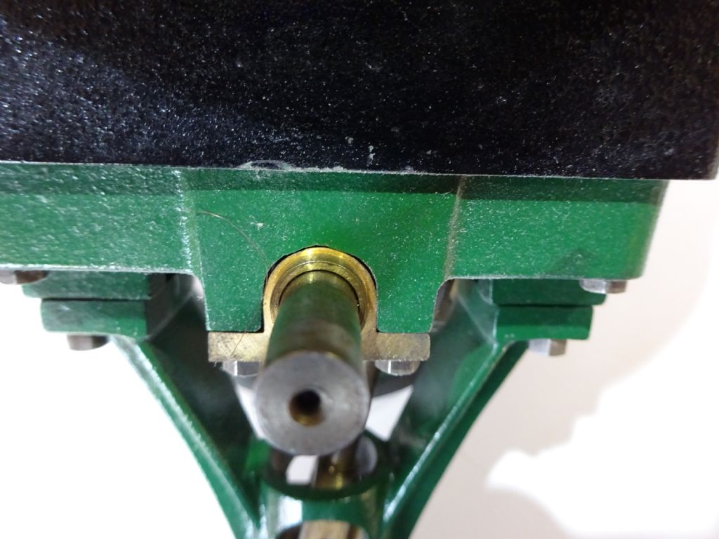

      I just started building the Stuart 10V, and I bought a 7/16" (0.4375&quot Ball Nose end mill, with the intention of using it to make the 7/16" wide slots for the main bearings, as specified on the drawing. The brass casting supplied is actually a bit smaller than 7/16", at 0.4285" wide. The cutter itself measures approx. 0.4350" according to my verniers, and made the same width slot in some aluminium I used as a test:
      However, it appears that the radus of the ball end of the cutter is not tangential to the flanks:
      It's quite prononced. I cut the test slot to the correct depth, and this is the fit I get with the brass:
      Although it's not necessary for a perfect fit, I Think I could have done significantly better with a file.
      Apart from "so use a file" – any comments on the best way of doing this? I'd like to use the mill seeing as I've got it, and assumed a 7/16" Ball Nose cutter would have at least given me the right shape.

          Bull nose cutters do not have an accurate radius as you have found. A better radius would be achieved by using the side of the cutter and machine from the side of the work. Use a cutter with a slightly smaller diameter than the slot will allow you to open it up to the correct width. (the radius would not be purfect but better that using the tip of the bullnose).
          Another option is to use a cutter which is the width of the slot and cut from the side of the cutter. (the buttom of the slot will be a purfect radius) and make the bearing to suit the slot.

            Hard to tell from a photo but it does look as though you have a 7/16" diameter cutter but the radius is greater than 7/32". Maybe check with your supplier if another radius is available. Otherwise try a cutter from a different supplier. Maybe talk to Tracy Tools and ask them specifically about the radius on their ball nose cutters.
            Your plan to line ream the two bearings after assembly seems sound to me.

                  Just looking at the cutter one can see that the end is not a full semi-circle. All my ballnose cutters are semi-circular as far as I can tell. I use them a lot on the CNC mill and the parts wouldn't be right if the cutter wasn't semi-circular. All my cutters are professional quality; including the Arc premium range.
                  The filleted profile on this part was CNC machined with an Arc premium range 5mm ballnose cutter:
                  I wouldn't have machined the slot with a ballnose cutter, but would have gone in sideways with an endmill.

                            +1 for this. I don't think I've ever seen one with a radius as far out as the one in your picture. Its box calls it a ball nose, which plainly ought to mean a full hemispherical rad. A thou or so out of round on the rad is one thing, but yours is clearly not what it's supposed to be. I'm surprised, because when I bought from Arc they took real care to make sure the goods were right.
                            The alternative ops described above are fine – I did my 10V so long ago I can no longer remember how I did those slots, though if I'd used a 7/16" ballnose I'd still have it. – but you should be able to use your ballnose for the legitimate purpose of cutting a slot with that radius at the bottom. I'd ask for an exchange or refund.

                                              True, but it's best not to assume anything. For example in this photo, the rounded part of the slot doesn't look symmetrical to me. What would cause that?
                                              Could be a camera artefact. If not, even if a ball-nosed cutter isn't round, it should cut equally both sides, provided everything is rigid and straight. But in the real-world, perfect rigidity is hard to achieve especially on a small hobby mill. Slightly odd shaped slots will be cut if anything moves even slightly, and this might happen in this example because one side (I think!) is conventional milled while the other is climb milled. One side of the cutter experiences more force than the other. It might be enough to move the work in the vice. Or, if the quill is fully extended (which maximises leverage), or the gibs are loose, the cutter may move off track or bend.
                                              Just a suggestion, your problem might well be the tool. But when I started cutting metal I unfairly blamed lots of problems on my tools. Then I found my junk box was full of poor materials. Once I got a feel for my machines cutting decent metal, it turned out most of my difficulties were, ahem, me! Now I rarely break taps. Drills, cutters and saws last longer, holes are straight, finish better, and I get accurate results faster with fewer mistakes. In the early stages I found having to think about absolutely everything made it hard to see the wood for the trees. It was only after I got enough experience to subconsciously do stuff like locking slides that my tools suddenly turned out to work rather well! Some talented people learn faster than others and seem to have a natural feel for tools from day one. I'm not one of them, and have probably made every mistake in the book!

                                                  I spoke to Ketan this afternoon about the cutter, and he assured me it was the correct geometry.
                                                  I might do a quick test on a differnent material later on, but since I should have ordered something smaller it doesn't really matter that much.

                                                    In your photo I can see a clear sharp breakaway between the radius end and the cylindrical portion of the slotdrill, and this is visibly matched in the profile of the slot you cut in your piece of alli. It looks to me as if the end rad is 1/4" or more when it should be 7/32" and run smoothly – tangentially as you said – into the cylinder part. I think it's clearly wrong – as I said, it looks like no other ball nose slot drill I've seen in 45 years.
                                                    Look up ball nose slot drill in Google Images and tell us if you see one with the clear edge between cylinder and sphere that you have on yours – I didn't..

                                                      Thanks Dave. I think in the image, the brass casting is displaced to the left slightly, and the depth of the slot is such that the radius wouldn't be concentric even if the brass was central. In other words the slot isn't quite deep enough.
                                                      There's no doubt though that there isn't a smooth transition from flank to radius – at least on the resulting cut in aluminium. I'll try it on some other material if I get chance.
