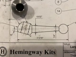

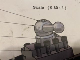

        Hi all.
        Ive recently made a Hemingway rear toolpost and it calls for a ball ended handle for the lock.
        As a result, I’ve now recently finished a Hemingway ball turning attachment which works.
        So on to the question: how do I machine the tapered handle with a ball at each end? Maybe three parts? Maybe 2? Maybe 1?
        Looking for some guidance.
        Thanks all
        #509048
          First you need to make a ball turner as so starts the slippery slope.
          If you use a ball turner to form balls on either end of a length of round bar that makes it easy to hold. You can then hold buy one ball in a collet or split bush and support the other with a female ctr in the tailstock to turn the central taper. It would probably be best to drill and thread the hole before that while you have the plain shank in the middle to hold. Finally screw the large end onto a threaded arbor to turn the top and bottom faces flat.
          #509052
          Jim Beagley
            @jimbeagley46363
            I’ve got the ball turner Jason – see my post and the lovely ball in the photo
            So reading your response, I note that I don’t have a collet chuck, female centre. Bugger!
            I supposed I can make a slot Bush easily enough.
            So I’m thinking these steps.
            Turn small ball.
            Turn centre section to max diameter.
            Drill and tap hole using centre section on Blocks.
            Turn Taper?
            Turn big ball using female centre in small ball.
            Face big ball using arbours.
            Sound about right?

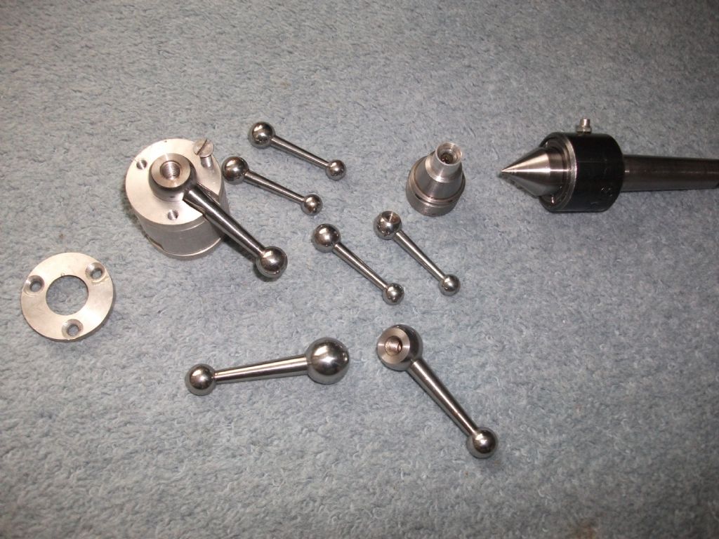

                        I've made a number of these ball handles for various toolposts and a teeny one for the Versatile Dividing Head, simply because they look the part on my vintage Drummond and Myford lathes. The later styles as above are easier but stand out like the dog's proverbials as non-original. Besides, the ball handles are fun to make. And I have have no problems using them, not doing 8 hour shifts of production repetition work etc. .
                        My method needed no special split collets or the like and went, from sketchy memory, something like this:
                        Start with a blank the diameter of the large ball, and the length of the finished handle plus a few thou or 20 for finishing.
                        Turn one end of the blank down to the diameter of the small ball for about an inch or so along the length.
                        With a parting tool, cut a groove to the diameter of the small end of the taper section (plus a few thou for finishing) right where the edge of the small ball will be. (You can probably skip this step if you work carefully in the next step and measure as you go but I like to know where to stop the ball turning tool at.)
                        Use ball turning tool to create small ball until it meets the groove.
                        Turn the shank down to the larger diameter of the taper section along its full length to where the large ball will start. IE for a 1" diameter ball, end your cut 1" from the end of the blank, plus a few thou for finishing. You may need a female centre to steady the other end.
                        Flip the job around in the chuck, gripping it by the freshly turned down but still parallel shank section, and use ball turning tool to create the second, larger ball.
                        Holding the larger ball in the chuck (with protective shim wrapped around ball), and the small ball in a female centre, turn the taper on the shank, adjusting the topslide angle until you get the right cut from small to large ball. Use a round-nosed tool to make a nice blending radius where shank meets balls. Blend with file if necessary. Polish with emery cloth.
                        Hold the large ball in the chuck with the arm facing outwards. Put the ball in the very front of the jaws and angle the arm backwards so small ball sits on chuck face. Face the large ball to desired diameter, drill and tap ball. (This works best on a larger chuck for larger handles to get sufficient angle on the handle. My Drummond has a 5" three jaw that is perfect for Myford sized toolpost handles etc)
                        Job's good. Enjoy.
                        PS, I made my own female centre by removing the point from a regular revolving centre and turning up my own female tip to fit into the ball bearing in the centre body. Just used a boring bar to cut the female conical face (60 deg included angle) into a piece of 3/4" bar then turned the step, face and the spigot diameter to fit the bearing all in one setting to ensure concentricity and parted it off. You could turn the stepped spigot end first, plus a cleanup cut on the OD then flip it around in the 4 jaw and set to run true before cutting the conical face if you prefer.
                        Lots o' fun! And I;m sure there are many other ways to skin this same cat.

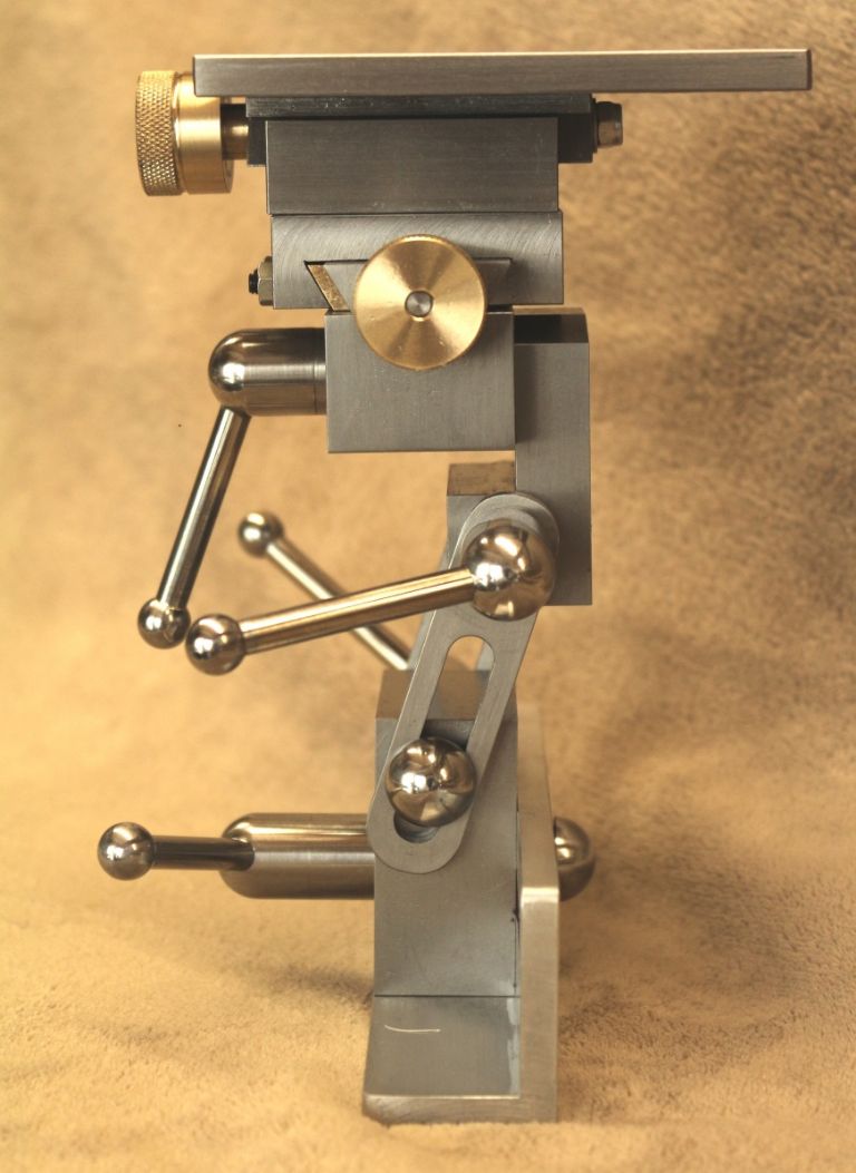

                                I recently had a need to make some handles for Harold Halls t n c grinding jig. His design is just like Andrew Johnston's above, except that HH adds a short length of larger dia. bar to the outer end in lieu of the small ball in the ballsup design. The smart way of doing that is to drill the larger dia. bar only part way thro., enough to hold on to the smaller dia., leaving say 2mm blind section before the part off. Reverse in 3 jaw, face smooth round off sharp corner,drill very small dia. hole thro. to bigger drilled hole. Super glue larger dia. on to the end of the smaller dia. and air/excess glue exudes thro. very small hole. Simples! when having made parts without very small hole and find close fit precludes escape of air/glue.
                                In passing, may I congratulate HH upon his meticulous drawings; not quite completed my jig yet but not found a single error. They are a delight to use. Pity same couldn't be said of many loco. designs

                                        With due acknowledgment to Harold Hall and his design at : Grind Rest, Advanced (homews.co.uk)

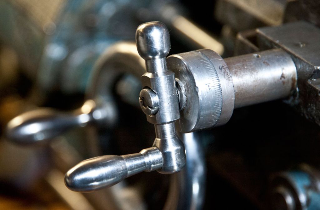

                                          The first turning job I ever did when I inherited this lathe was to make a new cross-slide handle from stainless steel. The firs lathe project in 55 years. The plan was just make something that works. It doesn't have to look authentic.
                                          I like the way it feels but it is not balanced. Unless the gib adjustments are tight the handle drops down to the lowest point due to gravity. So that's what the balls are for. I knew there was a reason we have balls! Gravity. So now I am thinking I have to make a bigger ball, like the song "I like big balls". Maybe if I made it from solid gold it would be heavier.

                                                I hope I may be forgiven for a slightly off-topic post. Well, it is to do with handles.
                                                In the background of Evan Lewis' post you can see what I describe as a 'tear-drop handle'. Somewhere on the Internet there is a video of one of these being turned using a form tool so arranged that only part of the tool is in contact at any time. If I remember correctly, the top-slide (aka 'compound' ) is set at a slight angle to the cross-slide and is mechanically driven. Again if I remember correctly, the technique is named as 'skiving' (until I found this video I thought that was the process for producing a thin sheet of leather, such as is used to surface a bureau writing flap) .
                                                I found this video fascinating but my recent searches for it have been unsuccessful!!!
                                                Maybe one of the members here is familiar with either the video or the machining technique or both?
