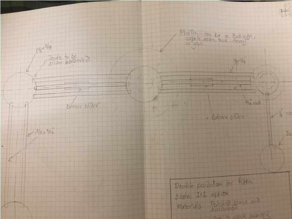

                                              Thanks for replies.I'm not sure if my question has been answered though, probably because I didn't frame it clearly enough. My bad. After further thought I'm pretty sure that all other things being equal a large diameter bearing will dissipate more energy through friction than a smaller one. That's assuming that bearings can be characterised by a single (velocity independent) coefficient of friction, as with sliding surfaces – which surprised me at first, but I think I now understand.
                                              MichaelG – thanks for the links. It may take me a while to get my head around that stuff . The Unipivot designers claim that their arrangement is 'extremely damped' which may not be what I want.
                                              This is a rough sketch of what I'm proposing:
                                              Yeah, I'm no good at technical drawing, it's just an aide-mémoire . The whole thing pivots about the central disc, and the secondary pendulum about the disc on the right arm. Something I have found when making prototypes is that the bearings need to be 'tight' in the sense of keeping all the moving parts coplanar. Any wobble and parasitic vibrations set in which sap the energy surprisingly quickly. I guess there is a trade-off between that and friction. I imagine people making Stirling engines must face the same sort of challenge.
                                              Robin.

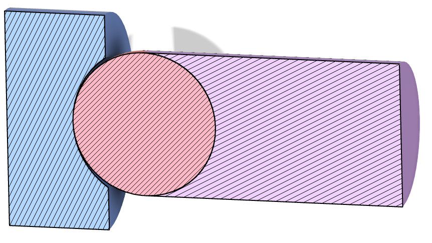

                                                    Gary Wooding
                                                      @garywooding25363
                                                      What about something like this…
