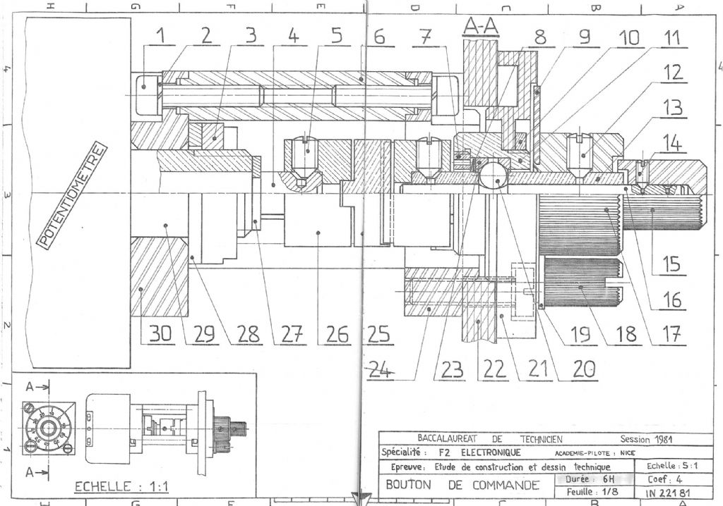

                                                  jacques maurel
                                                    @jacquesmaurel42310
                                                    Hello Neil
                                                    Here is a blue print copy of a 1981 exam for driving a potentiometer.

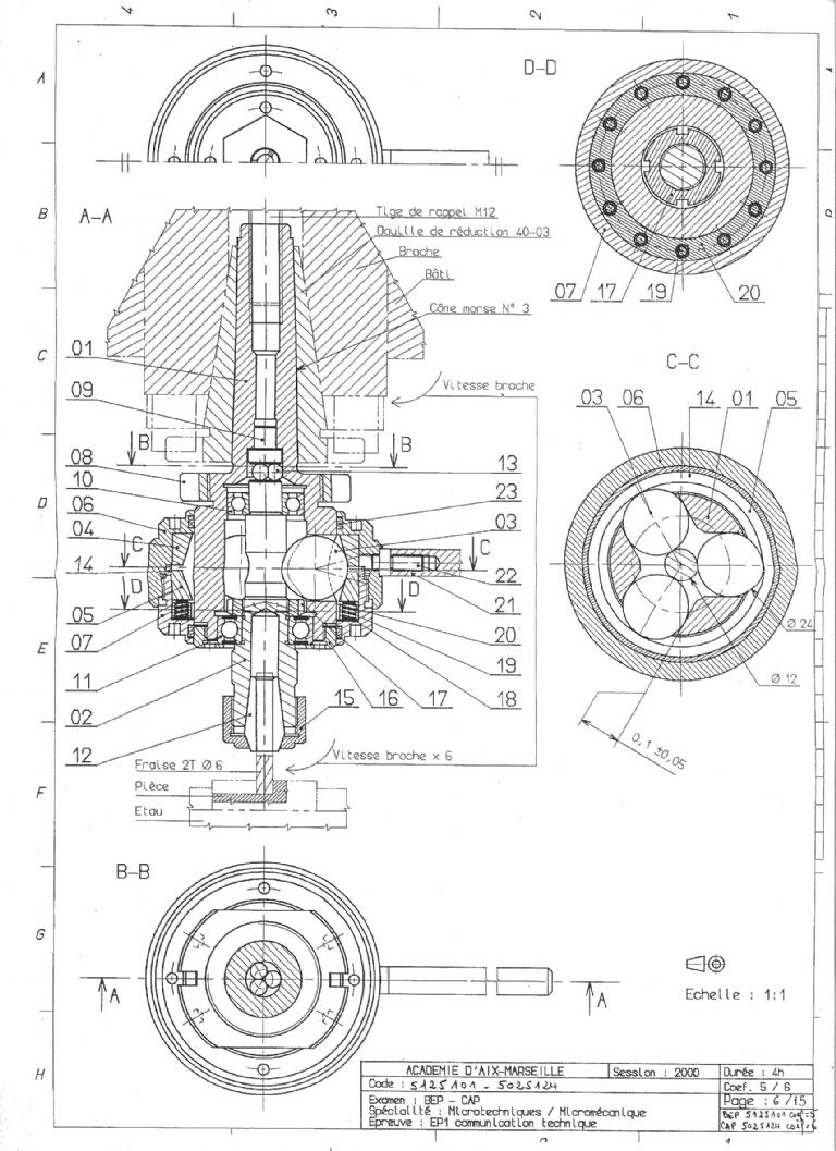

                                                    jacques maurel
                                                      @jacquesmaurel42310
                                                      Now a mulltipliying spindle using the same mechanism.
