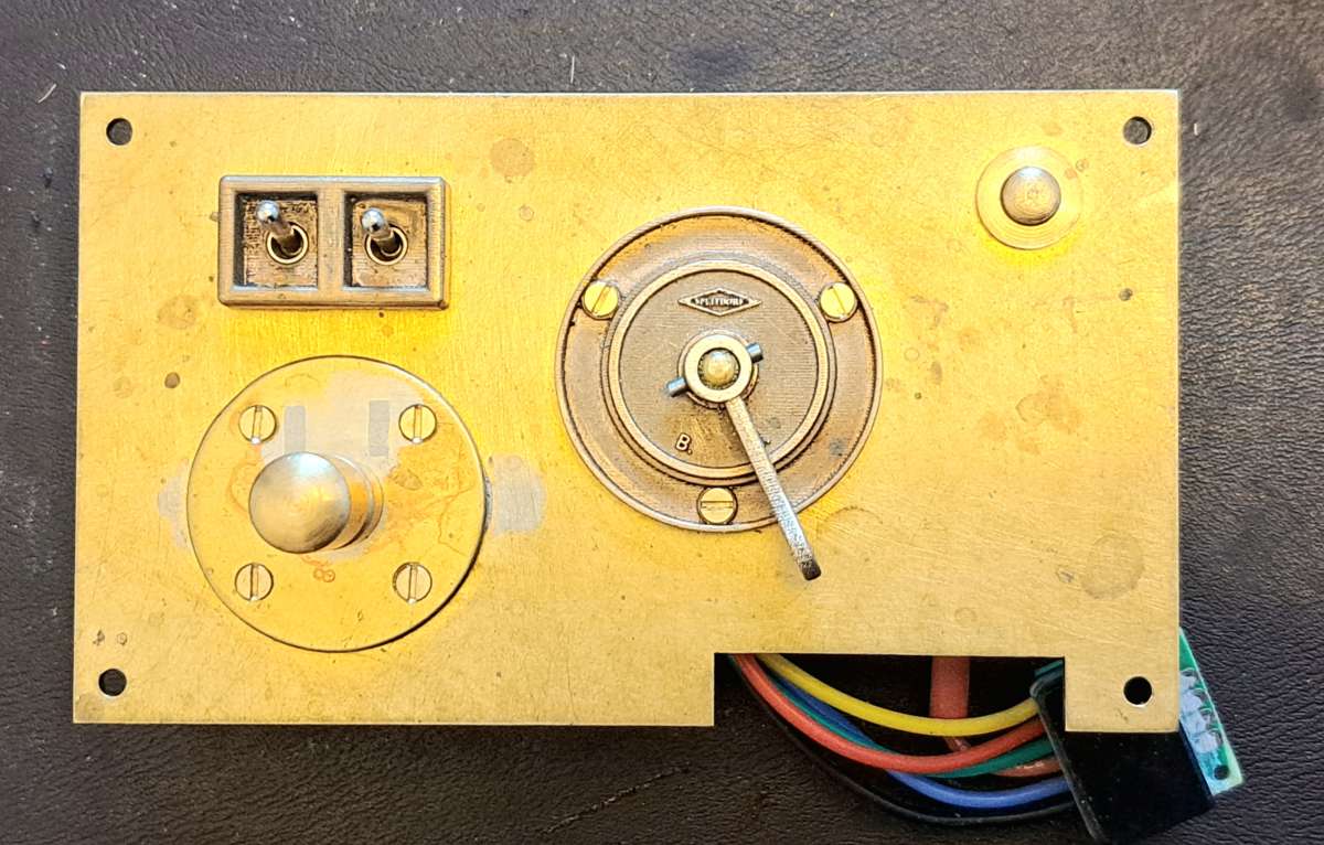

This is the finished dashboard’ It is partially a work of fiction as I was unable to find a sharp photograph. I tried, by contacting museums in the State, in fact the best picture was extracted from a WW1 film.
Top left are the front and rear headlamp switches – the casting contains modern replaceable switches.
Under them is the Plug Switch, this is a rudimentary ignition switch. If the plug is in, the ignition works, if pulled out slightly, it is retained but the ignition is off. If taken out altogether it works as an ignition key. The unit houses a replaceable micro switch.
Top right is the horn push, again it hides a modern replaceable switch.
The last thing is the dummy ignition selector – it is a work of fiction, but to allow changeover from coil for starting to magneto for running. Spiltdorf were active making such items at the time the loco was built. The switch lever has a rotation limiting quadrant at the back and spring loaded detent positions at either B or M.

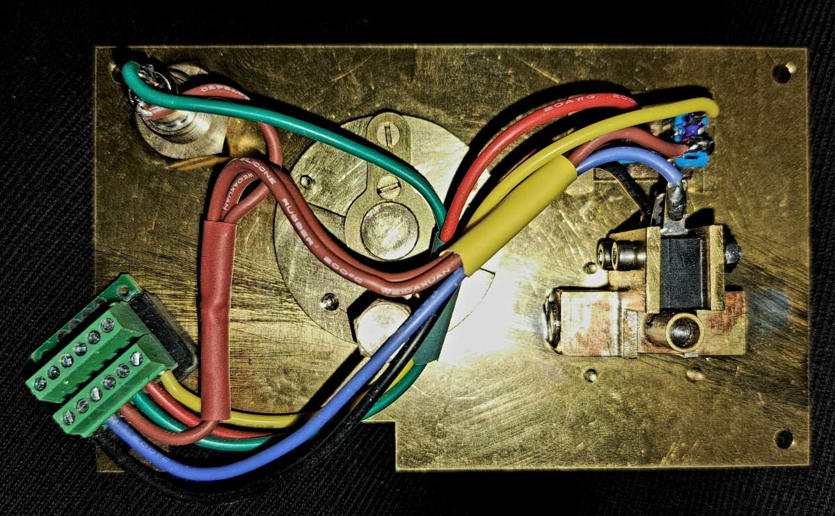

The second image shows what is inside.
