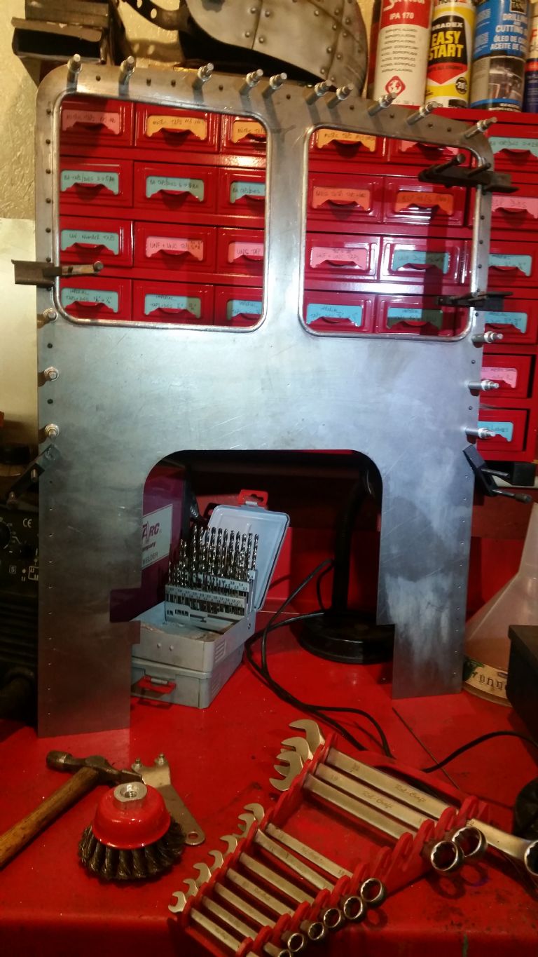

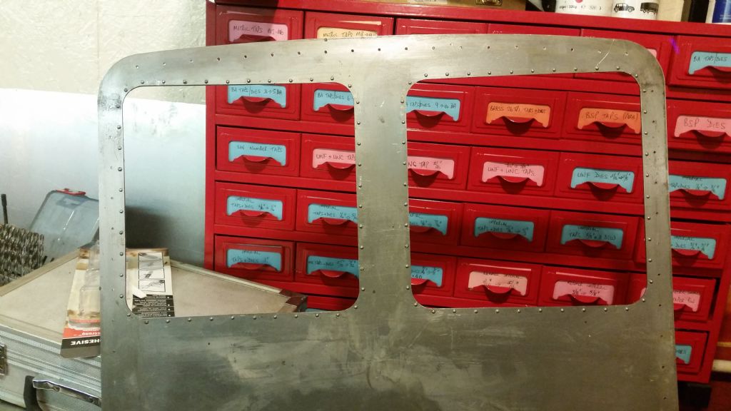

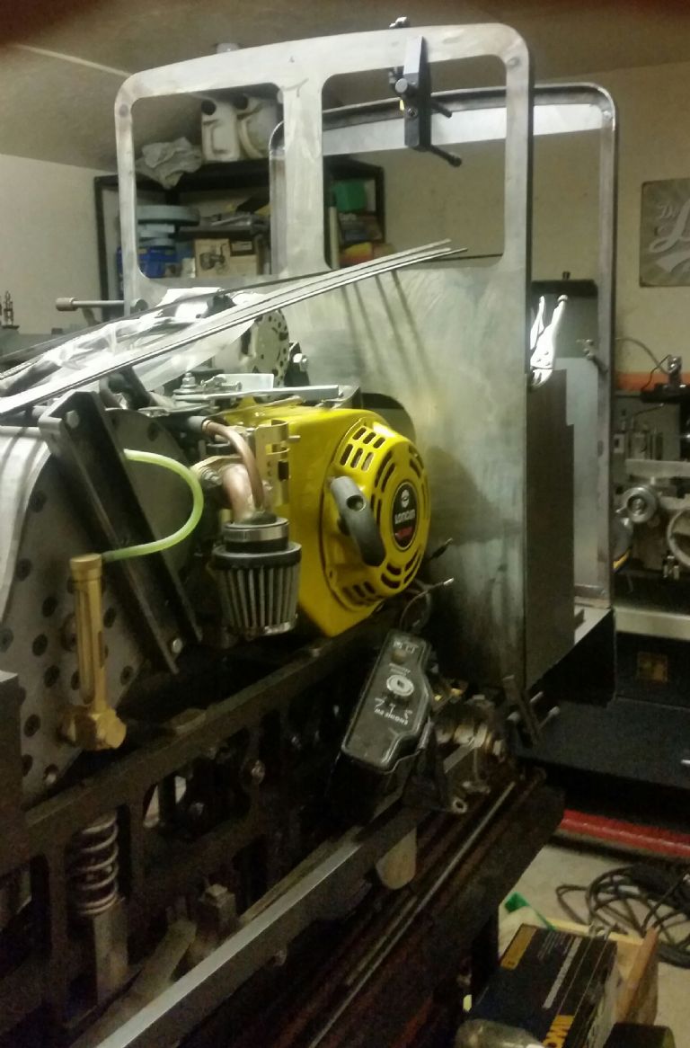

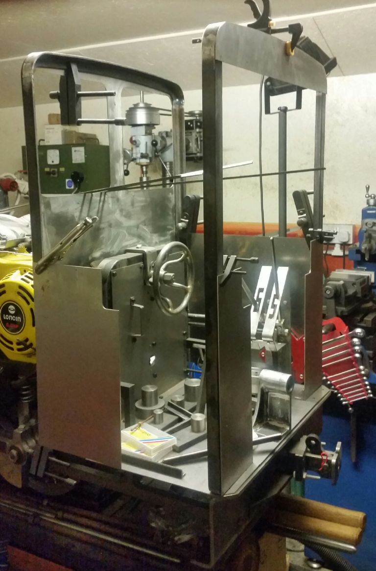

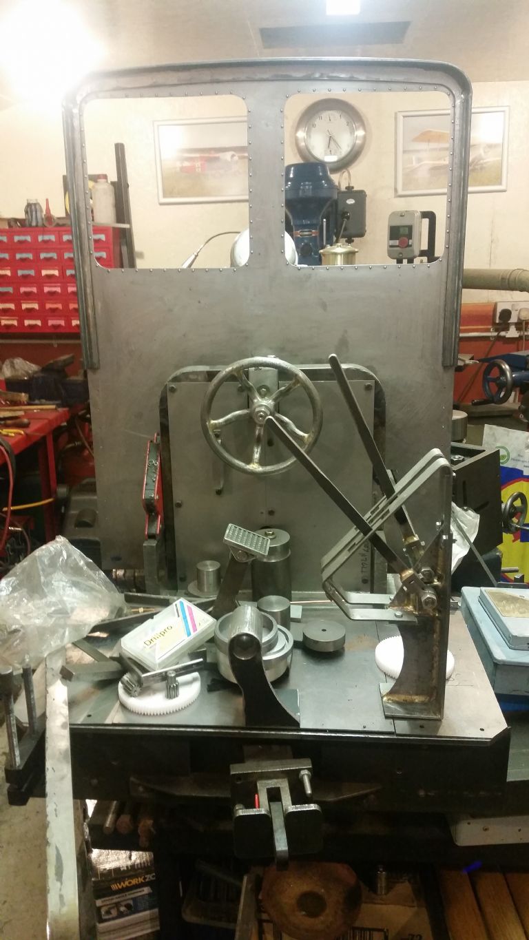

      Having cut the cab upright angles to length on the horizontal miller, similarly cutting mitres for the bits at the back of the cab, I then welded the cab roof arch angles together from laser cut parts. The two upright/arches have been welded together. It seemed like a good idea to pop the bits on the loco with a few clamps. Thankfully it seems to fit OK so far. It is very strange to be looking up at it though, it suddenly looks a lot larger. The bits sticking through the cab window are the lengths of beading for the cab.
      Cab mock up
      Cab mock up from front

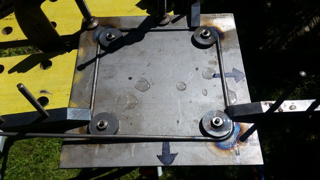

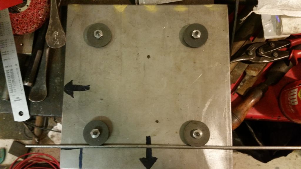

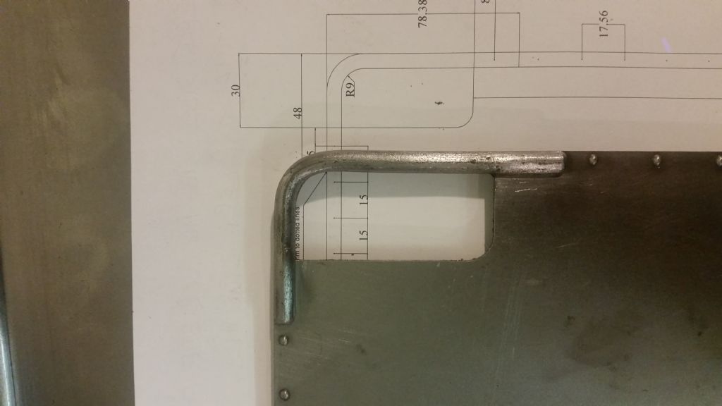

                  A bit more progress on the cab, this is the beading bending jig for the cab front window openings. I made some buttons which are bolted to a 6mm plate, then the 6mm half round was warmed in the right place with the oxy/acetylene gear and the beading bent round the button using hand force and another piece of plate. They were then silver soldered together at the ends and have now been drilled using a slotted steel jig for the rivet holes.
                  Cab Beading JigJig with bending in process

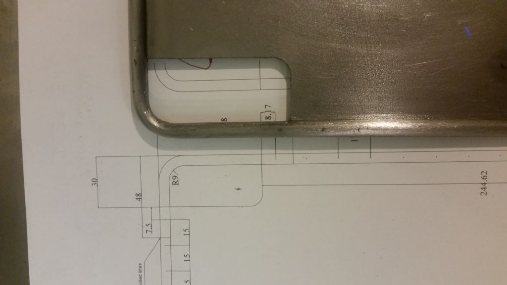

                    Since the last posting I have made a further jig to locate and drill the holes in the curved corners of the window beadings. This afternoon I have done a bit more drawing of the cab parts.

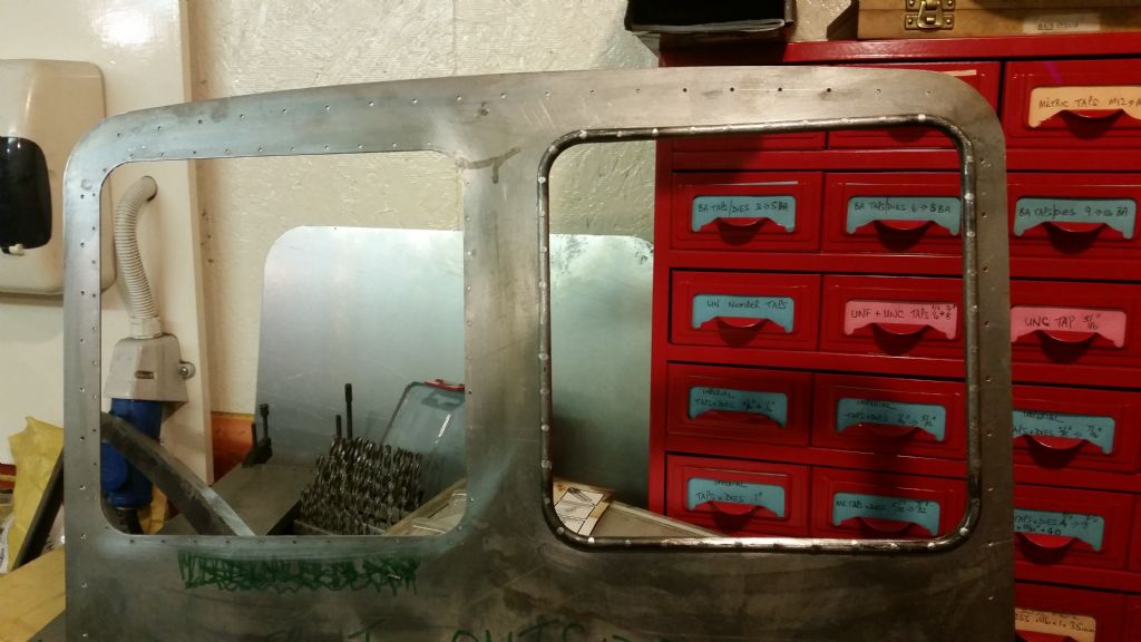

                      A bit more progress has been made adding the beading to the cab parts. I have riveted them onto slow epoxy in the hope that it will exclude water and thus corrosion.
                      First Cab Beading
                      Second Cab Beading

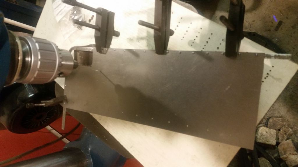

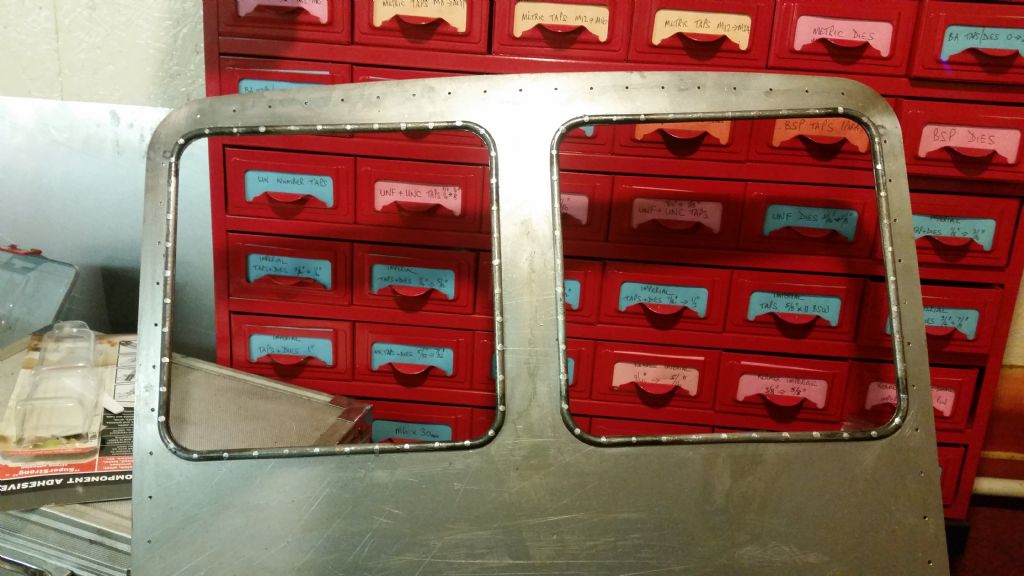

                        Rivet heads inside the cab windows, drilling a cab back for the beading rivets and countersunk rivets suitably bashed.Cab Beading Inside
                        Drilling a Cab Back for Rivets
                        Back Beading Riveted

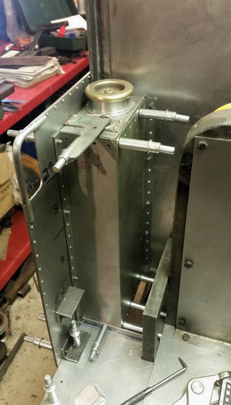

                                              Well this year I've got back to working on the Baldwin cab, all the rivet holes for the various parts exist, but I'm going to need another pair of hands to help rivet them up. Picture is one of the sand tanks inside the cab. Since then I have been working on the drawings for the loco body and the doors which between them have 70 louvres.  For those who wonder what the silver things are, they're Cleco skin pins, a sort of removable pop rivet and very useful.

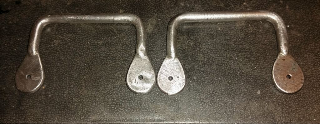

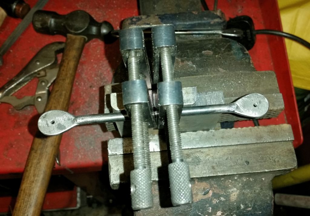

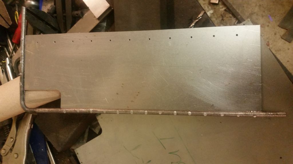

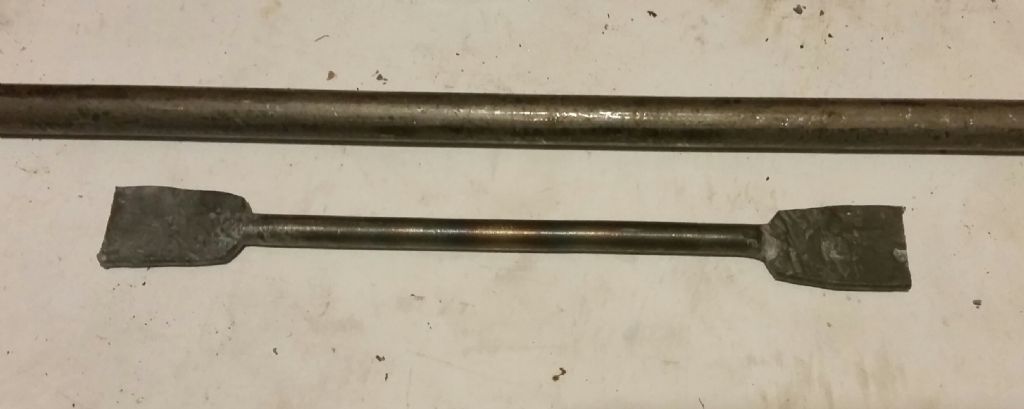

                                                Here's another picture of one of the three forged handles on the loco. They were machined down in the middle from 10mm black bar then the ends forged using the oxo as heat. My connection is so slow I don't know if I'll manage the others of this today.Forged handles started.jpg
                                                #441051
                                                Steve Addy
                                                  @steveaddy35670
                                                  These are the jig used to bend the forged handles by smoking them up with the oxo and tapping them round and the finished job.Jig to bend handles.jpg
