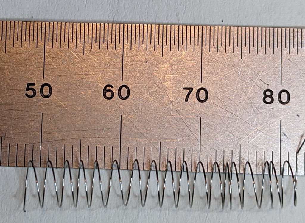

              #550048
              John Haine
                @johnhaine32865
                Again apologies for hijacking the thread. I've just had a quick go at making a spring from 0.008" music wire based on Sam's ideas. For a 4mm mandrel I used a bit of M4 studding, clamping the wire between a couple of nuts. I thought that I'd use my coil winder described here, a quick experiment showed that putting the studding in a 4mm collet on the "headstock" and rotating it with the free end of the wire weighted with a couple of toolmakers clamps wound the wire neatly into the thread. Actually I tried it quickly rotating by hand and it worked well and was quicker than fetching the drive electronics and programming it! Carefully let off the tension while counter-rotating the mandrel, I was able to avoid an 'orrible tangle, and got this.
                OD is 5.7mm and it seems to have worked quite well. Pitch is ~2mm.
