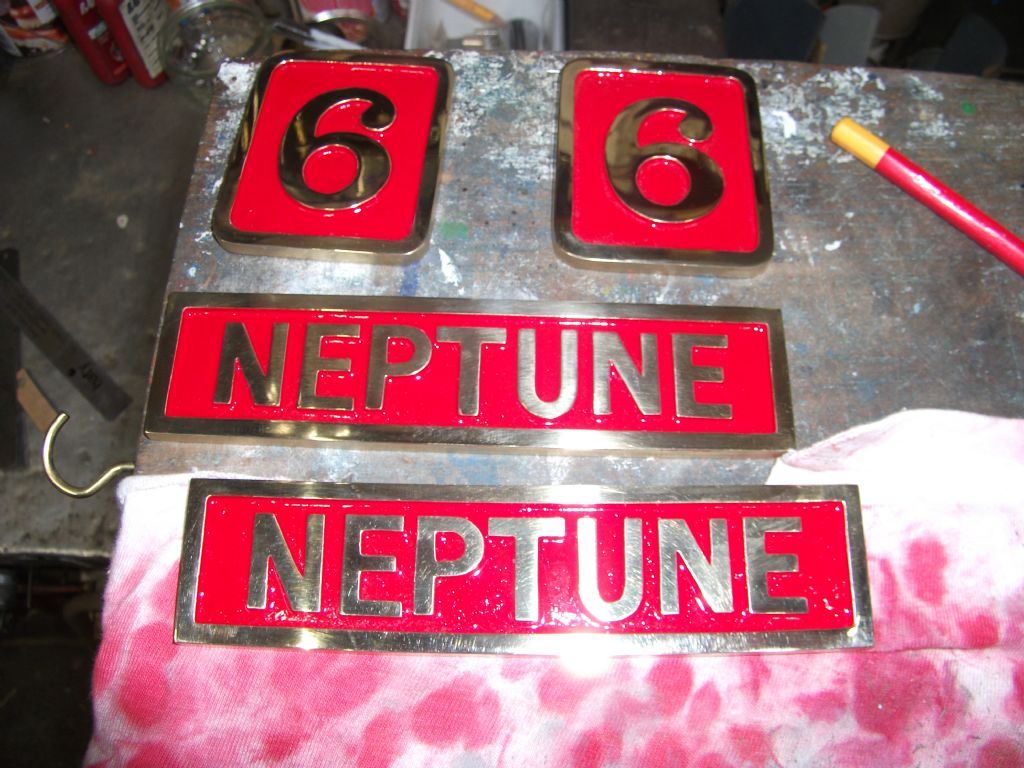

                  Hi Luker, lit the furnace today, [coke fired] & cast 2 nameplates & 2 number plates in brass for a friends little boy [6 yr 0ld] for his 5" battery loco he built for him, patterns made from mdf cut out on a fretsaw, I had small turnings chrome plated brass bath taps few plumbing fittings & few old steam rally plaques,,Put a tablespoon of your additive in the crucible & the brass cast really well, no porosity lovely castings, cleaned up well, very little if any zinc loss I always keep a lid on my crucibles & coat tools,skimmers pyrometer probe etc in contact with the metal with zircon based refractory wash also ingot moulds & tart tins as well as you will know molten alloys corrode steel as well as poss contaminating the melt, did you put details of your oil burner in model engineer? I'm interested in building one & like the sound of it ,thanks.
                  Graham.

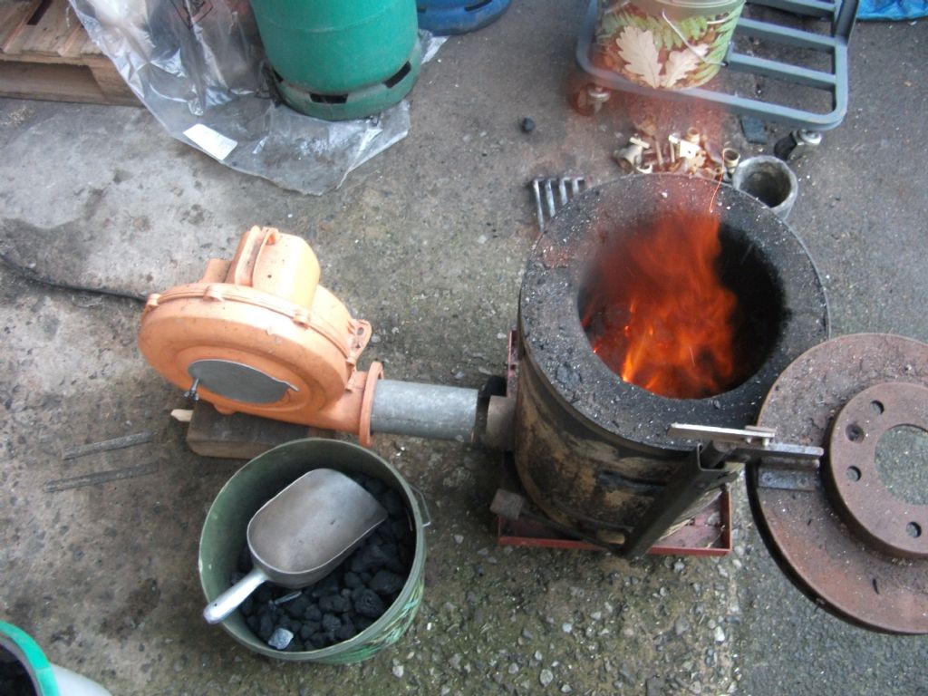

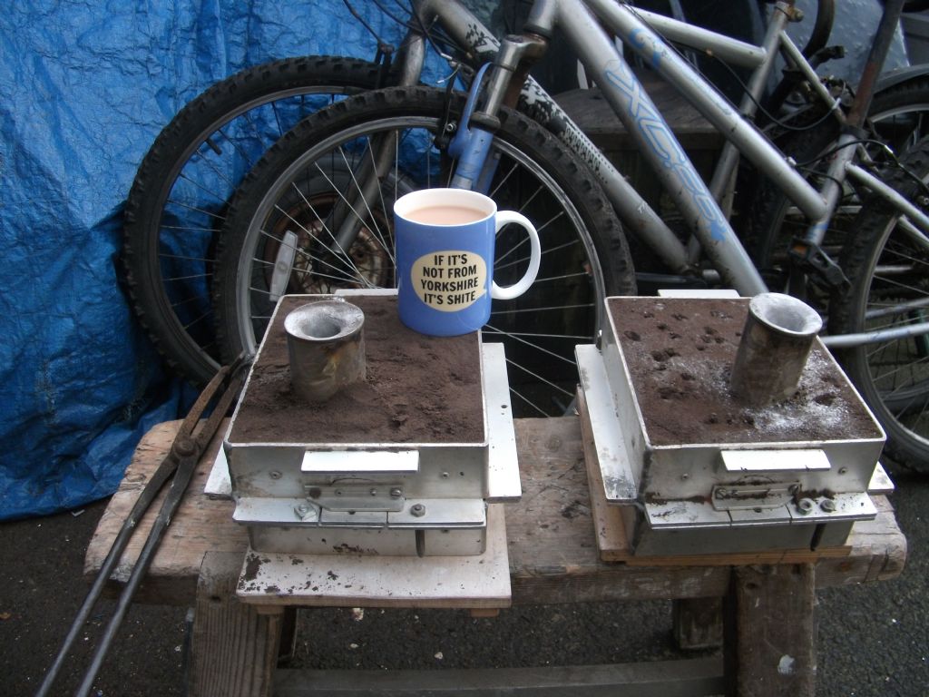

                              the artfull-codger
                                @theartfull-codger
                                Posted by Luker on 10/01/2022 17:13:25:
                                Hi Graham, that's great news! Thanks for the feedback. I'm always glad when someone can take something I've written about and reproduce the results, then I know I'm sharing knowledge and not just boasting wink.
                                Yep my furnace design, including the burner, is in ME4626. I gave the ratios of what will work based on my calculations, but my actual sizes are also given.
                                Please let me know how you get along!
                                PS have you got some pics of the name plates?

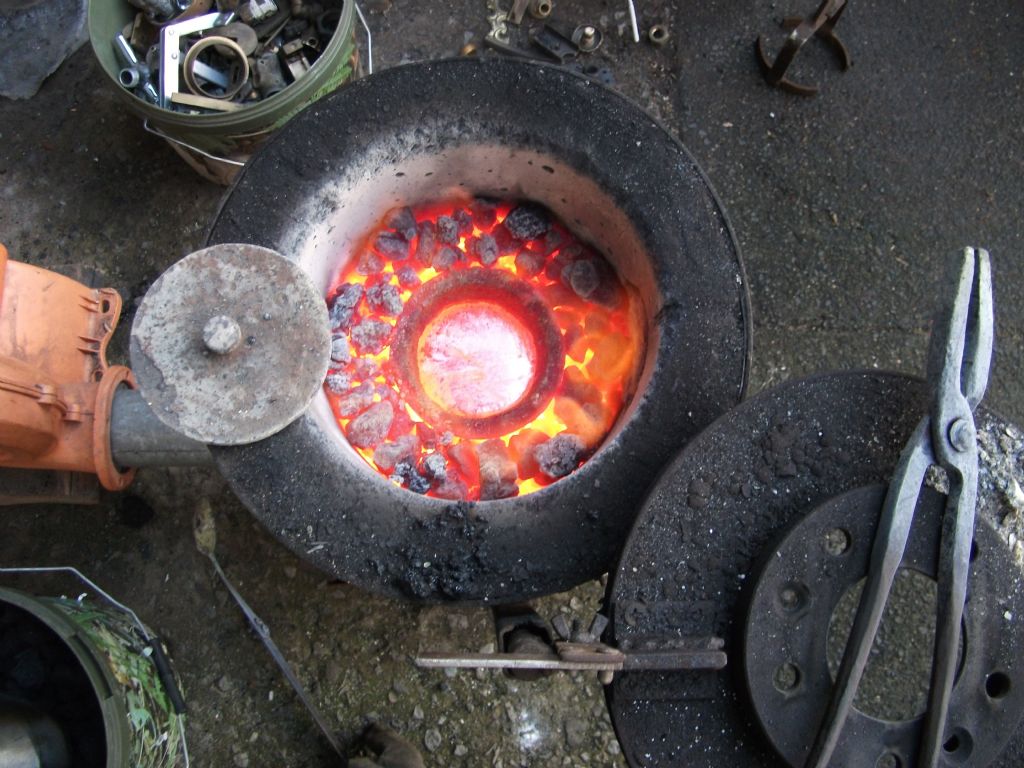

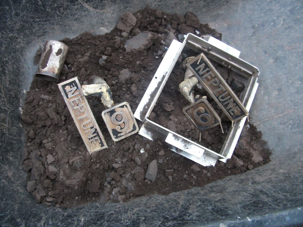

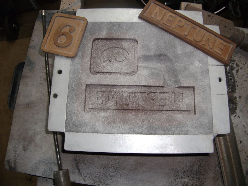

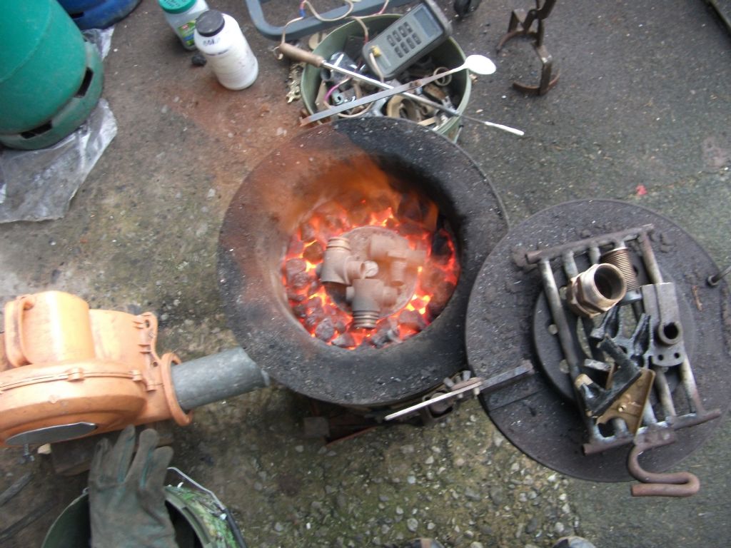

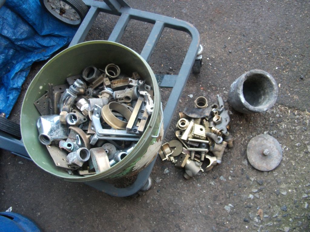

                                Hi
                                Luker, [son came up & loaded up for me!! thanks Philip] a few pictures of my set up 1st one showing the drag with the patterns removed,2nd one the "pot fodder" bath taps rally plaques plumbing fittings etc,3rd one moulding boxes ready to pour 4th one shakeout & lastly the finished castings for the little lads loco fettled polished acid etch primed & 2 coats of 2k suzuki red.
                                Mould
                                Scrap
                                Moulds
                                Shake Out
                                Finished Castings
                                #580708
                                the artfull-codger
                                  @theartfull-codger
                                  Oops, added more pictures & got details mixed up!!1 & 2 ok 3 first lighting up with wood4 moulding boxes ready to pour 5 pre warming brass on top of crucible with more on the top of the lid 6 ready for lift out 7shake out & finished castings!

                                    Hi Graham, the name plates look great! Surface looks spotless and they polished and painted beautifully. Thanks for the pictures.
