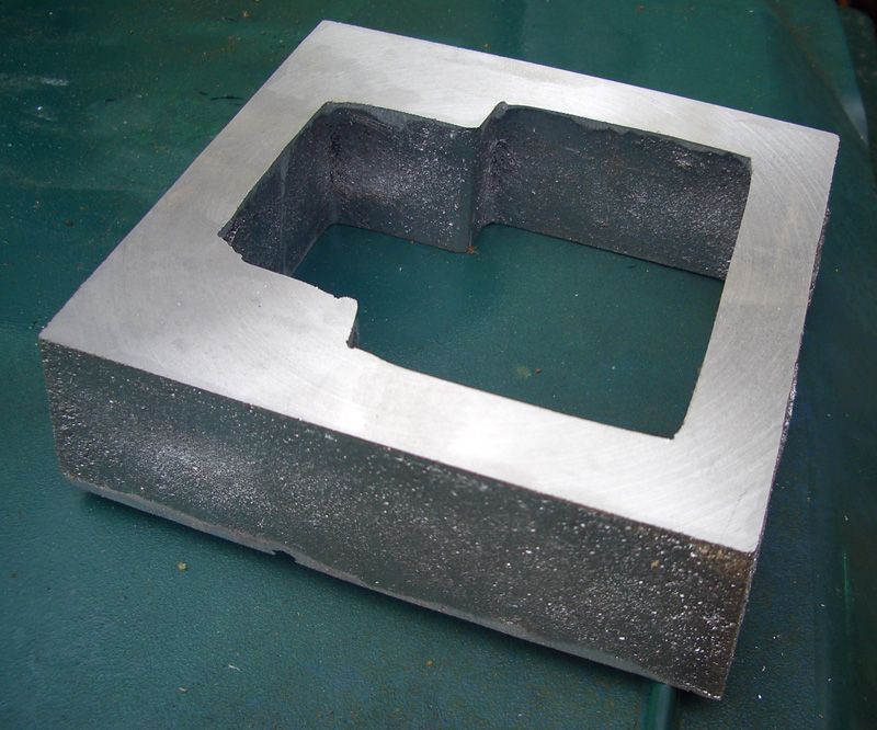

        I know quite a number on here cast their own stuff and I also know quite a few people would like to try it but don't know how or where to get the materials.
        I needed to do a bit of casting today so I thought I would do a bit of a pictoral "How To". Casting is not for everybody and to be honest, you only need to do this a couple of times to realise those expensive castings may not be so expensive after all. In fact they may be a bit of a bargain.
        Materials. You are going to need some "stuff". Whilst most Casting "stuff" is as old as the hills you are going to need some simple, but basic ingredients. First off, you need the Metal itself. I assume you are going to use Aluminium and old castings along with a bit of good ally material in the form of offcuts will be fine. Then you need a crucible. For casting Ally this could be one of those stainless containers from the supermarket, but don't expect this to last too long, a couple of pours at most is the general experience. I don't know, I have never tried it. I have a couple of good crucibles.
        Then you are going to need a Flux and a degassing agent. You can't really go far without these two basic chemicals. I suppose you could possibly use Borax but again I have not tried this. I buy my flux and de-gassing tablets from John Winter Foundry supplies who are one of the shopping partners on this site. They cater especially for the home foundry in one department and also they are the only supplier I know of who supply Oiled Green Sand. I prefer oiled sand as it gives good definition, holds together well, stores well and al the other good things you want. Doesn't come out of carpets easily though as it tends to stick, being oiled an all. You have been warned
        Outside everything else, the most indispensable piece of kit you need are a pair of leather gauntlets. You might get away with a pair of gardening gloves. You probably won't. A pair of good gauntlets are not that expensive. Shop around but believe me, you don't want to be cutting corners. Then you are going to need a furnace, I made my own, pair of good tongs for the crucible, I made my own, a drag and cope (the two halves of the mold former, again – I made my own. In fact you can make everything you need yourself if you so wished.
        So, let's get on with it, first up, fill the bottom bit with sand:
        Then place your pattern in it. I am doing this a bit ass backwards, because I made a simple pattern from a piece of pipe in one piece. A quick look on Utube will show you how it all goes together with a split pattern but this job is in no way precision casting because today I am making Lead Hammers. Close enough is good enough.
        The white powder you see sprinkled everywhere is plain old Talcum Powder. Fruits of the Valley I think this was, smelled nice anyway:
        There you go, pulled the two apart and now laid the shaft ready in the drag, the bottom part of the mould. I have also now made the runners for pouring the metal in the Cope, the top part of the mold:

          Now, the lead is ready to go, it is well molten and now I am going to drop a de-gassing tablet in it:
          You can see I have used my special Foundry Ladle to remove the dross in the pic too and that grey lump is a de-gassing tablet – and what is the strange tool next to it, looks like it fell off a Dalek – all is revealed here;
          It is a stainless sink strainer that I have made into a plunger – I use all the best tools as you can see. Common sense dictates that you bon't look directly over the crucible when plunging. It is quite volatile and can be violent. Not dangerous at all if you are careful. The one cardinal rule is that your tools nust be dry. Do not for instance begin casting outside when it is raining. (and as a word of caution – don't try this inside a building unless it is the size of an aircraft hangar). Also, do not pour over the vent hole either, move around so the pour hole is right in front of you:
          And here it is, a lead hammer:
          Lead is easy to work with, I first started casting with lead when I was about twelve, going back a bit, but once you move up to aluminium, everything doubles, twice the heat, twice the protection and so on. Casting Bronze is yet more hazardous and Casting Iron is another ball game altogether. Here are a couple of ingots from today's casting, they are both shiny but the one on the left is lead and the one on the right is aluminium. Their shape reveals their very different characteristics.
          You can also see some bits of iron pulled from the aluminium melt, a trigger and a couple of grub screws, one way to dispose of unwanted scrap guns!
          Is home casting "worth it". Well, that depends. If it is a special one-off that nobody has, it may be your only way to get that part. If you want to pass a couple of hours right back at the basic level of metalworking, it is hard to beat. Blacksmithing is it's equal and occasionally I can be found doing work on my anvil. I find it very relaxing. It is not for everyone, it can be messy, it is certainly dangerous and it is hard work and usually, when you are finished all you have is a bare casting. But then that was the idea, wasn't it?
          I am not suggesting for one second this is how you go about casting or even any of the techniques I use are correct. This is how I do it and it works for me.

                6.jpgI would argue the need for degassing tablets. I did some casting at evening school some 40 years ago, we degassed the metal and the resulting casting was full of bubbles.
                Over the last few years I have produced approximately 40 castings in aluminium at home and have not done anything to degass the metal. None of my castings have shown any bubbles. when machined.
                Whether you degass or not have a go at casting it is very addictive! It also can save you a lot of money, I am currently building a rotary table and the cost of materials if built from bar stock was over £40 but with castings the only real cost has been the fuel for the furnace and that is under £5.

                                My understanding is that one should not use Borax as a flux with Aluminium, an equal mixture of NaCl + KCl should be used.
                                Peter.

                                    Graham, you mentioned casting Lead, the pot looks a bit grisly so the best clarifying material for lead is Bees wax!
                                    A piece about the size of an Acorn and stir the lead as the heavier metals go down and stirring mixes the metal and brings up all the dross. Plus all the steel bits from the scrap. You know how to skim off the dross leaving clean metal.
                                    I wonder if the risers for Aluminium need to be quite large to add pressure to the pour? Maybe that is why the corners did not fill out?

                                      Very useful that Clive, I will remember that in future and fortunately have a good supply of Beeswax! wink
                                      Both the lead and aluminium were poured into the open Ingot mold that can be seen in the pics (i hope – if not I will post a pic) so the Ingots were free forming and that is how aluminium ends up. These are small ingots so a bit more pronounced.
                                      Peter, thanks for the information, I was saying I did not know if Borax would work as a flux, I didn't make myself clear. I use a commercial grade and always get good results.
