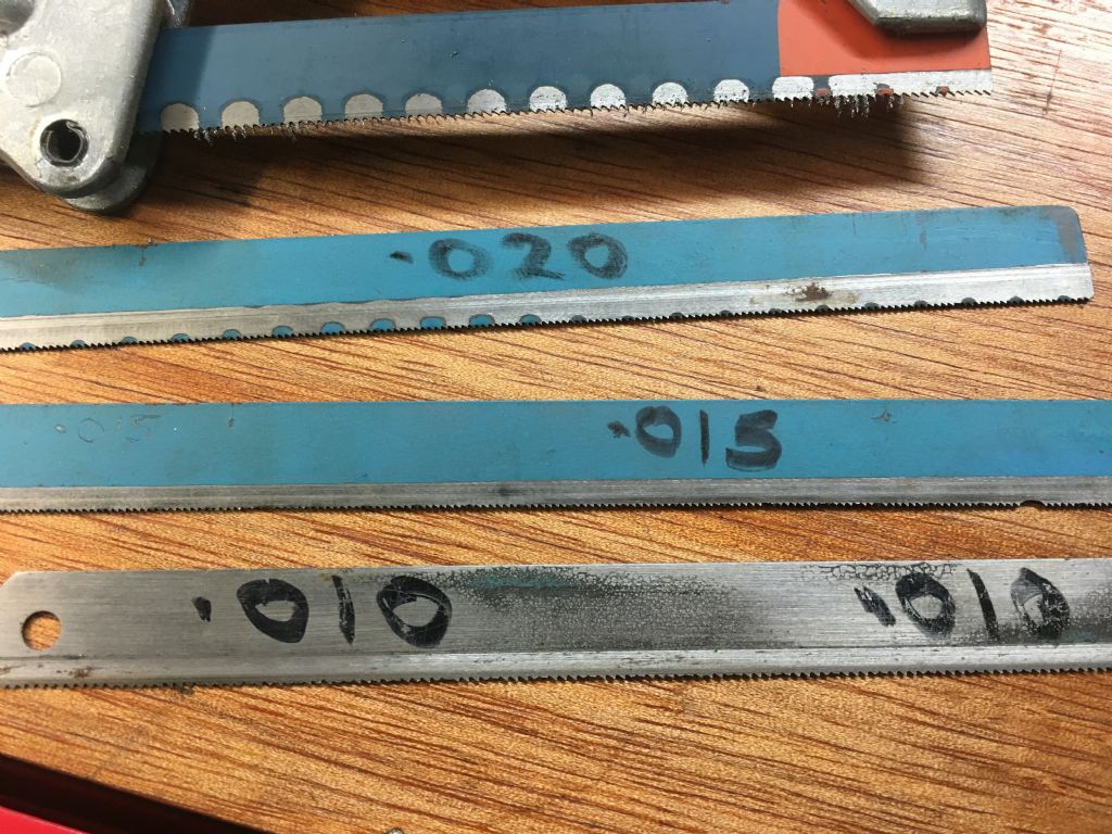

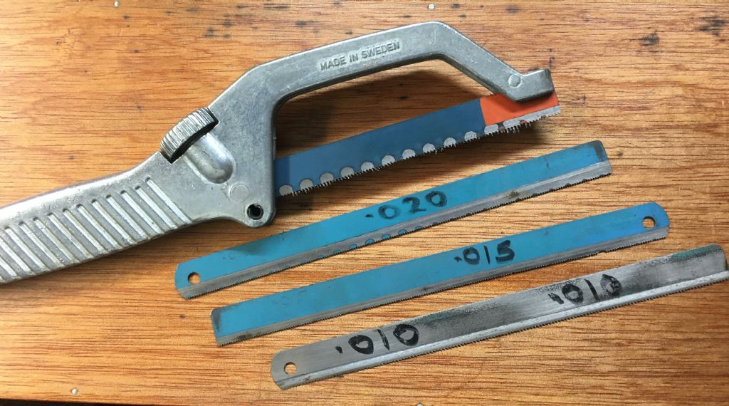

              I use modified 32 tpi hacksaw blades in a pad saw handle, I have used this method for many years and it works well. I use part blades and grind the teeth flat on each side first on a surface grinder then grind equal amounts of either side to the thickness I want. I find 0.010 ; 0.015" & 0.020" cover most things but now and then use one with just the "set" removed thus the standard blade thickness.
              Here are a couple of photos I took tonight–more in my albums
