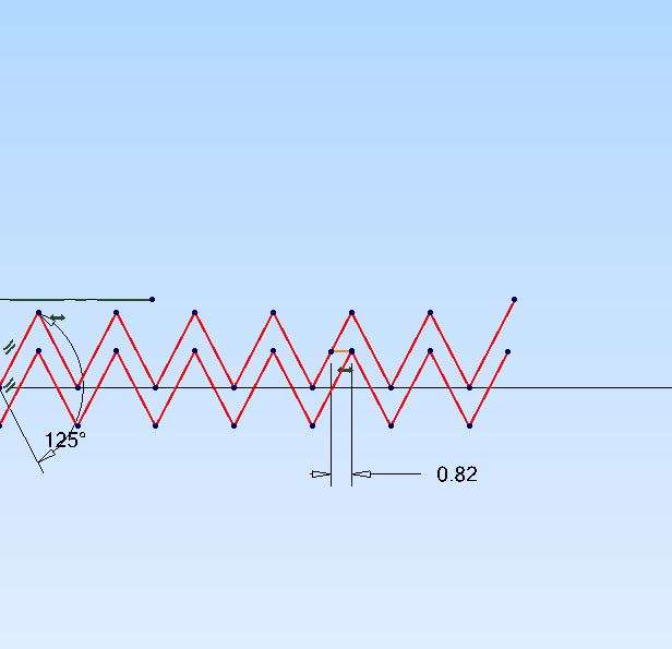

              You could actually be a bit out with picking up the thread, draw it out and see how much by, I expect 10thou either way won’t matter.
              Just put a dti on the tool holder and run the carriage up and down the lathe as an easy way to get it straight. HSS will do just as well as carbide. You can get a 16NR W8 which is not that big. I’d leave the tool tip alone so as not to risk the crest of the spindle thread fouling

                  Ignoring any rounding you could be 0.82mm  (30 thou) either way and still be cutting solid metal.
                  82

                                    Re the 0.82mm I mentioned, that is based on cutting straight which is what I do, angling the topslide will need you to get closer to the right position so the back of the tool runs down the slope of the old thread
