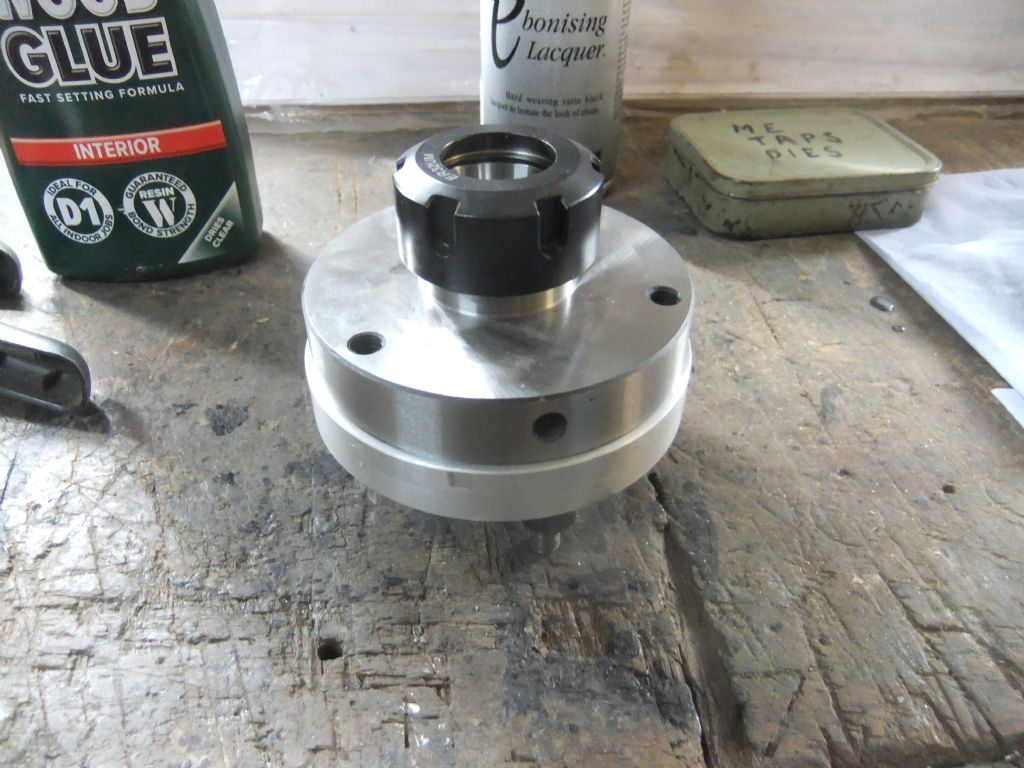

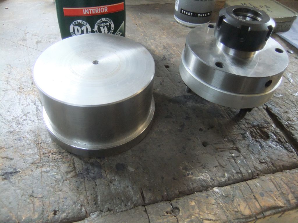

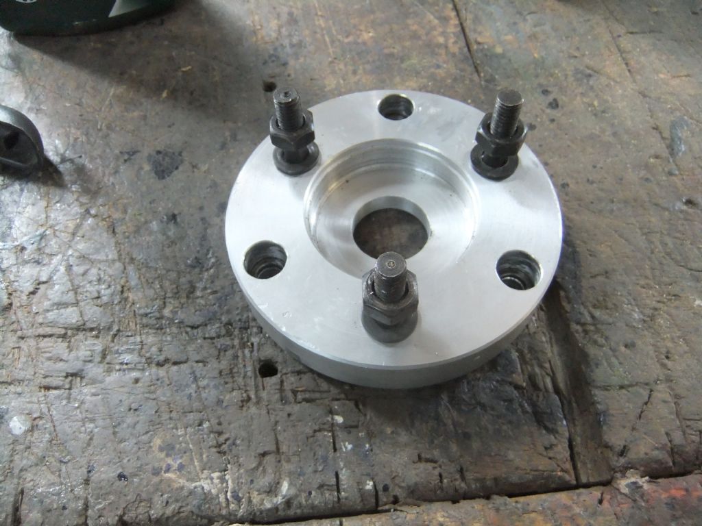

                    My first one I made from Ali and I am remaking it is steel as well as making it a little thicker.
                    On my WM280v there is a mark which is there so that the three jaw chuck is fitted in the same orientation each time so on the backplate I did the same which brings it very close to the same settings. The PCD on this is as Jason's 75mm.
                    I turned the face which attaches to the spindle first and then attached it to the lathe before turning the outer face which attaches to the ER collet chuck(like you this is ER32).
                    In this last photo I have rough turned the blank ready to do the same turning as I did for the Ali one. I am a total novice and I am sure that if I can do it then you should be able to do the same. I know there will be some that say I did it wrong but I got the first one working just fine and it ran concentric when fitted each time (yes I did measure it)
