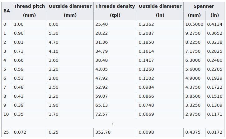

                                      Journeyman
                                        @journeyman
                                        This may (or may not) help:-
                                        #544636
                                          Posted by Nigel Graham 2 on 12/05/2021 15:38:51:
                                          What typo?
                                          The dimension is A/F (Across Flats).
                                          dont know
                                          The typo that you made when transcribing 0.248

                                                #544861
                                                Howard Lewis
                                                  @howardlewis46836
                                                  The BA thread is basically Metric. (Originally Swiss, I believe )
                                                  Starts at 6 mm x 1 mm pitch (But NOT M6 because of the different thread form, 47.5 degrees as opposed to 60 degrees for Metric threads ) with thread pitch decreasing by a factor of 0.9, as shown in the tables above.
                                                  The spanner size shown in the tables above decreases by a factor of approximately 0.88, varies very slightly from size to size..
                                                  Cromwell Tools offer open end BA spanners, so maybe they offer nut spinners also?
                                                  If you can find a capscrew which fits your 4BA nuts, you could always make your own by fixing it into a screwdriver handle.
                                                  Maybe more readily and cheaply available
                                                  Howard.
