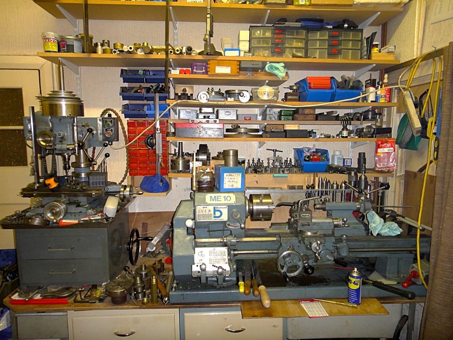

                                            #198125
                                              John, you just need to get yourself sorted outsmile p Me on teh left with BA and BSP on the right, I have another for metric
                                              #198127
                                              Ajohnw
                                                @ajohnw51620
                                                coolMy workshop is a wall in the house Jason so an orderly arrangement of bits and pieces is rather difficult. My lathe sits on a very old kitchen unit. I do have a few of the same draws as you show and less of the deeper ones but they soon fill up. I recently added a 15 draw one which might help.
                                                Workshop? well
                                                More shelves higher up and a handy step ladder near by. This images title is a part tidy up. Finished long ago and I am currently in the middle of another one.
