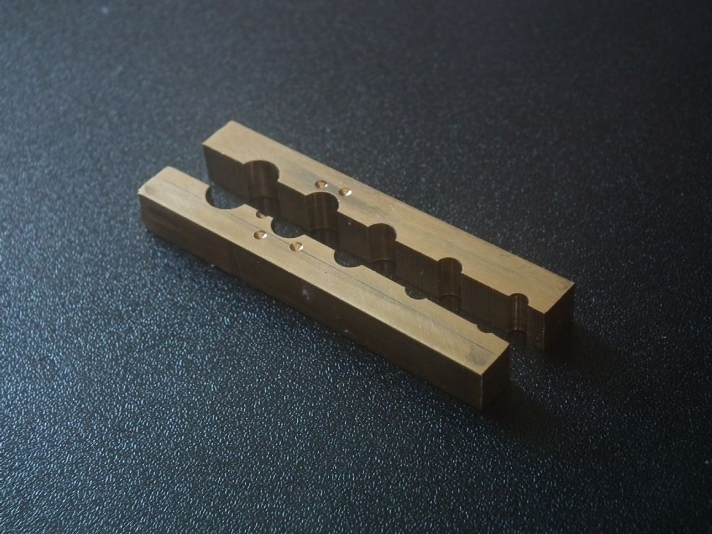

          Take a piece of brass bar, drill a hole the size of your tube (plus holes for other sizes while you're at it) and saw along the centres of the holes like this:
          Then put that in the vise to grip the tube without distorting it.
          Russell.

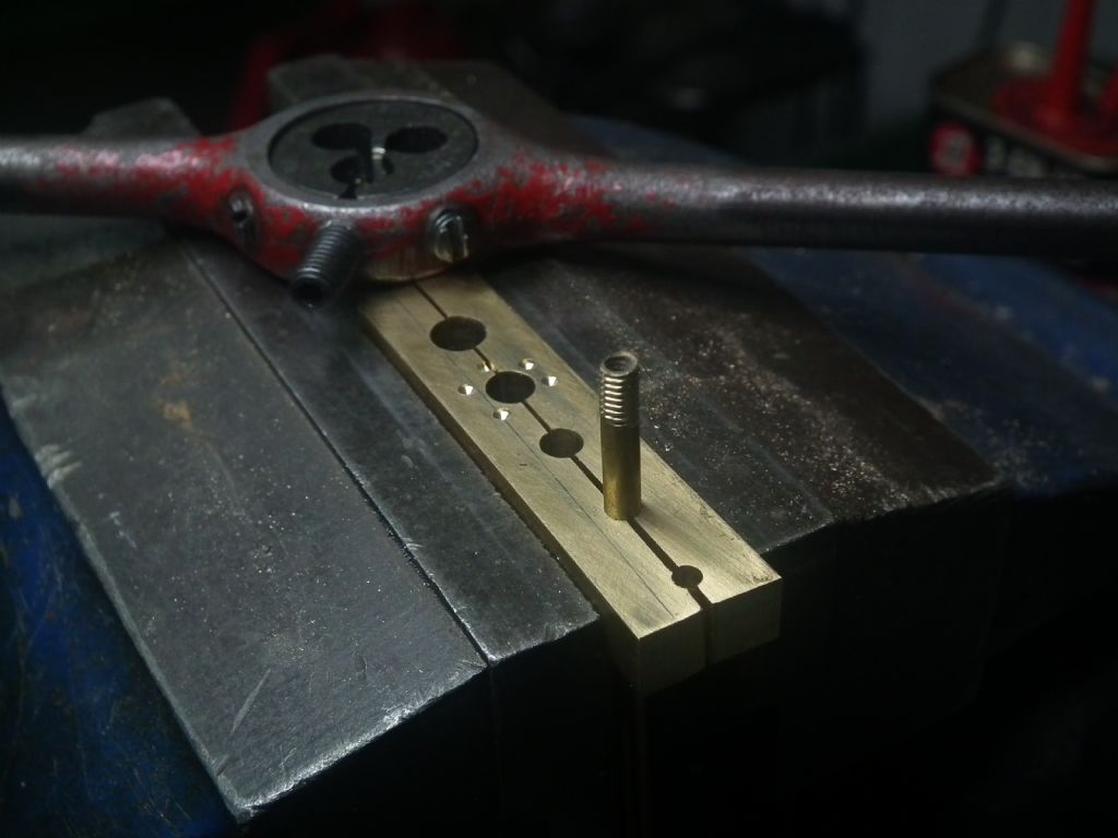

                                                  I was not suggesting that your problem was that you crushed the tube. I understand that the tube is turning in the vise and needs to be held more securely. You therefore need to grip it harder. If you just tighten it in a vise with "V" slots in the jaws as you tighten it further it will start to collapse and thus reduce the holding pressure even if the distortion is not permanent.
                                                  The split bar I suggested allows you clamp it securely and apply a lot of pressure without distortion. It does need a lot of pressure to hold it still.
                                                  Here's one I have just done:
                                                  That is a 1/8" diameter tube threaded 5 BA and took about 2 minutes to set up and do and another five minutes to find my camera. Note however, the big heavy vise. Rocol RTD compound might help as suggested above but I only find it necessary for steel, not brass.
                                                  Hope that helps.
                                                  Russell.
