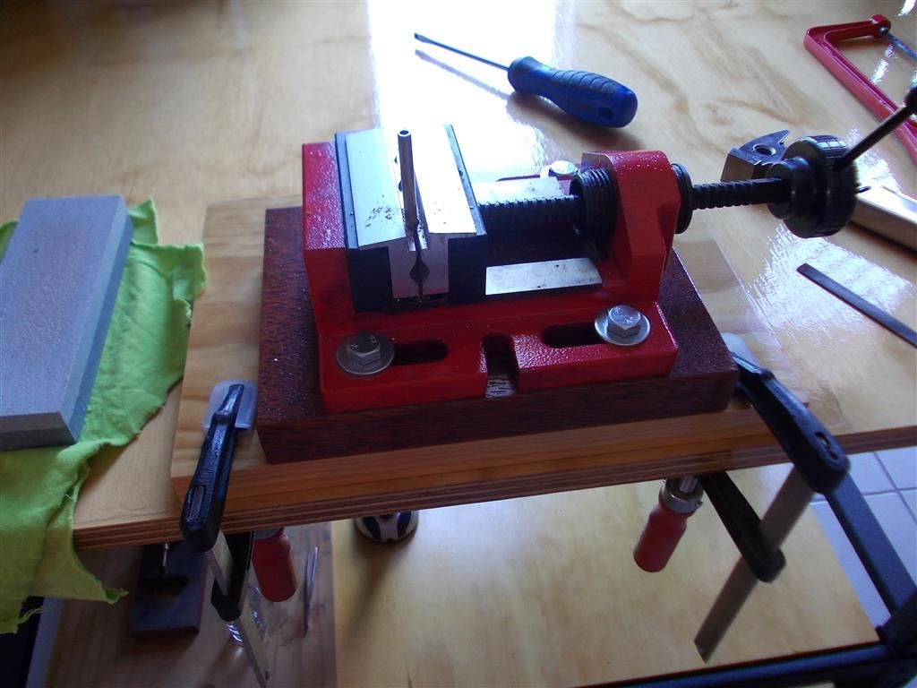

                                                  I am still having problems with the brass tubing (partially) turning in the vice when I try to cut a thread on it. Is the problem my vice or should I not be using the aluminium soft jaws ? I get there eventually but if I could stop the tubing from turning at all then the process would be much quicker.

                                                    Ideal would be to hold the tube in a collet and cut it on the lathe using a tap or die holder against the tailstock. Not under power, but by hand turning.

                                                      You don't say what size of tube you are trying to tap – but one thing I've motioned here recently, is that it does make quite a difference what tapping drill size you use. Industry use high thread engagements (100-95%) whereas 70-65% is good enough for our uses generally. You will really will feel the difference.
                                                      I purchased an inexpensive tap & drill set form Lidl's a year or so ago and used the drills provided without too much thought but found the larger ones really hard work. I checked the sizes against Tubal Cain recommendations and started to use larger tapping drills. Life became much easier. I guess I should have replaced the drills – but just printed a reminder for the box instead.
