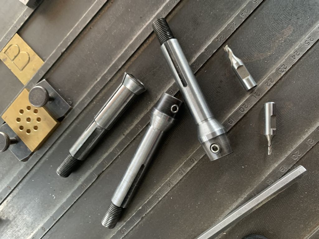

                Posted by William S on 18/02/2021 00:44:07:
                The threaded collet issue is important aswell Internal threaded collets were only avaliable in 6mm, 1/4", 3/8" and 10mm if you have them you are well set up! I made up a 6mm and 1/4" fc3/weldon/side lock shank arbors that go directly in the spindle which I use all the time. I intend to make other sizes when time allows.
                I hope the OP doesn't mind that I am hijaking this thread a little but I couldn't help it! William do you have any more details you could share on making your own collets for a BCA? My skills probably are not there yet to take this on but I am willing to try! I'd love to make up a couple of metric threaded collets if I could. I am lucky enough to have a 1/4 and 3/8 version.
                Thanks you
                Ian
                #543383
                William S
                  @williams
                  Hello Ian
                  I can expand a bit more however I'm going to disappoint as it wasn't a collet I made, it was a sidelock cutter holder:
                  Those are what I made, They have 1/4" and a 6mm dia hole to suit the fc3 range of cutters, they could also be used to hold any other cutter if one was to grind a little flat to allow the grubscrew to retain them.
                  I will make more with a smaller range of holes- 3mm /4mm /5mm /1/8"/ 3/16" etc as they work well especially with carbide end mills
                  They are not to difficult to produce just turn the o.ds between centres, this enables a batch to be done(angle/screw thread etc) with minimum of fuss, Then clock them up in the 4 jaw chuck to bore the end. This has been documented over on modelenginemaker I belive.
                  Collets are largely the same I belive, however a front portion is left on until the very end, I have read the process on another forum I think.
                  I hope this helps
                  William
