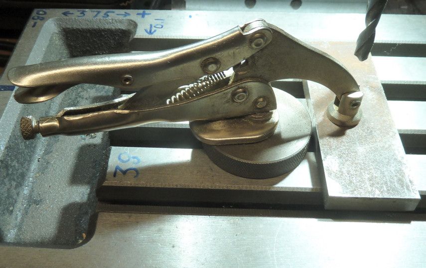

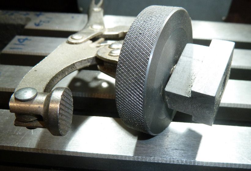

                                    For drilling I mostly use the mill/drill these days, it avoids careful marking out. By adding a threaded spacer and T nut, this type of clamp can be fitted and secured in a T slot. I normally clamp the metal together with a piece of scrap MDF.

                                      I should mention that the implementation shown suffers from the deficiency that there is a considerable bending moment at the junction of stud and clamp body. It was originally intended to buttress it here with a large diameter threaded sleeve, say M10 inside and about 20mm fine outside for the clamping wheel thread. This was not done because no suitable combination of tap/die/bolt was found. Despite this, it has so far been satisfactory.

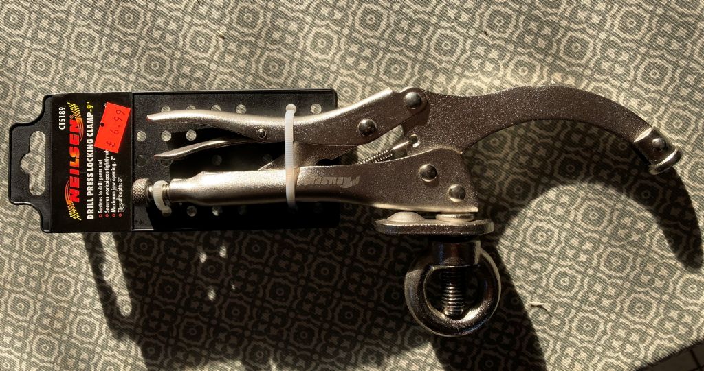

                                          As chance would have it this morning I had to go for a Blood sample, near to the blood clinic is the tool shop I bought my drill press clamp from, so I called in to get some bottle brushes and a few other odds and bits. Whilst there I checked on the drill press clamps and it has now gone down in price to £6.99! So I grabbed another as I'm bound to lose one sooner or later and at £6.99 it looks like a bargain when compared to other retailers. Can't believe Axminster can charge nigh on £20 for them.

                                                Posted by Oily Rag on 22/11/2021 13:56:45:
                                                I wouldn't automatically assume that the quality of the Axminster ones and Neilsen ones is the same.
                                                #572520
                                                Oily Rag
                                                  @oilyrag
                                                  Not having seen the Axminster ones I can't comment – other than in the photographs they certainly look like siblings if not twins!
                                                  And at the end of the day it's just a bl**dy clamp, not a micrometer!
                                                  Martin
