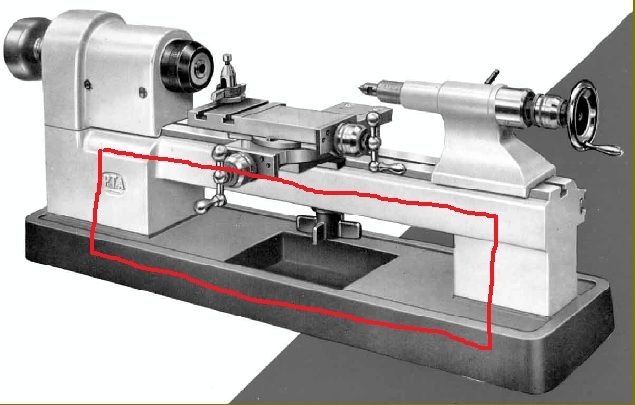

                                              On this occasion I discovered some screws that seem to be for adjustment. But I don't understand one thing, if the lathe is going to sit on a rubber carpet then does the adjustment still make sense? I can't put the lathe directly on the tiles.

                                                That's a good question for a lathe needing adjustment
                                                The loading still needs to be equally distributed, any bed twist must be eliminated
                                                More experienced folk than me will know the details concerning a bigger machine like yours
                                                some searches to help you on your way
                                                Edited By Ady1 on 12/03/2023 17:50:46
                                                #637392
                                                Ady1
                                                  @ady1
                                                  As a simple example the smaller Pultra 1590 lathe uses its base for leveling purposes and to resist bed twist under load
                                                  The lower base section is actually essential for completing this small lathe setup, it creates a steel box when it is bolted to the lathe, together the base + the lathe are much stronger
                                                  Bigger stronger machines like yours need to be straightened up manually by the user
                                                  Edited By Ady1 on 12/03/2023 18:25:45
