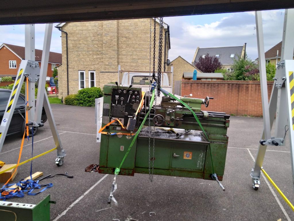

                I also found a truck with a crane. But the lathe has no hooks. This looks like bad design to me. There is a place on the right where we can put a flat rope around the bed. But on the left this is not possible. The seller said that we can use the chuck as a support point for the rope. To my horror he told me that this is how he unload it! Or to insert a pipe through the chuck long enough to exit on the left. Is this a common practice? Personally I think it is a bad idea. Why pulling a few hundred kg from one of the the most critical part of the machine?!
                It is likely that the manufacturer made provision for you to insert steel bars through holes in the base for use as a lifting point.
                As shown here:received_1976656572723815.jpeg
                If there's no holes for that you can do the same thing by jacking the machine up and using a square/rectangular steel tube or C-channel but you have to drill it for the hold-down bolt hokes in the base of your lathe and bolt the tubes on for a secure lift.

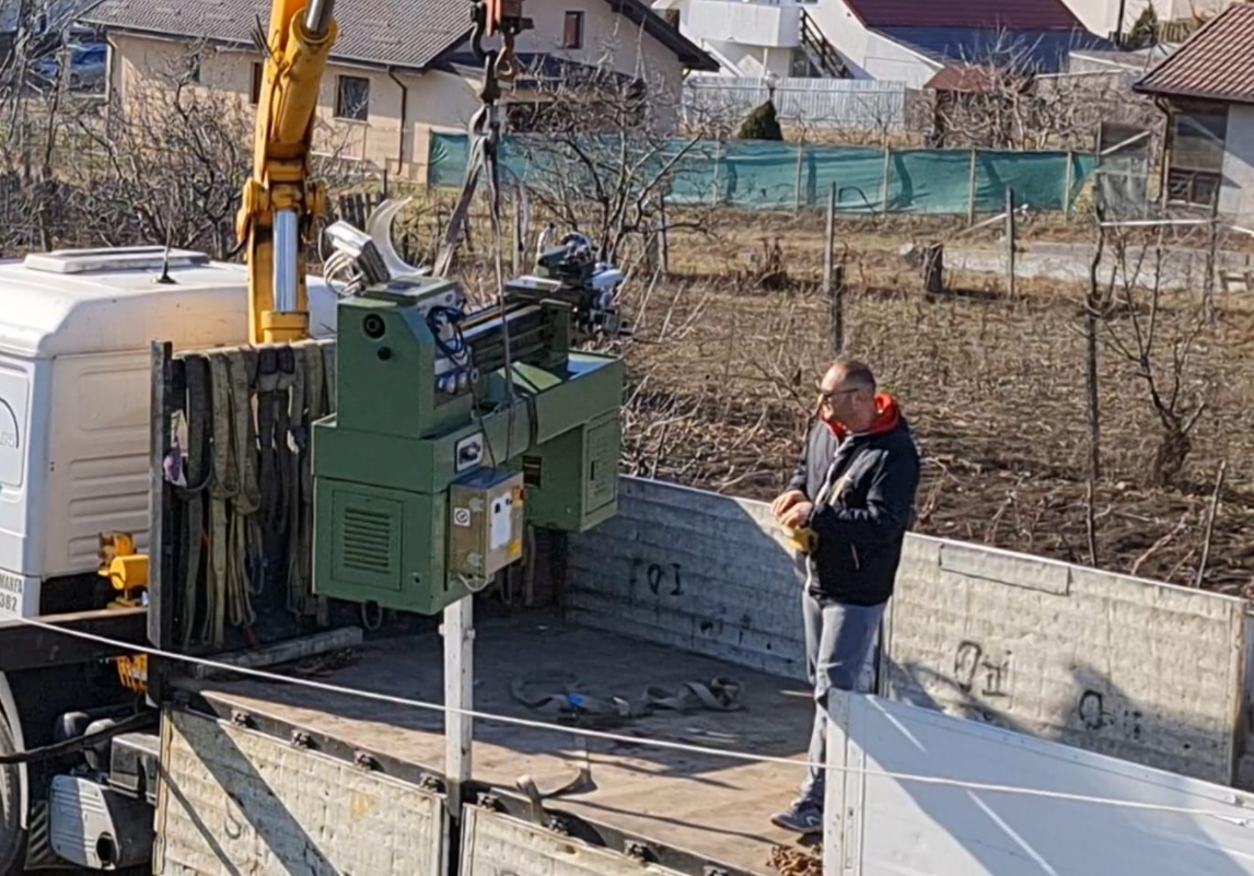

                      Today my lathe arrived. We were able to lift it using 4 ropes without touching the bed or anything important. It was placed on 2 pallets and then moved into the garage with 2 pallet trucks. I need to buy a thick rubber carpet to replace the pallets. Here the truck driver was playing with his remote control:

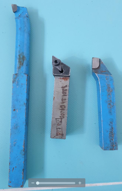

                      Just before leaving the seller added also these tools

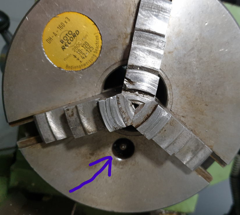

                                It was abused a little. Here are some high resolution pictures: Front table Chuck
                                And in the main gear box there is metallic dust (top right): Gear box
                                By the way, what is the purpose of that hole in the chuck?

                                        The hole in the front of the chuck body maybe an oiler. Shame about the front of the jaws, I would carefully face them back using a carbide tool, and reshamfer them. Do you have the outside jaw set?

                                              I cleaned that hole in the chuck and indeed it is for oil:
