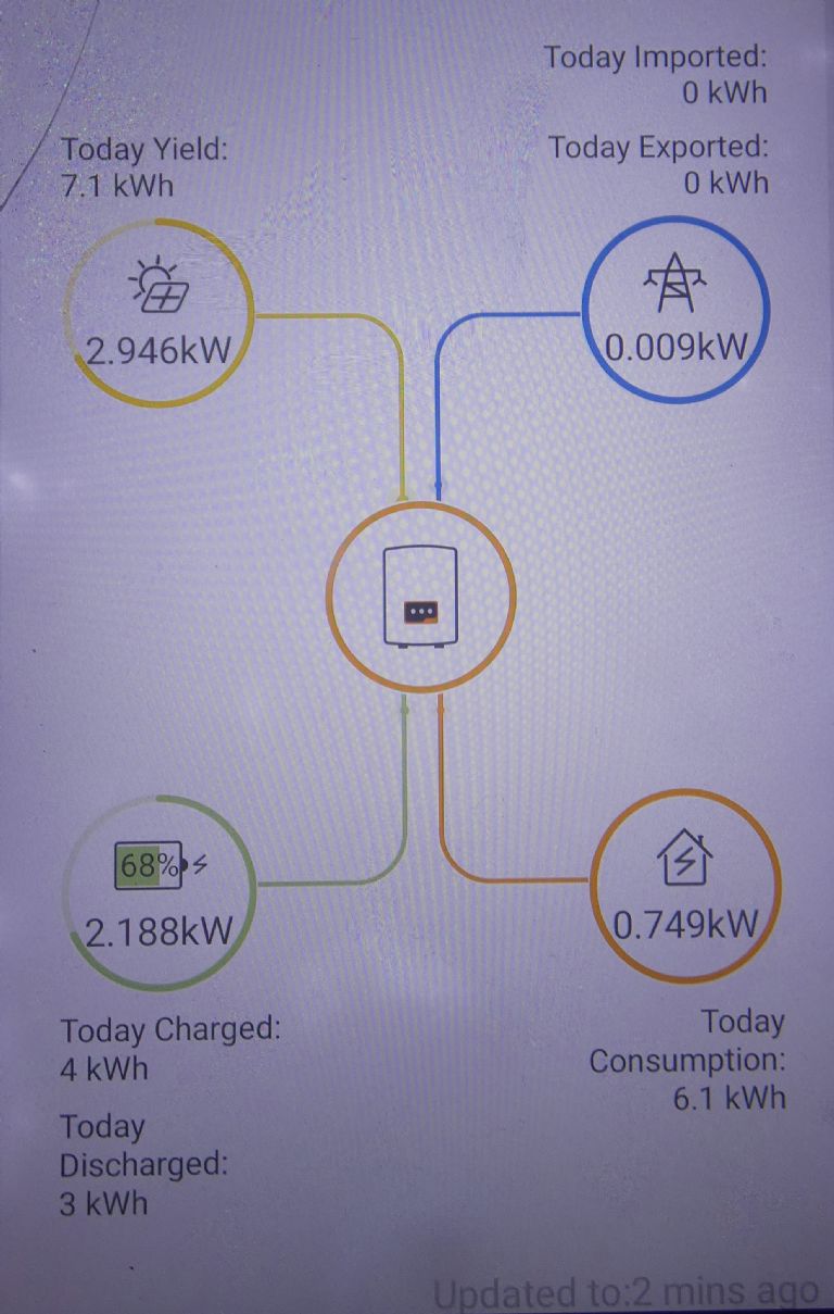

        I don’t know whether this will help or not, Maurice … My brother has a system notionally specified at 4.44 kW and it has a Kodak branded battery with a capacity of 5.12 kWh, and a reasonably fancy controller.
        The snapshot that he sent me recently [from North West England] showed this :
        Which tells me that he purchased no electricity that day, and exported too little to mention.
        What that would mean to any of us, in our own personal circumstances, is for us to work-out.
