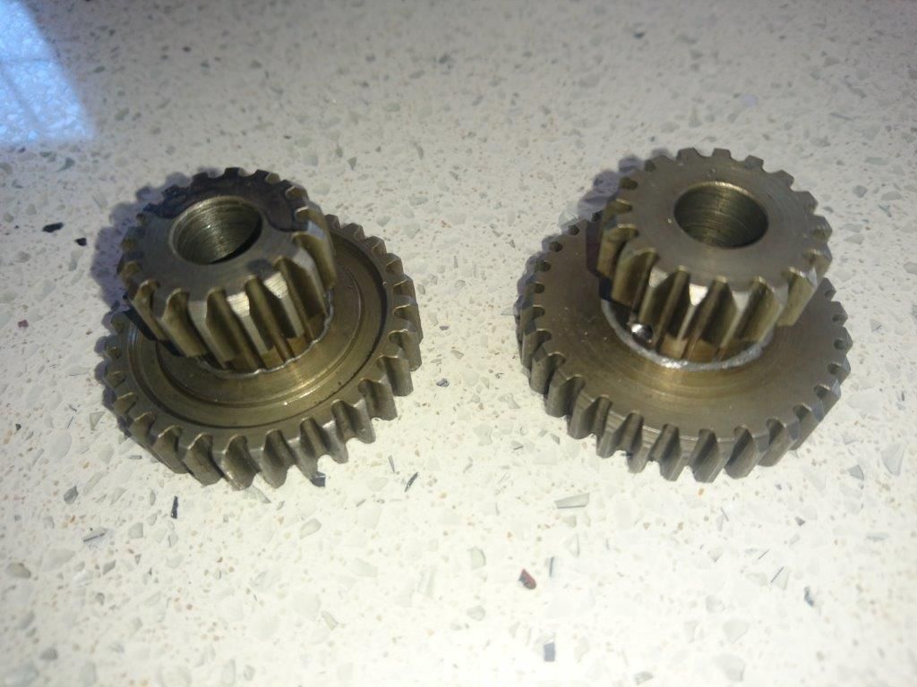

              Having recently fitted a Mk1 gearbox to my S7, I’m now looking for a suitable gear to allow me to cut occasional metric threads. I believe that a 17/30 tooth compound gear is required, but not available commercially. I see that at least one poster (Simon Williams) possibly had a source of this particular gear. Can anyone point me in the direction of a likely source please? TIA
              #599808
              Pete Rimmer
                @peterimmer30576
                One reason why a 17/34 might be hard to find is the 17t gear minor diameter is going to be very close to the hole size for a standard pin it might even be smaller. I can't check it out right now until I get home. You might be better off going with a 34/60 pairing which is the same ratio but a much stronger gear.
                #599904
                Simon Williams 3
                  @simonwilliams3
                  My "source" is making them myself. If you're interested drop me a PM and I'll explain further.
                  For the record here's a picture of the last batch I made
                  The one on the right is the 17/30 tooth pair.
                  HTH Simon
