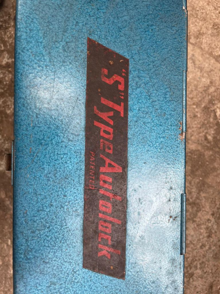

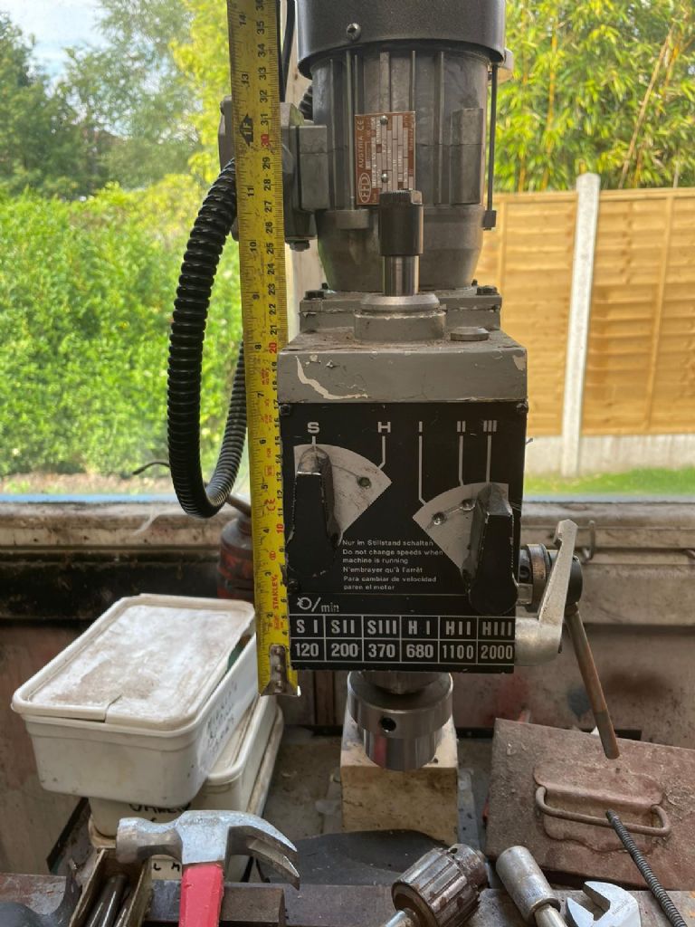

      Hi,
      I am stuck at the first hurdle, the drawbar won't screw into the internal thread so im assuming its damaged and needs to be re-tapped. I have no idea what how the spindle/chuck/draw bar interface with one another.
      There is currently an "s" Type autolock in the machine which i can't remove, but i don't know how it fits into the machine whether its by taper or screwed.
      I've madfe an album but will try and attach some images when i can figure out how, if someone can assist it would be appreciated!

          top of spindle.jpeggeneral mill.jpegautolock.jpegSee below the images, which will hopefully help get some answers!

                                            Michael, the Emco has a self ejecting mechanism for the MT2 tooling, it uses the draw bar and the small cap in photo 1. The draw bars are Allen screws and with the black cap in place you unscrew the draw bar until it comes to the black cap then continue to eject the taper.
                                            I appreciate you say the thread is damaged so maybe you cannot use this method, however the type of Clarkson chuck you have has a stabilising collar that is threaded onto to body of the chuck, during use it should be snugged up to the spindle face. You MAY be able to use this feature to release your chuck by using a spanner [supplied with the machines] on the 2 flats on the spindle and a tommy bar in the Clarkson chuck collar it will hopefully eject the chuck — put something under it to stop it dropping onto you mill table !!

                                              Looking at the gap in the photo, and knowing that the ring can be screwed up and down, I would try a pair of motorcycle tyre levers. A block of wood placed underneath to limit the sudden movement to about 1/2" when the taper breaks would prevent any damage. The thread seems like being a choice of 10mm and 3/8 Whitworth. Tom Senior mills with MT2 definitely used 3/8W.
