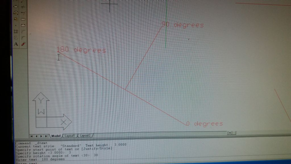

      Hi
      I am trying to draw a line 70mm long going down at 30 degress from the horizontal by using the command @70<30. The line is 70 long but always goes horizontal and to the right so it seems as though my zero degrees direction is going off at about the 4 o'clock position.
      Does anyone know how to set the zero degrees into a horizontal position or even straight up?
      Thanks

          Buffer
            @buffer
            Nigel
            Hopefully this photo will explain it better.
            It seems as though the angles are all rotated clockwise by about 30 degrees and I dont know how to set zero degrees horizontal? Thanks Rich

                Buffer
                  @buffer
                  I have found it now. Its in Format/Units/Drawing Units/Direction Control.
                  Thanks for the reply.
                  Rich

                  Robin King
                    @robinking15611
                    Richard,
                    My knowledge is of AutoCAD LT but I suspect that the basics are identical to your package so here's a suggestion.
                    On the toolbar at top of the screen click on 'Format' then 'Units' which brings up the 'Drawing Units' table. At the bottom is a button 'Direction' which brings up the 'Direction Control' panel. This sets up the degrees zero point, and usually shows the 'East' button lit up which sets zero at the 3 o'clock position – the ACAD default. You can change that to suit your own needs by selecting the 'Other' button but I'd suggest leaving it at East for now. Bear in mind that in AutoCAD degree entries are default set to work anticlockwise from zero; you can change that to clockwise by going back to the Drawing Units panel where you need to check the box marked 'clockwise', but see my note below as well.
                    It'd be worth running through the above just to confirm that the basic settings are correct.
                    The other question is – which direction do you want your line to go down from your line start point i.e. 30 degrees down from horizontal to the left or 30 degrees down to the right? If the first (with zero degrees at 3 o'clock) I'd be entering '@70<210' i.e 30 degrees beyond 180 degree working anti clockwise, or for the second – '@70<330' i.e. 30 degrees short of the full anti clockwise circle. The latter can also be entered as '@70<-30' – the minus sign reversing the direction of rotation (i.e. clockwise).

                      John Paton 1
                        @johnpaton1
                        I too think it is most likely you have slipped into isometric view as I am sure you would know if you had set the drawing direction up at an angle.
                        From your screen shot I notice in the instruction window that you have the text angle set at 30 degrees also – was that intended? (I usually keep text at zero degrees to make the drawing easy to read)

                            Buffer
                              @buffer
                              Thanks for the help as Robin said it was direction control somehow had 330 in it and not 0.
