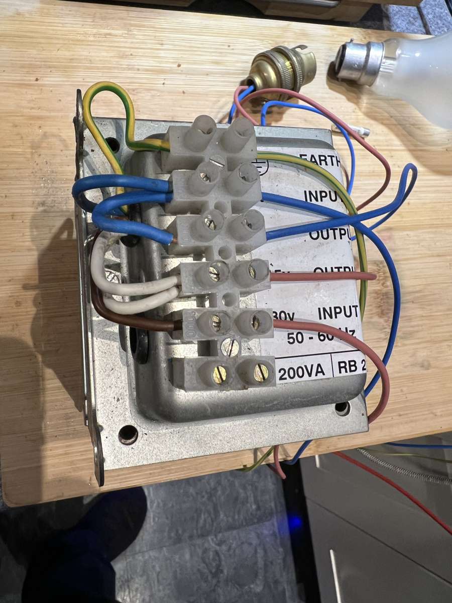

            Ian Parkin
              @ianparkin39383

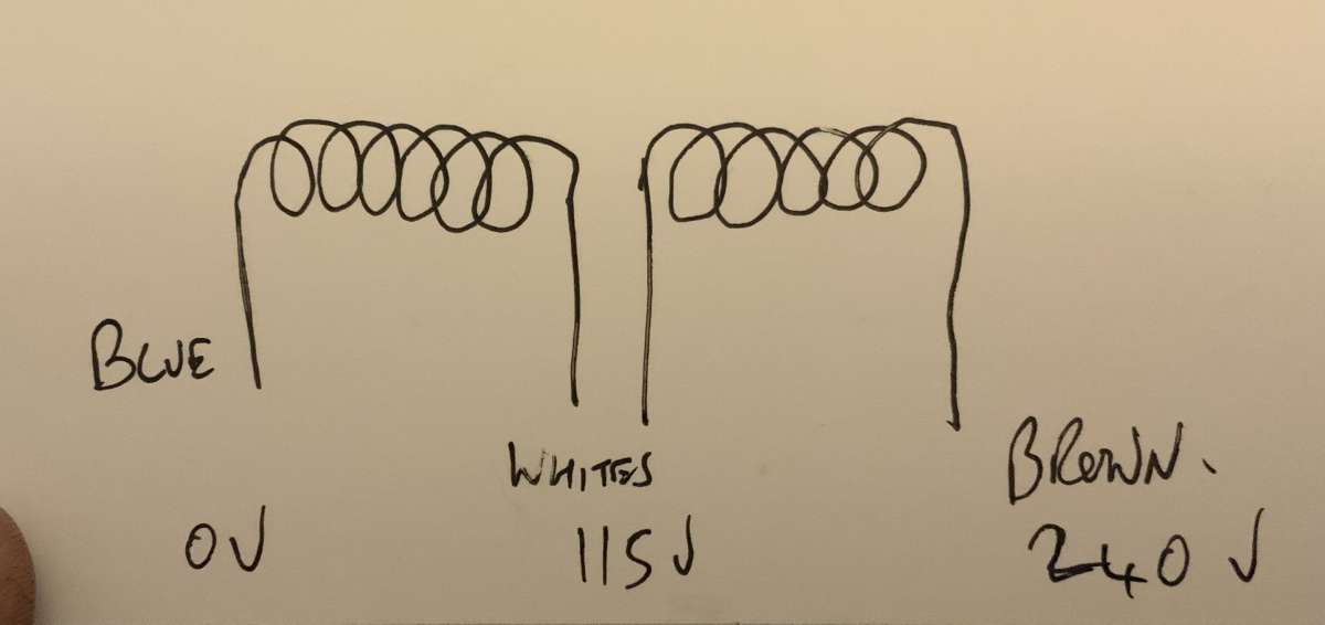

              IMG_5221Well success
              there must have been a loop or wire between the 2 0v’s on the terminal block
              so neutrals to blue 240v to brown
              join the whites together and thats the 110v out

                      Ian Parkin
                        @ianparkin39383
                        This is how it’s wired now. Would you say this is wrong?IMG_2109
                        #712874
                        Ian Parkin
                          @ianparkin39383
                          So 240 in to blue (0v) and brown (240v)
                          and 115 out from blue (0v) and the pair of whites

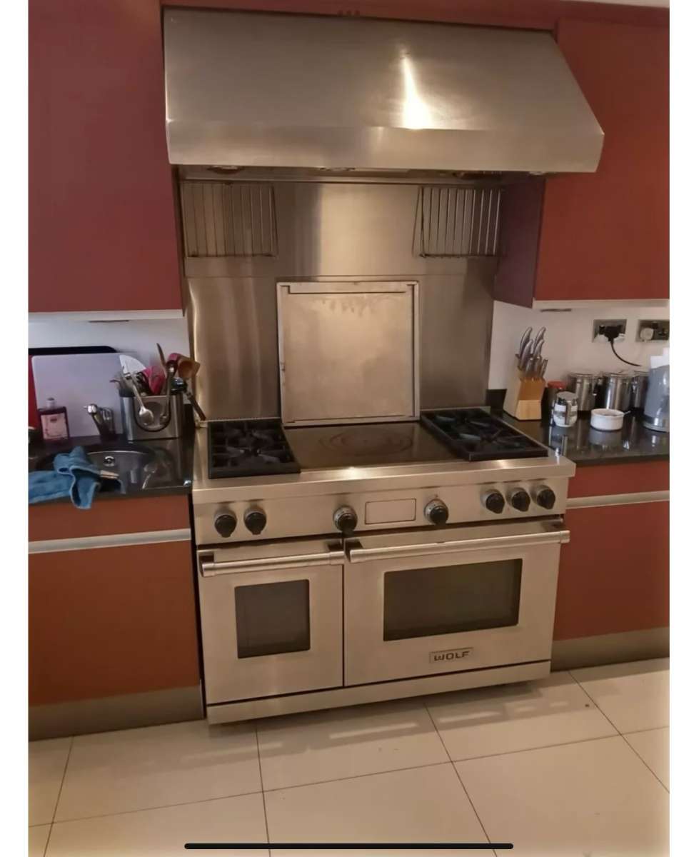

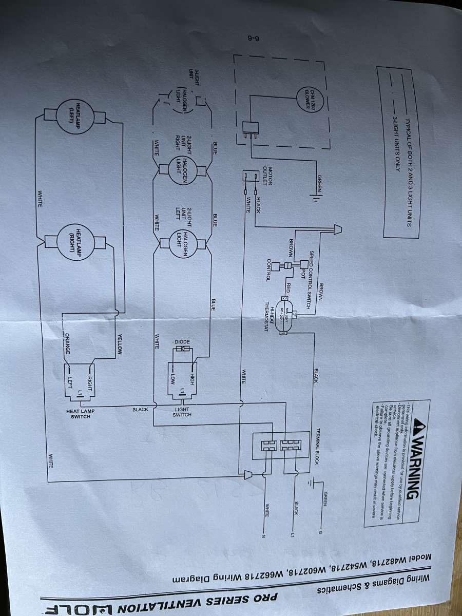

                                    the whole hood is 115v
                                    so I’m sure the transformer was wired into the supply..it has a great big fan 2 heat lamps @250 watts each and 3 tungsten spots. @ 50 watts each
                                    so the transformer is supplying quite a load if everything’s on
                                    i dont want to leave the transformer on all the time and again don’t want to rely on someone switching it off hence my idea of a timed contactor.
                                    heres the diagram for the hoodIMG_5227IMG_5226

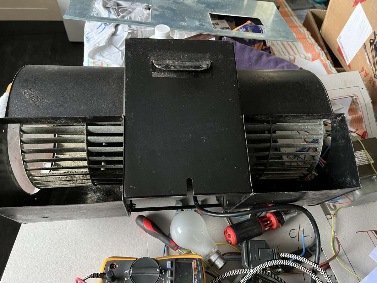

                                      #713118
                                      Nicholas Farr
                                        @nicholasfarr14254
                                        Hi Ian, one thing I’ve noticed in your photo above, is the fan blades look as if they have a layer of crud built up on them, this reduces the efficiency of them, and should really be cleaned off, and of course, they will draw a little more power with the extra weight.
                                        Regards Nick.

                                          On Martin Connelly Said:
                                          If you wire it up so one/some of the lights is/are on whenever there is power to the transformer it will encourage people to switch it off when not in use.
                                          Martin C
                                          Looking at the circuit diagram, I think it already has that feature.  (Possibly not if they are 3-position switches, centre OFF.)  On the face of it, one switch selects either the right or left heating lamp, so one of them is always on.  And the Halogen lamps are always on, except operating the switch puts a diode in circuit, so the lamps run dim at half-power.
                                          Otherwise, the circuit doesn’t help Ian much because it doesn’t show how the unit is normally connected to the mains.
                                          Judging by the size of the hood, it’s meant for a seriously big kitchen, perhaps a restaurant, and normally part of a planned installation with a dedicated switch-board and distribution system.   The hood might simply be switched on and off with all the other cookers when the restaurant opens and closes.   Not rocket science, but could be a bit more complicated than just plugging it into a socket.
                                          Seems a couple of notches more difficult than fitting an ordinary domestic cooker hood.  Doesn’t help that it’s a US unit with 115V 60Hz internals, needing that transformer AND making replacement bulbs mildly painful to source.
                                          Anyway, I recommend Ian asks the owner what he needs the hood to do.  When is it on, when is it off, and does the way the owner intends to use it require anything more complicated than an on/off switch?  Designing the controls after nailing the requirement avoids discovering flaws in the real word by burning the house down or getting a massive surprise electricity bill!
                                          The cut wires are an alarm.  One reason is that the deinstaller rushed the job and didn’t care because it was going in a skip or because there was a commercial objection to the item being sold second-hand.  That’s OK.   But a major reason wires are cut like that is to stop the item being re-used because it’s faulty or unsafe;  I’d think about that possibility because the installer is held responsible if it goes wrong.

                                            Your transformer is not big enough to supply the lights in that hood.
                                            It needs significant work to use on 240V
                                            It also has a “speed control” for the fan which is another worry on 50Hz.

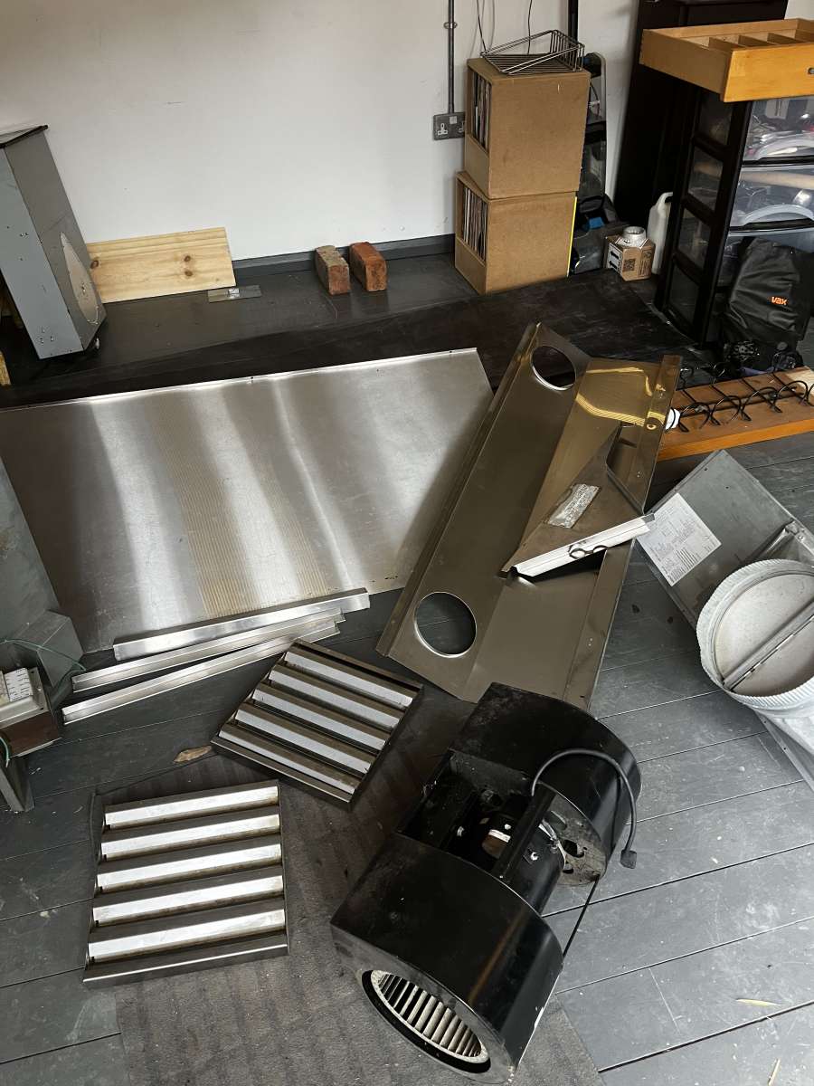

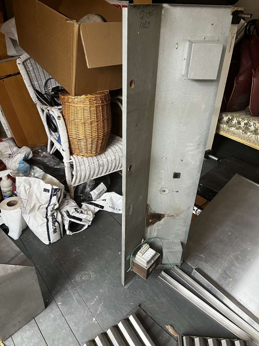

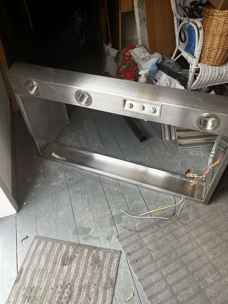

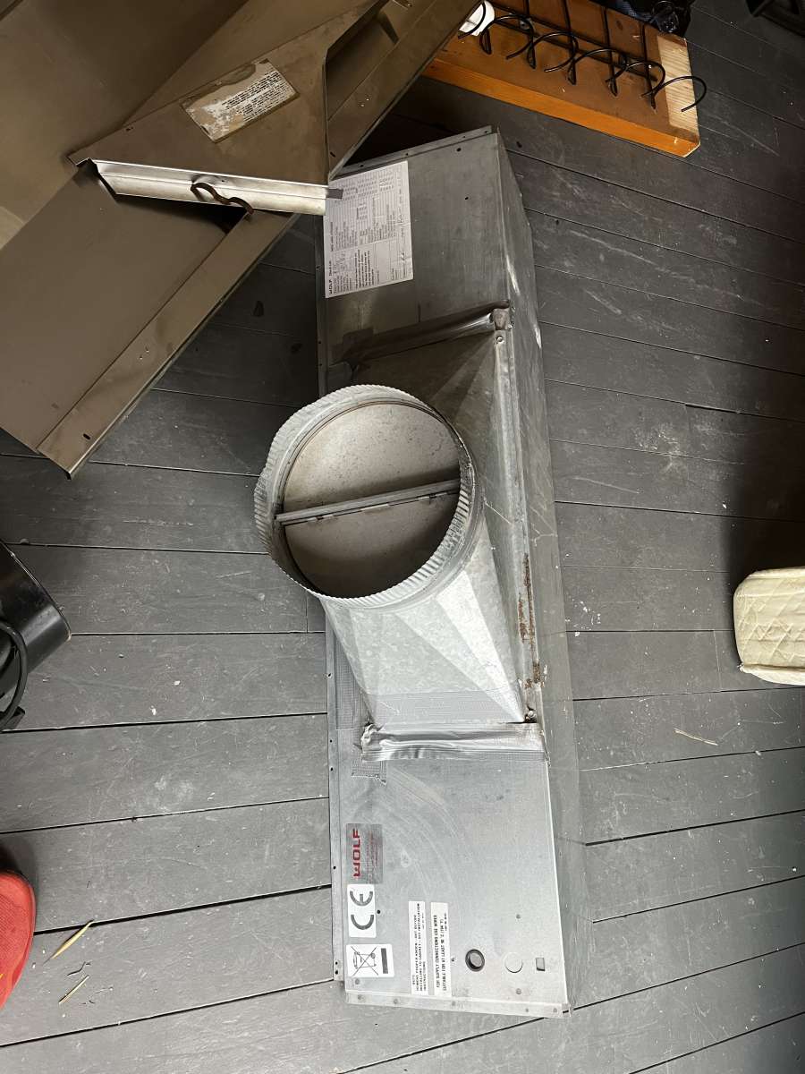

                                                Ian Parkin
                                                  @ianparkin39383

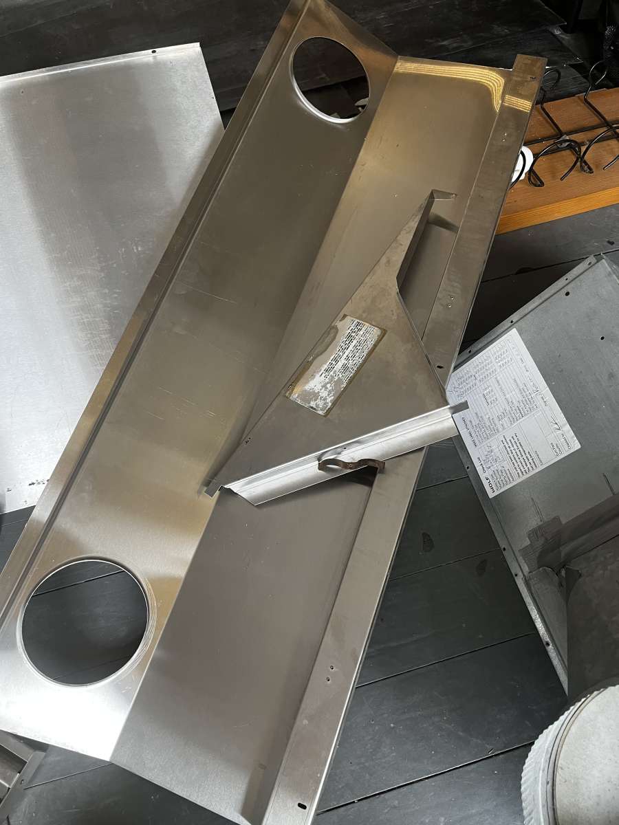

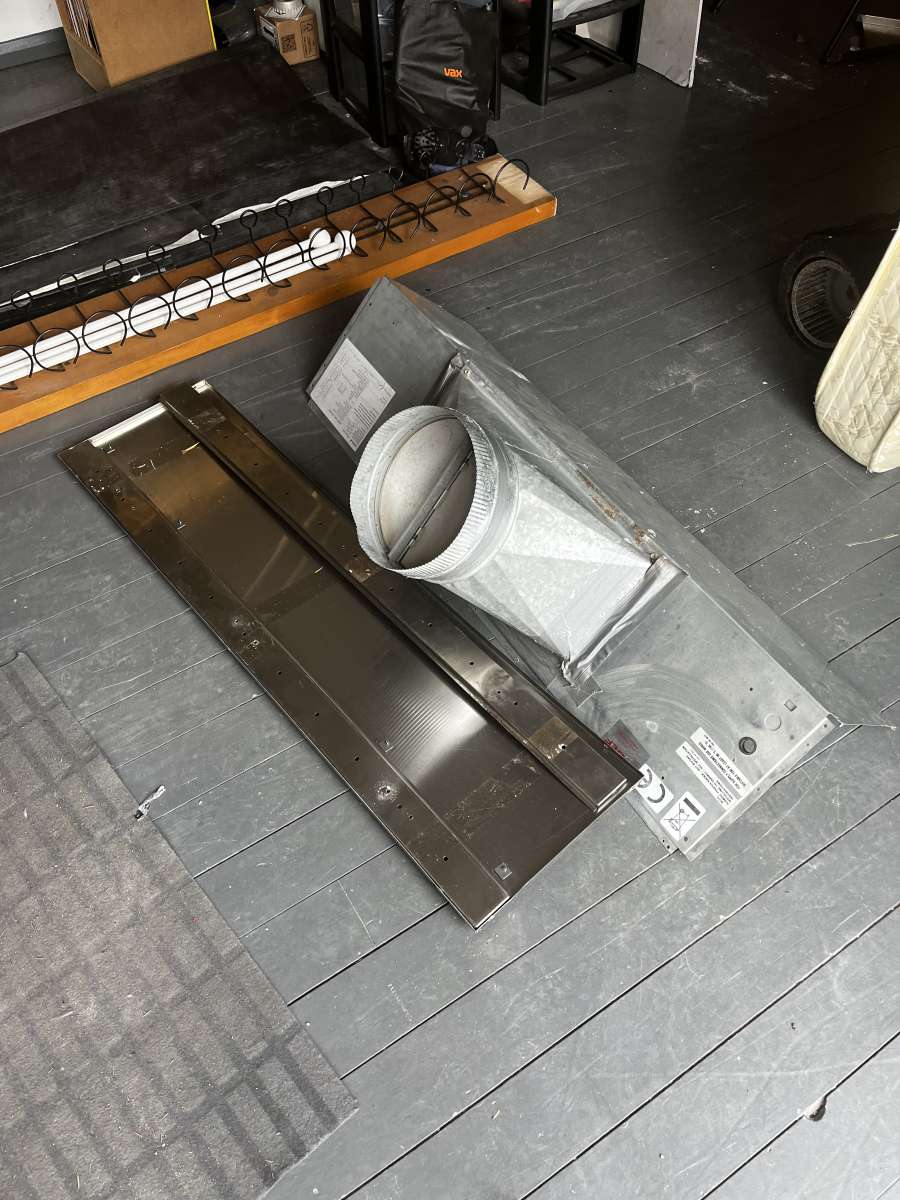

                                                  It came from a domestic installation sold on eBay as a freeby with the range the uninstaller i assume had a right job taking this hood apart hence the cut wires and missing screws
                                                  i’m guessing its 60 kg in all
                                                  heres as it was in situ at previous owners
                                                  IMG_0292
                                                  The transformer is rated at 1200VA so what can it supply at 115v
                                                  the motor and bulbs are all controlled by dimmer type switches the diagram suggests switches..
                                                  i agree bulbs will be hard to get but they are available online..i could rewire to 240v..
                                                  this is what i started with
                                                  IMG_6477IMG_6476IMG_6478IMG_6479IMG_6480IMG_6481
